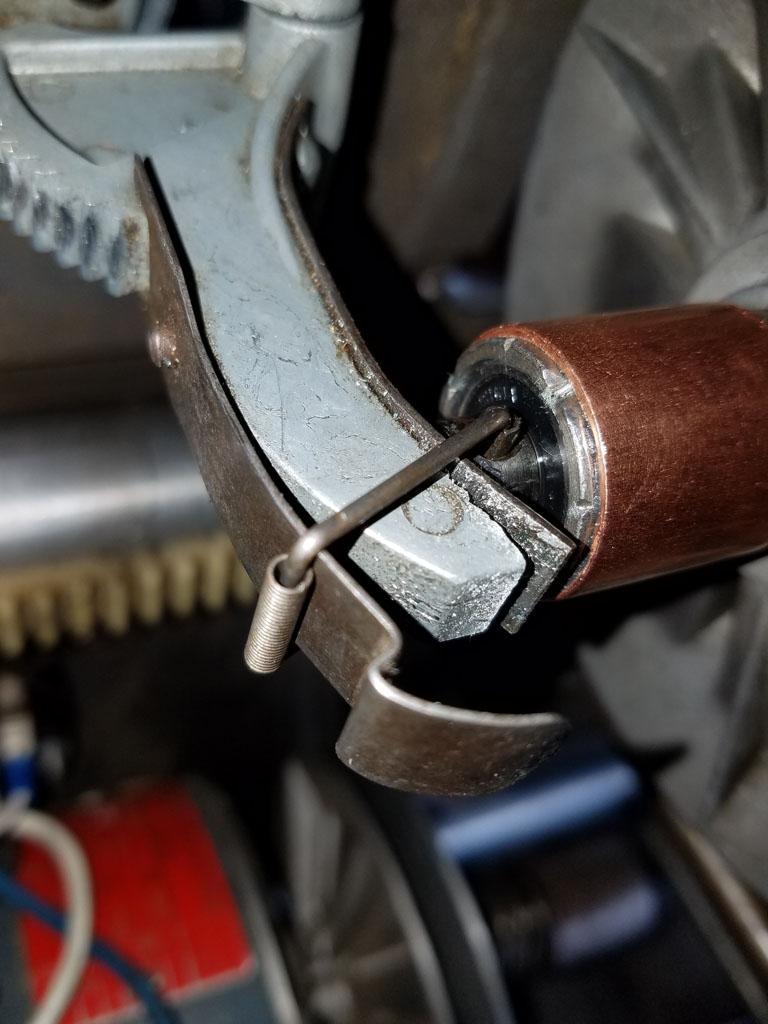

That's awesome! I just might take you up on your offer! However, I need to finalize the length that it needs to be extended before I can move forward with it.
EDIT:
Figured it out. The button rides on the end of the quadrant assembly on my setup. The end of the quadrant assembly has a wider travel arc, so it's causing the control sheave to travel MUCH further than it would if it was in the correct position. This can be fixed by using my previous idea of setting the max speed set screw. I believe this will completely fix the problem. However, it will also make the speed dial useless. I guess that's not that big of deal since I have a tachometer.

The total travel my control sheave moves is about 1 3/8". When I lined up the control sheave above the fixed fan sheave it looked to be about 3/4" away from the idler sheave. Assuming it's somewhere between the 3/4" I measured, and the 1" you measured my MV speed control is pulling the control sheave about 1/2-3/4" too far.
When I only allow the control sheave to be pulled out that far it slides back in easily. It's only when I let the control sheave be pulled out too far that it binds up.

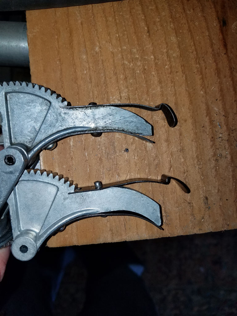

I examined how everything works together some more today. Knowing now that the MV speed control is pulling the control sheave out too far I don't believe the 'snout' needs to be extended at all. I think leaving it alone is the best option.
However, I do believe the quadrant assembly might need to be modified slightly for the best fit. It seems to work just fine as is, but I believe it could be causing some lateral pressure on the control sheave. This pressure might, or might not, cause some premature wear on the control sheave. I think a minor change to the quadrant assembly would allow it to push straight onto the control sheave and fix this completely. I haven't done the modification yet, but I should have time this weekend to give it a try. I have a junk quadrant assembly that will be perfect to use as a test piece.
Here is my photoshopped mock up of what I believe needs to be done. This shouldn't be too hard to do. Just hacksaw the tip off, and bend the thin metal guard back.
n240sxle91
Posts: 120
Joined: Sun Jun 19, 2016 11:29 pm
Location: Southern Minnesota
Re: Shopsmith Mark VII with Mark V speed control
Post by n240sxle91 »
Ok, I did the mod on my junk quadrant assembly. It looks like it helps a lot! The button on the end of the 'snout' lines up much better now. It's not the same as it would be on a MV, but it's better than it was. I think this will be all that is needed to make the conversion possible. I'm very happy with the way it looks/fits now.
The top one is the modified quadrant, and the bottom one is the stock one. Notice the angle at the end of the quadrant. The modified one doesn't arc as much.
