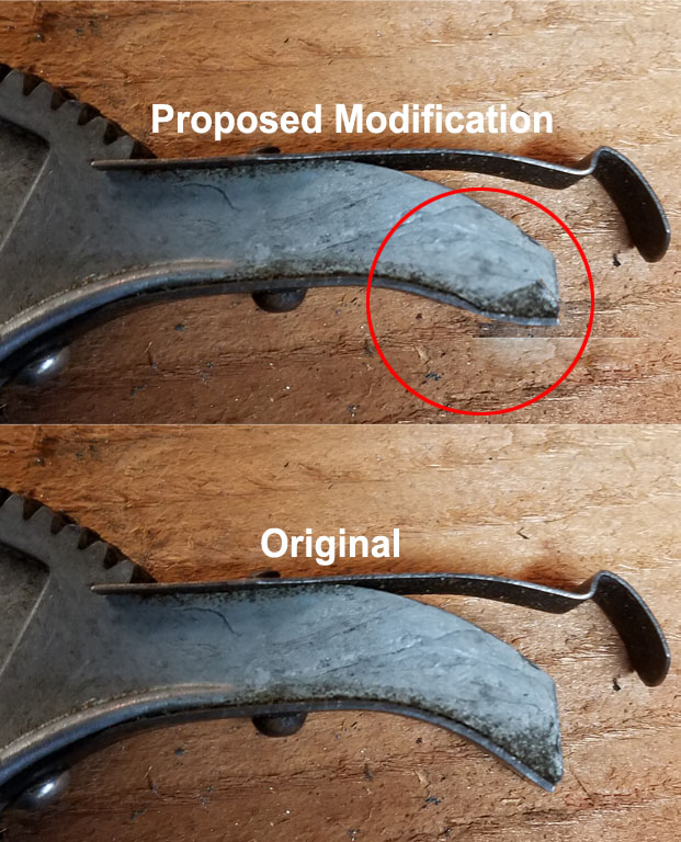

I examined how everything works together some more today. Knowing now that the MV speed control is pulling the control sheave out too far I don't believe the 'snout' needs to be extended at all. I think leaving it alone is the best option.
However, I do believe the quadrant assembly might need to be modified slightly for the best fit. It seems to work just fine as is, but I believe it could be causing some lateral pressure on the control sheave. This pressure might, or might not, cause some premature wear on the control sheave. I think a minor change to the quadrant assembly would allow it to push straight onto the control sheave and fix this completely. I haven't done the modification yet, but I should have time this weekend to give it a try. I have a junk quadrant assembly that will be perfect to use as a test piece.
Here is my photoshopped mock up of what I believe needs to be done. This shouldn't be too hard to do. Just hacksaw the tip off, and bend the thin metal guard back.

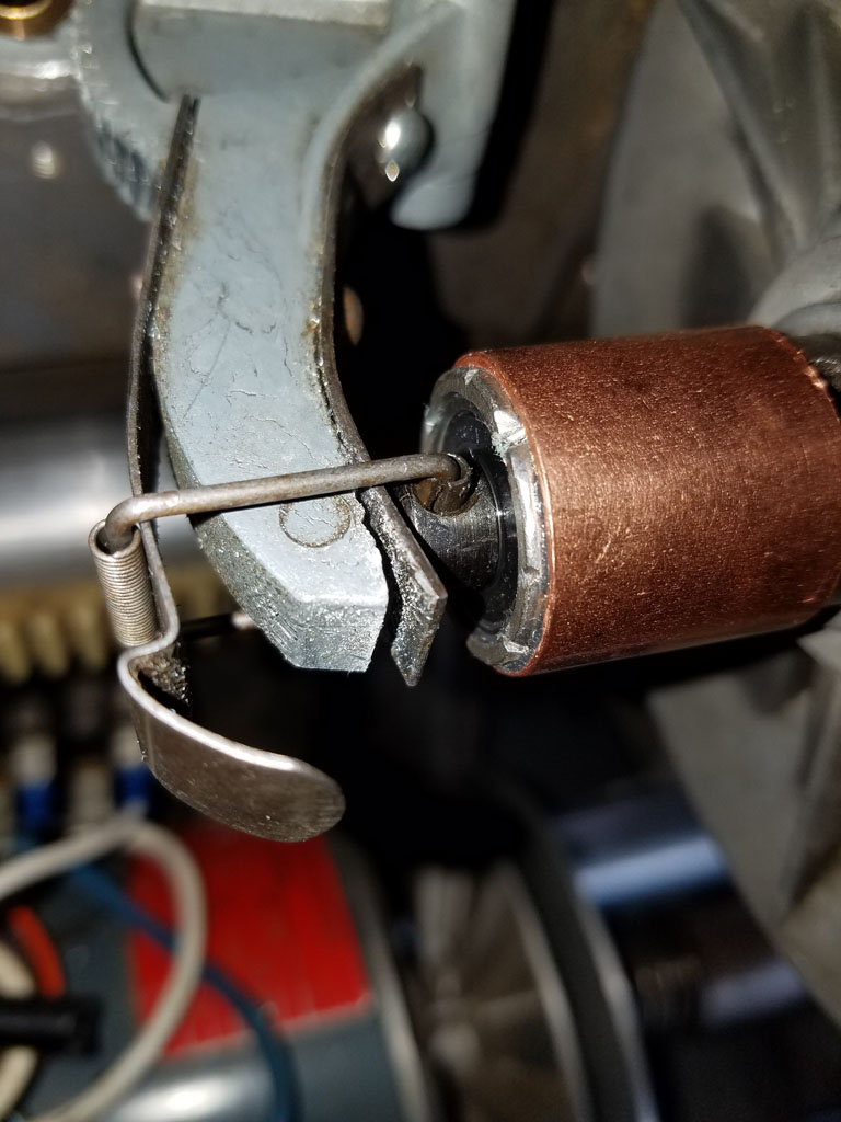

Ok, I did the mod on my junk quadrant assembly. It looks like it helps a lot! The button on the end of the 'snout' lines up much better now. It's not the same as it would be on a MV, but it's better than it was. I think this will be all that is needed to make the conversion possible. I'm very happy with the way it looks/fits now.
The top one is the modified quadrant, and the bottom one is the stock one. Notice the angle at the end of the quadrant. The modified one doesn't arc as much.
