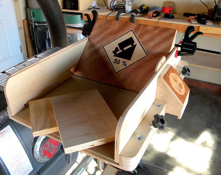

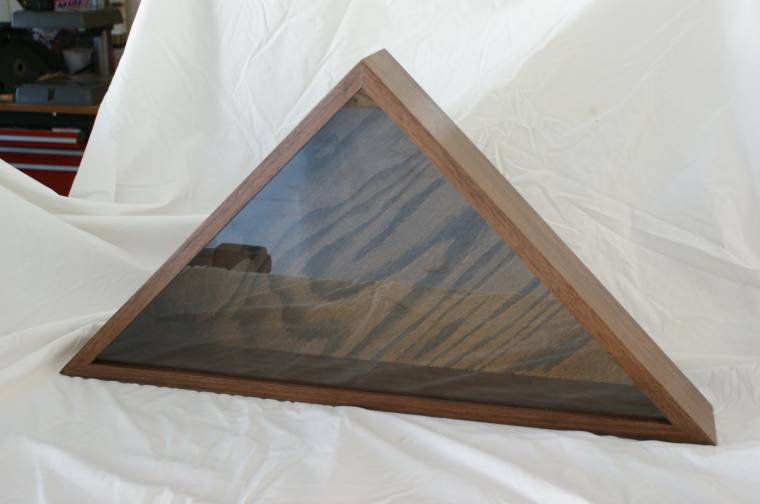

I have done some 22.5 deg cuts on the table saw but not 45 as yet.
I used the following jig that rides on the fence. I think that it would work OK as long as the pieces are not too long or heavy. The bottom joints were cut using this jig. The topangle was cut on a miter saw.
Bill V
saddle fixture.jpg (93.86 KiB) Viewed 8424 times
walnut flag case.jpg (80.48 KiB) Viewed 8424 times

Thanks, guys for all your comments and suggestions.
The project is a rifle case. A prototype has been built and I used a lap joint and dovetail splines. The wood is 5/8" thick.
I could use the track saw as Ed and Ben suggested. Then, if tweaking at the disk sander was necessary, I think that would be easier than trying to saw it at the table.
I'll do some fiddling and let y'all know how it worked.
