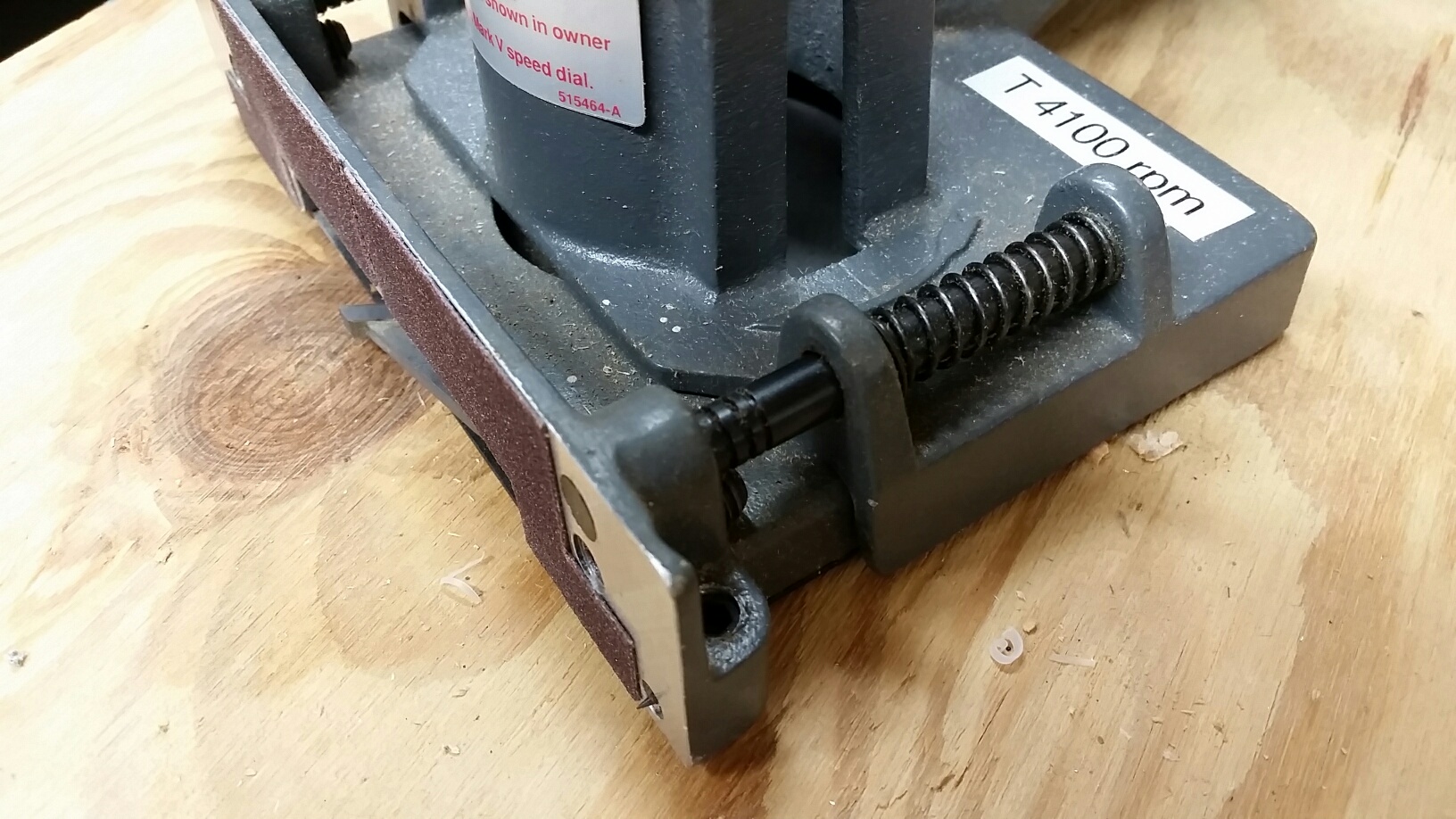

First it would appear that the guide rods are pressed into place. I see no adjustments so good luck with that. They do list those parts as an assemble (515458).
Here is a picture of mine and how the rod ends look:

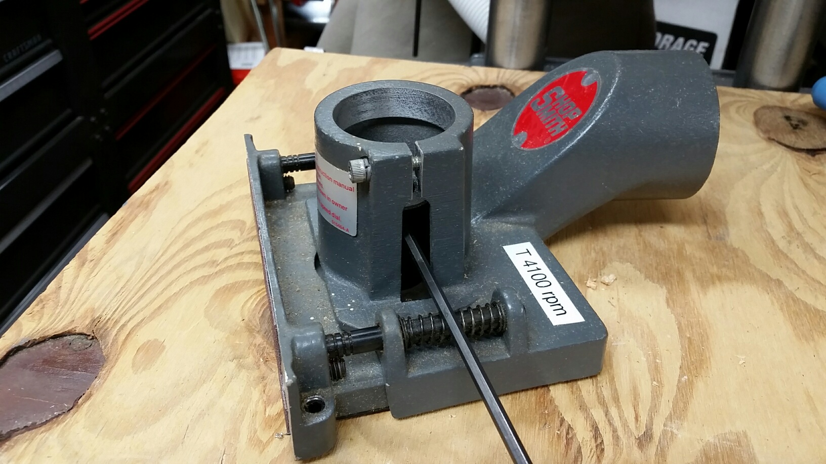

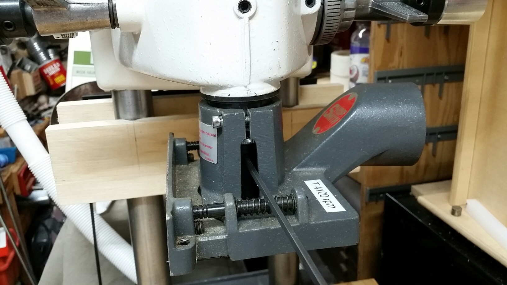

This is how I mount mine, I locate the setscrew and insert the Allen wrench before I attempt to mount it.
Then I locate the taper flat on the quill shaft so I can see it. Then lift into place and push on the blade arbor to lift it so it is fully seated. I tighten the setscrew and then rotate the joiner to how I want to use it and tighten to the quill.
