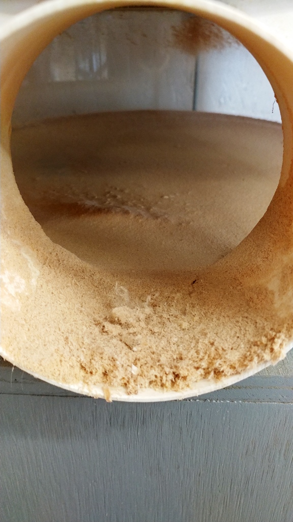

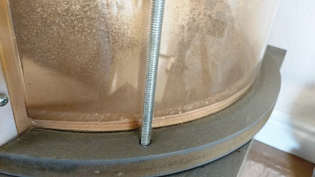

As a testament to the efficiency of a cyclone see the pictures of my Clearvue cyclone. The first pictuer shows the unit just after I installed it. The next two pictures show the cleanout at the bottom of the filters. Those two pictures were taken today 6 1/2+ years of use and it has never been cleaned. Just over 1/8" of dust.

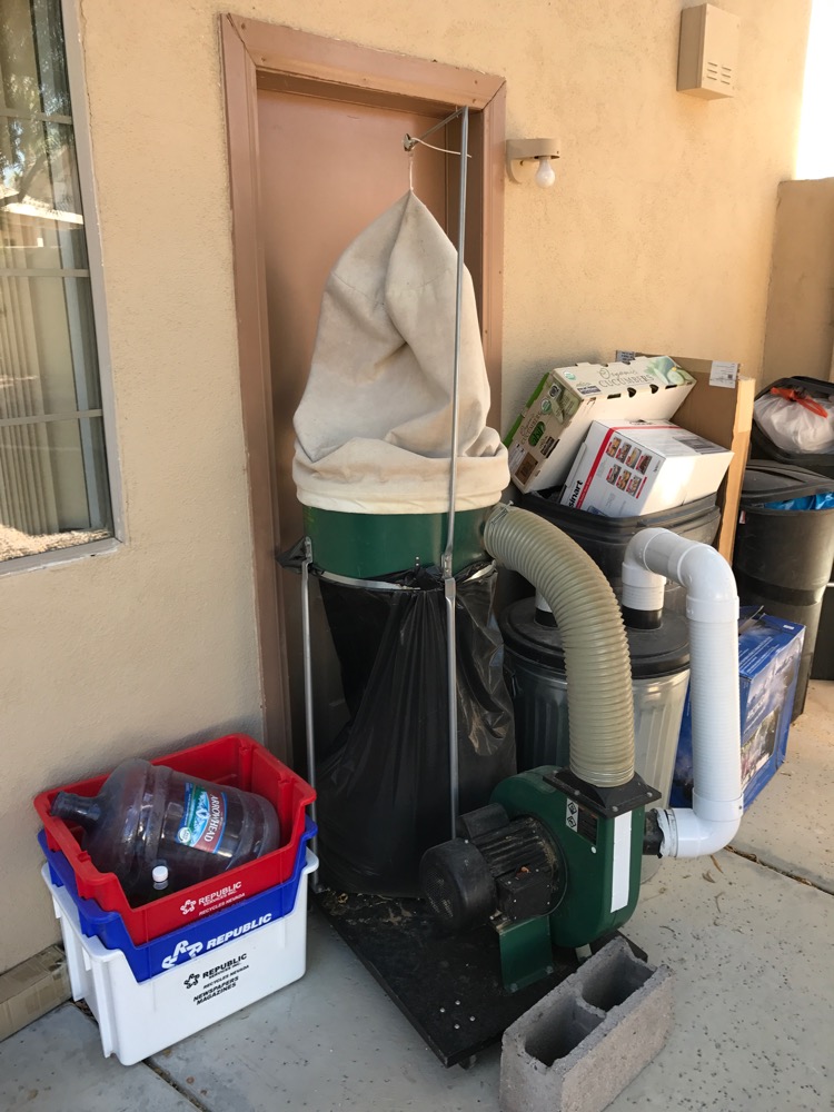

The HF version I have has a metal impeller. I got it off CL for $75 years ago. I use the standard filter bag it came with because mine is outside the shop so I don't care about the particulate. The thing is very reliable. I use the 110 V remote that Rockler and Woodworkers Supply both sell. The nice part is that you can use the heavy duty black trash bags on them which are cheap. I have a separator which is a metal trash can which saves emptying the bag so often. It sits out doors unprotected and seems to be doing fine. I expected the filter bag to deteriorate due to rain and sun in Southern CA and now Las Vegas but it seems to be holding up.
