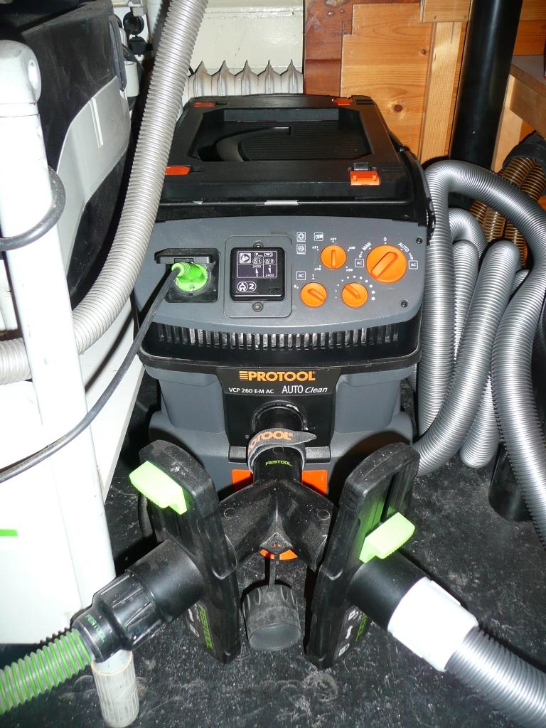

I had one of the HF in another shop several years ago but it had a plastic impeller and didn't last very long. Maybe they are better now. Anyway Baileigh wanted $200.00 shipping on their unit so for me that was a deal breaker. In the end I decided to buy another Festool CT26. I just like the convenience and smaller footprint and I wont have to move anything around to make it work. Im also working on a way to empty the Festool bags into the large JDS unit so that I can get more miles out of my bags. I may look at adding the Dust Deputy to at least one of the CT's depending on how that goes. Thanks for the mention of Wynn Environmental I looked them up and they are a good source of filters for the future. https://wynnenv.com/woodworking-filters/
You definitely should consider the Festool specific Dust Deputy for the CT26. I love mine and there is a negligible decrease in suction force as demonstrated by the New Brit Workshop Fella. You will save a good deal of money in the long run by going with the Dust Deputy setup for the festool extractor.
I actually had the CT 26 originally hooked up to a dust deputy that I had attached to a 15 gallon fiber drum and it eventually collapsed the fiber drum, due to the intense negative suction pressure. That definitely won't happen to the Festool specific Dust deputy setup. It's built like a tank!
How are you attaching the Festool CT26 to your shopsmith tools?
Are you using the 36mm hose or an even larger hose?
Cheers,
John[/quote]
I use the regular 2.5" shopvac hose for the bottom blade guard. For now I am using a 27MM hose on the second unit to my homemade upper blade guard. It works pretty well but the Shark Guard that I have ordered will have a 2.5" dust port. I may reduce it down and use a 36MM hose on it but that decision will have to wait until I receive the unit and play around with it.
Cheers,
John[/quote]

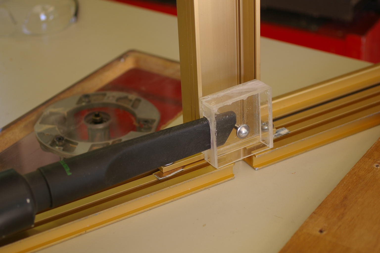

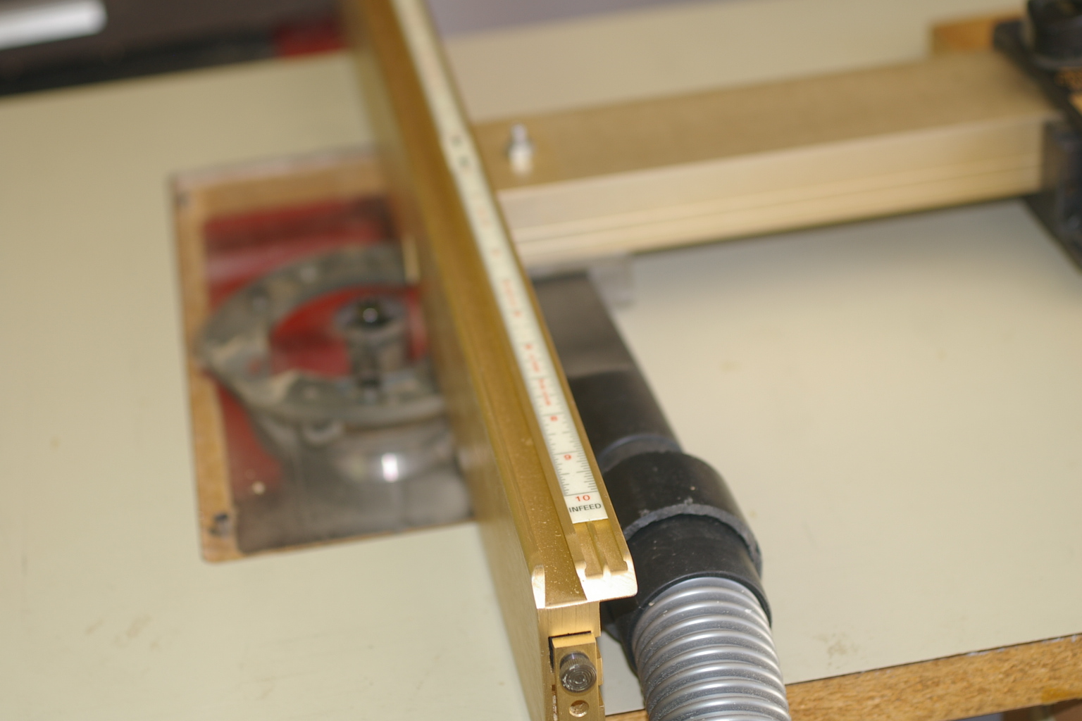

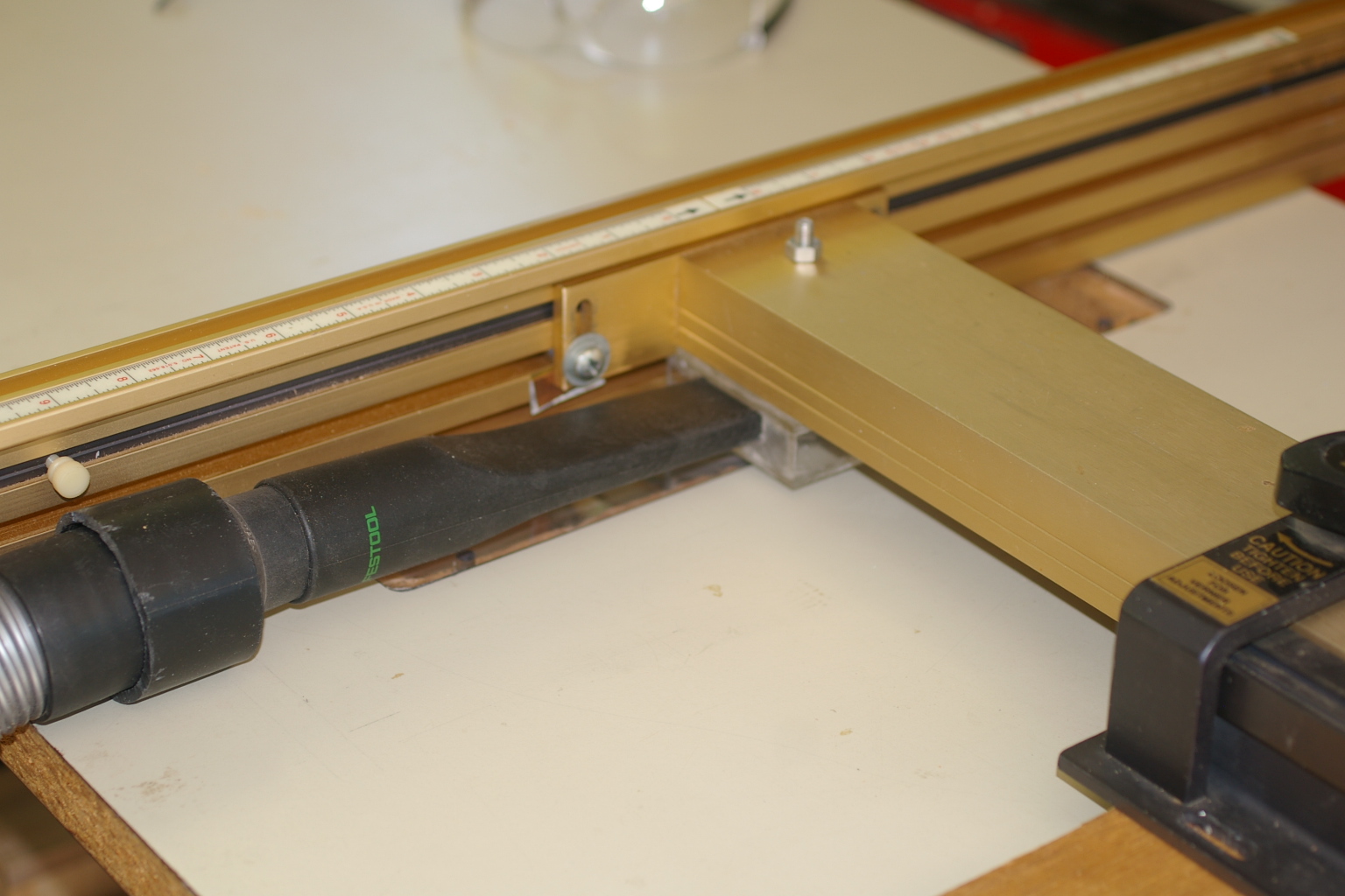

This a little bit off topic but I am going to post it anyway. Since buying the CT-36-E, I have been toying around with options of trying to use it with various tools. The latest one being how to collect chips and dust in my router table when using my IPM and its fence. The little box I made works about 80-90 percent. Better than nothing.
