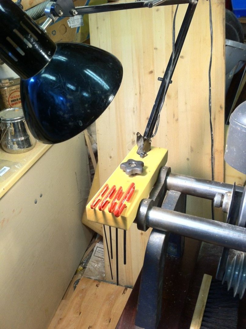

The work light I use on my 10ER did not have a good base and frequently got knocked over.
So yesterday I made a base for it that clamps to the way tubes. Just some scrap wood, a T-bolt and a knob.
Where it is positioned it can also turn the other way and be used for my 10ER drill press.
I had been thinking of this for a while now, glad I finally got 'er done. :) I also added some extra holes to store hex keys.

One more photo to show the bottom of the lower clamp, (I made a recess for the bolt head with a Forstner bit and glued it in with CA glue)
and to correct an 'omission' ;) in the previous photos.

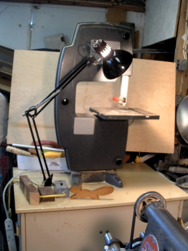

And here is another lamp on my bandsaw, this one mounts on a short piece of 2x4 screwed to the worktop.

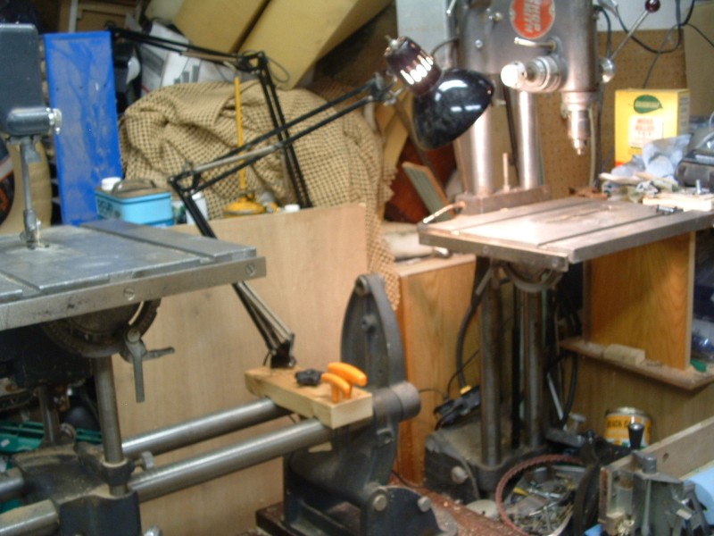

Update, I long since moved this holder to the left end of the way tubes where it didn't get in the way.
Saturday I made a new one to better accommodate all four allen keys that i require. (3/32", 1/8", 5/32", and 3/16") and the hole for the lamp had worn too big.
The lamp has had an upgrade too, I now use LED floodlight bulbs.
I cut the angled notches where it goes over the way-tubes on the 10er, first time making angled cuts with the tilted table, and my miter gauge has the scar to prove it. :o

JPG wrote:Next time, use the 'lower' slot! :D
I used it in the lower slot this time, :) just not for the first cut. :eek: ;)
And then I needed to dig out the wooden extension for the miter gauge to get support where I needed it, but I prevailed. :cool:
