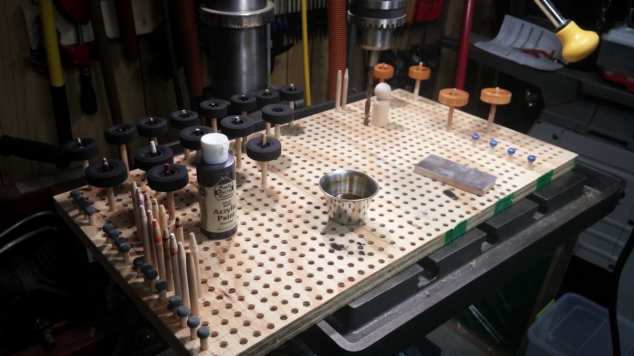

This is what I currently use to hold small parts with wet paint. Whwn actually painting I either hold them by the dowel with my hand. Lately I've been holding the heavy cars with long nose locking pliers because griping the dowel that hard makes my hand cramp. This method allows me hold the body in any position I want amd keep the airbrush level. It works well for brush painting too.
20170305_201114 Paint Stand For Wooden Toy Cars.resized.jpg (311.63 KiB) Viewed 6026 times

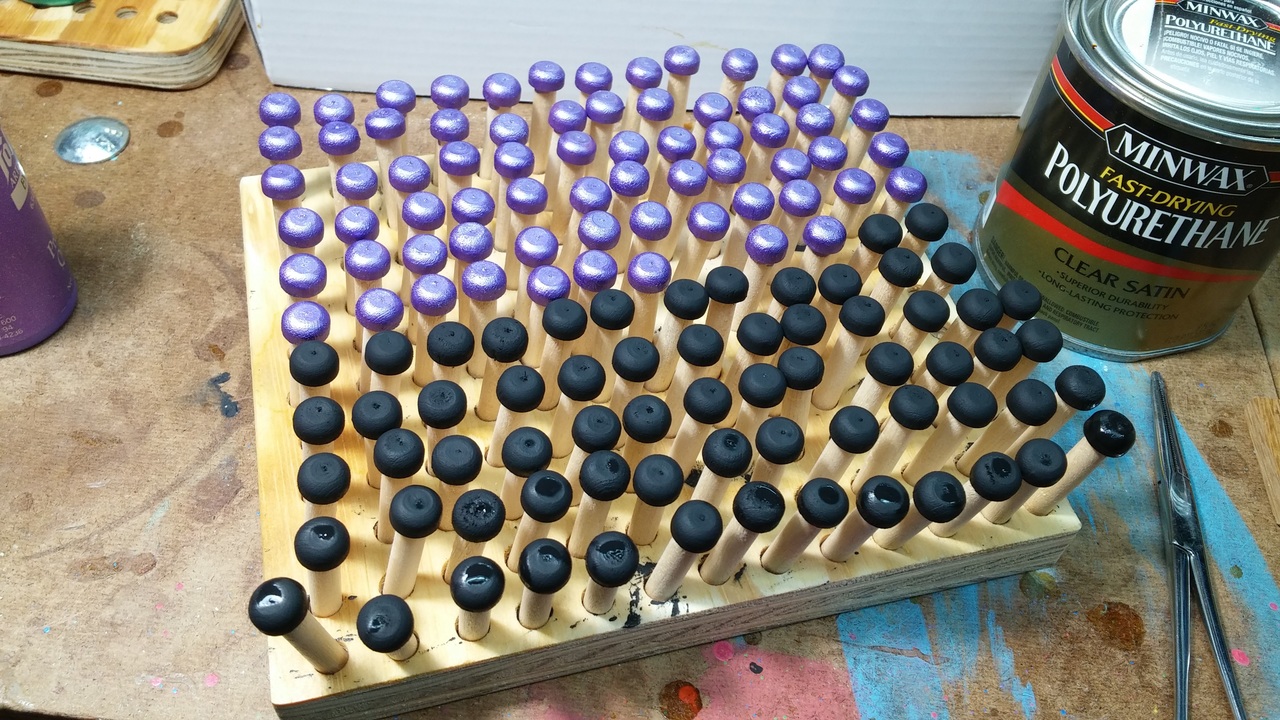

It also works good for smaller parts. Like these axle pegs. O hold these with hemostats while painting.
20170419_213515 - Paint Drying Stand For Wooden Toy Car Axel Pegs.resized.jpg
20170419_213515 - Paint Drying Stand For Wooden Toy Car Axel Pegs.resized.jpg (448.7 KiB) Viewed 6026 times

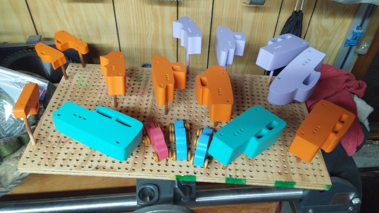

And wheels which is what I originally used it for.
20151217_164419 Painting Wheels For Wooden Toy Cars.resized.jpg (263.47 KiB) Viewed 6026 times
I also made this rotating paint stand that I have never used for that purpose because I soon discovered that I could not paint the entire body at the same time.
