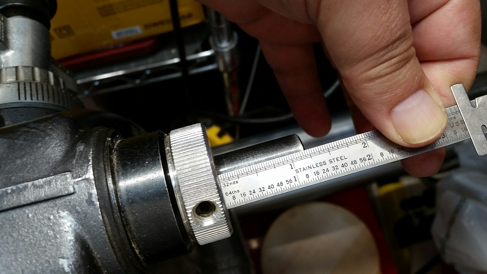

Sometimes a few pictures help. Here is one of the shaft and it should extend just about 1-1/4". If this is shorter then it is possible that the collar was loosened at some point and has moved forward. If this is the case come on back and we can get you back to normal in no time.

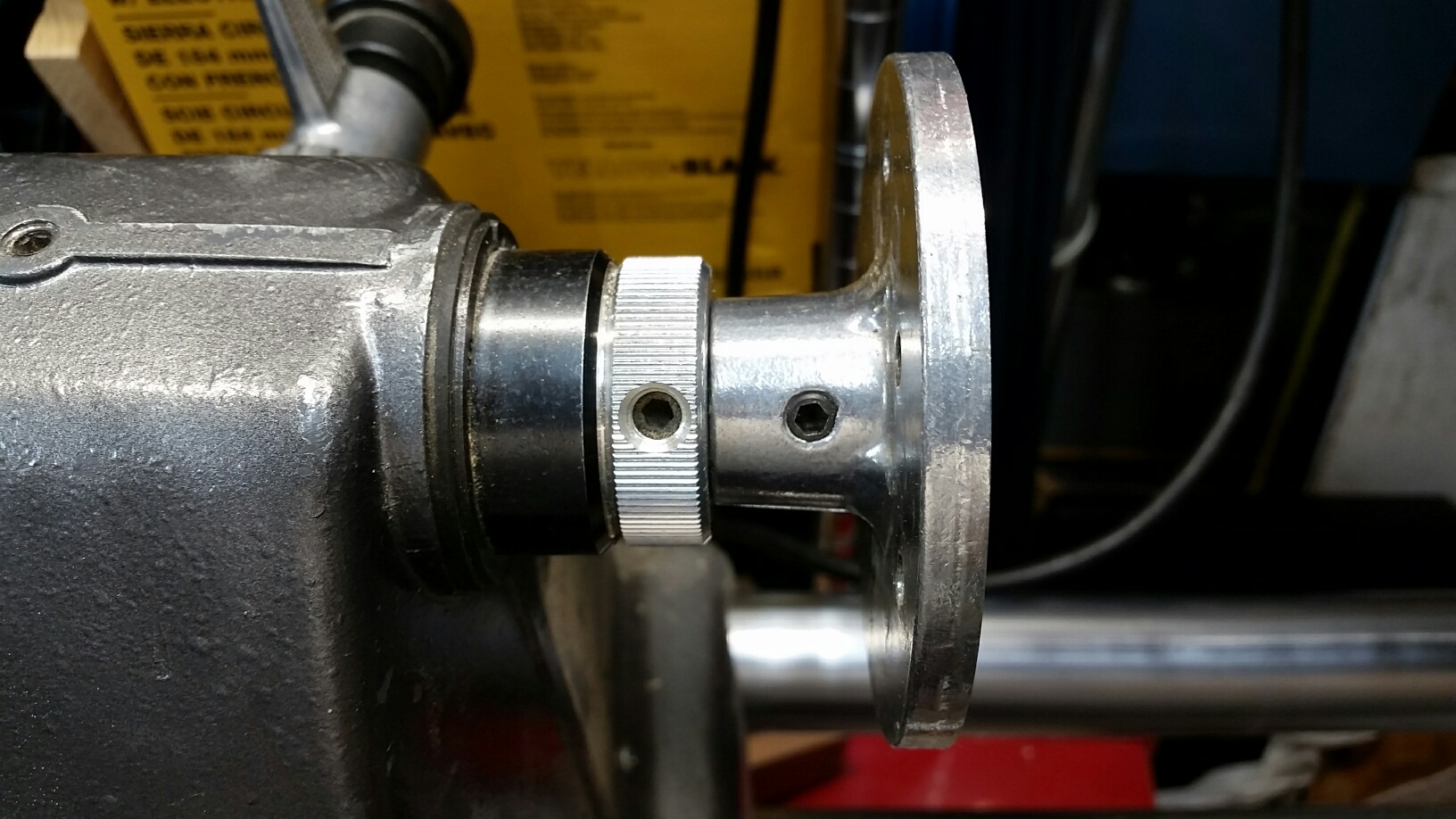

The face plate should fulling fit on, right up to the collar as shown here:

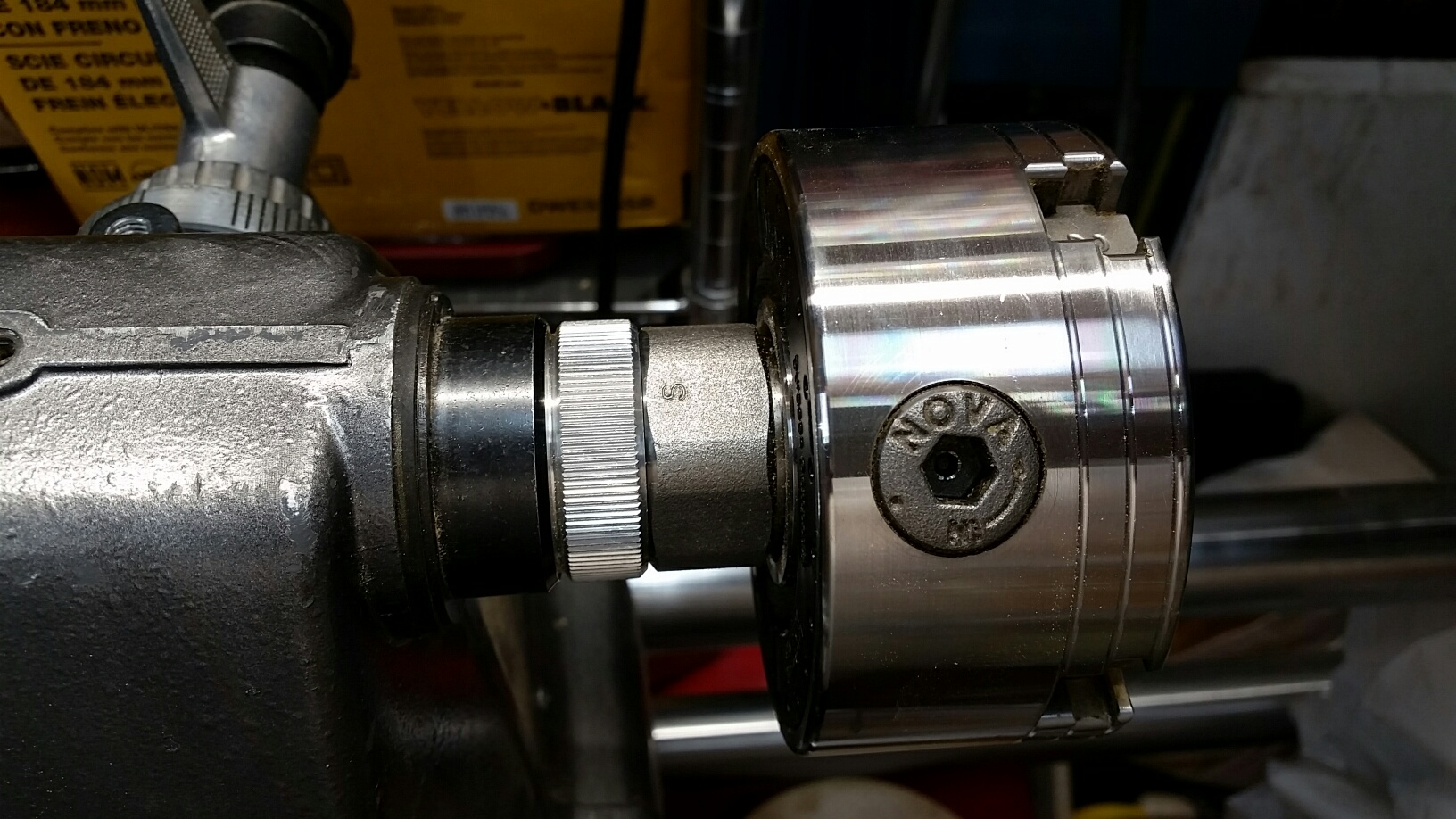

The chuck should mount the same way. Now the adapter could be an issue if it is coming loose. Some years back they shipped with the plain 5/8" adapter rather then the shopsmith version with angled set screw. They may have messed up again??? Anyway the correct adapter is a "S" and that will be stamped on it.

The 'collar' serves to limit axial play in the quill shaft. There is no other position for it.
The quill shaft has a tapered flat. The arbor /chuck must be rocked so as to center the set screw at the lowest point on the flat. The arbor/chuck should be up against the 'collar' when the set screw is tightened.

One of our club members had a similar experience with a Nova chuck. He was using it on the Delta 46-460 lathe at our shop and had some run out. After several checks I found that the chuck was not screwed fully on to the chuck adaptor. I removed the chuck and adapter assembly from the machine and put the adapter in a bench vice and was able to rotate the chuck body another 3/4 of a turn.I did not have to use a wrench only my bare hands. The chuck and adapter have to be screwed together tightly to eliminate any play in the threads. The chuck did run true after the adjustments.
