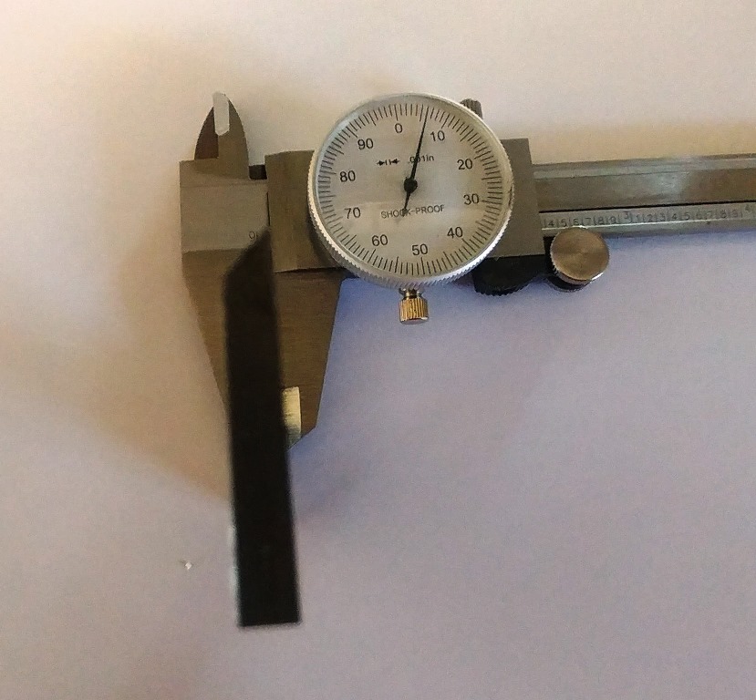

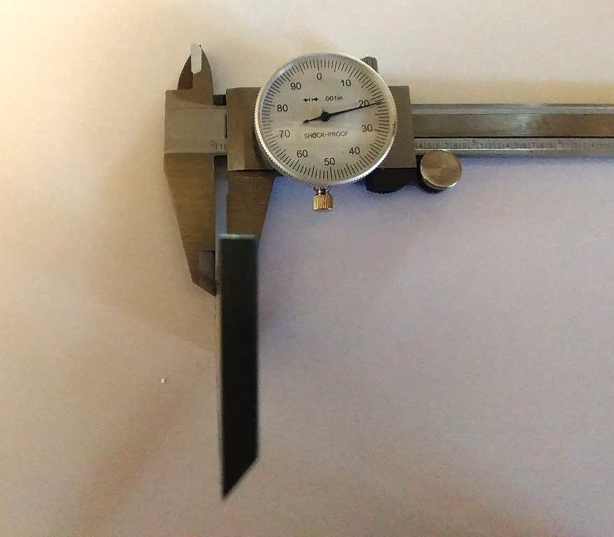

I'm trying to picture the taper. Can someone demonstrate it with dial calipers or ??? The knives I removed from my SS measure 0.120 thickness...no taper.

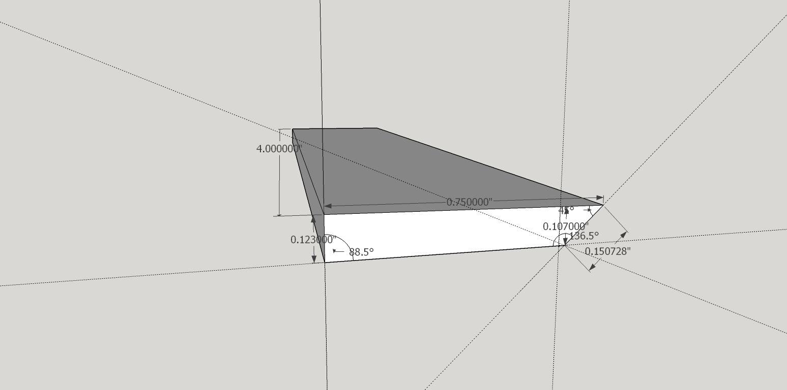

Re: Jointer Blades
roamer46 wrote:I'm trying to picture the taper. Can someone demonstrate it with dial calipers or ??? The knives I removed from my SS measure 0.120 thickness...no taper.
This represents an unsharpened Shopsmith jointer blade. I hope this helps.
Jointer Blade with Dimensions.png (35.49 KiB) Viewed 5749 times
Genuine SS blades are definitely tapered. Did you buy the jointer new? If not the PO must have replaced the blades with non SS ones. My spare set measure 0.106 on the cutting edge and 0.122 on the other edge. If you look closely you can actually see it with the naked eye.
So either the cutter head or the wedge (or both) is made to fit the taper. Who knows why SS decided to make them tapered. There are millions of jointers in the world with non tapered blades. They all work fine. In fact has anyone ever heard of another brand of jointer with tapered blades?
Can you use non tapered blades? Yes. After all yours has been running with them for how long? Should you? Probably not. Is it unacceptably dangerous to use non tapered blades? Probably not. The centrifugal force of the blades when the cutter head is spinning pushes the blade into the cutter head not out of the cutter head.
The SS blades are the same price as the Infinity. Yes the Infinity are carbide but the SS blades are dead easy to sharpen yourself. The Infinity blades are only 5/8" wide. SS blades are 3/4" wide. That would be a show stopper I believe. Someone correct me if I am wrong, but I think SS recommends new blades when they get less than 11/16" wide.
I checked the jointer manual. It says any blades less than 11/16" wide should not be used.
