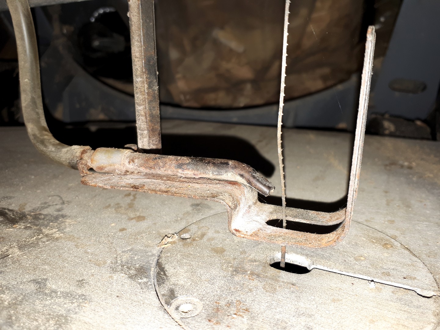

This is a photo of the pressure foot on my grey scroll saw, the metal tube behind the blade is for the air blower and should not contact the blade.
grey scrollsaw guide.jpg (403.3 KiB) Viewed 11829 times
My 10er jigsaws have a soft fibre rod that guides the back of the blade

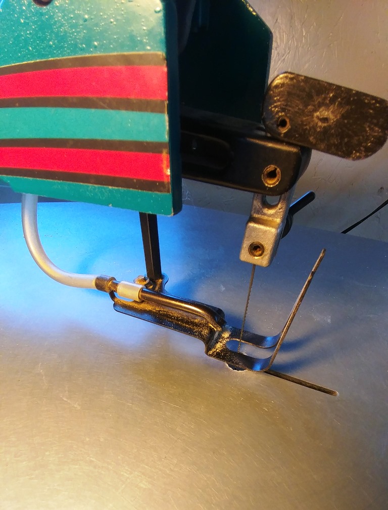

FWIW, the pressure foot on the Teal scroll saw is very similar the the grey one.

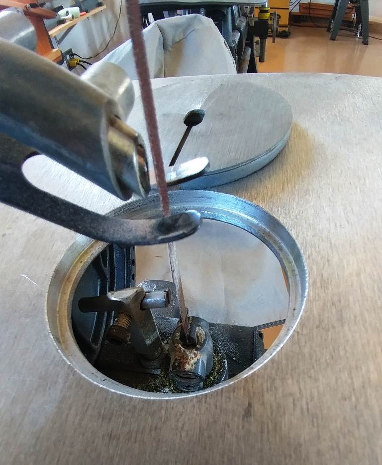

Yes the 610 jig saw has the split tube upper guide but it also has a lower guide/back up like the 10ER. I have two of them here. One has the Magna M on the crank case cover and one has the SS logo. The Magna one has a phenolic rod and the SS one has a metal rod. I don't know which is OEM, maybe both. The manual I have does not call out the material.

Thank you for leaving a bit of saw dust on the scroll saw foot, :) so I wouldn't feel quite so bad about not cleaning mine off before taking the picture. :o I got it last summer but haven't got it set up to use it yet.
