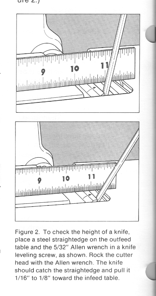

Somewhere in the documentation Shopsmith sends with the Jointer is a very simple way to set the blades using a simple block of wood. Nothing more than that is needed to get it right.
Posts: 6585
Re: Installing Jointer Blades
garys wrote:Somewhere in the documentation Shopsmith sends with the Jointer is a very simple way to set the blades using a simple block of wood. Nothing more than that is needed to get it right.
Actually SS says to use a steel straightedge but you are correct, that is all that is needed. That is all I have ever used. The same with the planer. The knife setting gauge that comes with the planer works perfectly. If you don't have one they are $8 from SS.
The picture shows the figure from the SS jointer manual that shows how to do the check.
