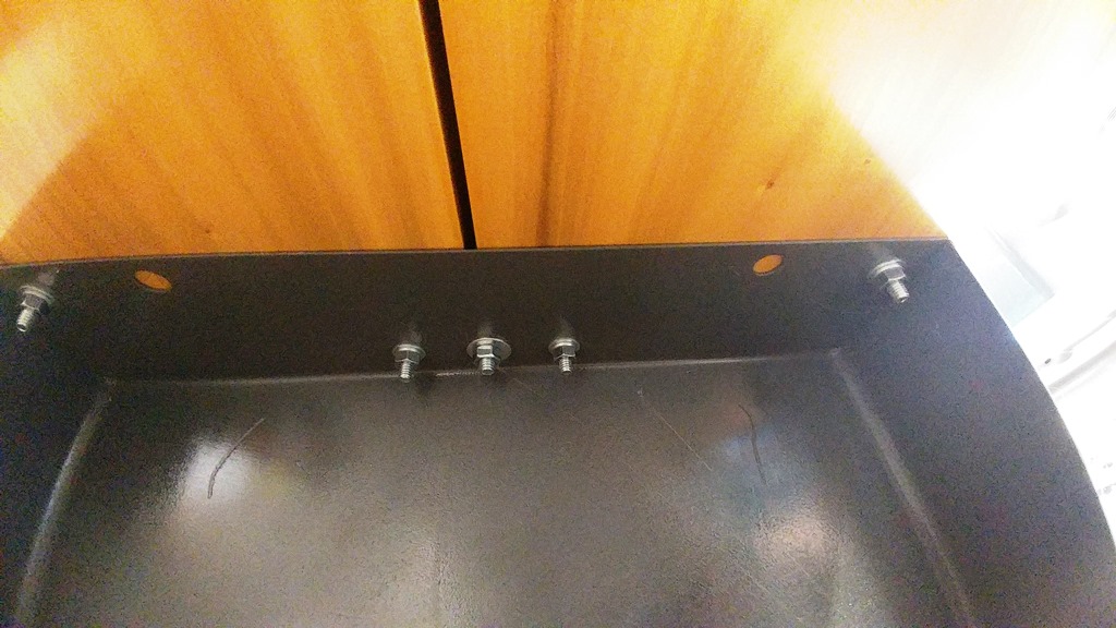

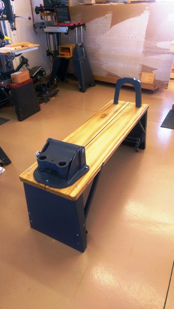

I'm slowly making progress on my machine. I got the legs out of storage and started looking at the layout of the legs and the baseplate to the bench. I assume that the carriage bolts used to mount the legs don't need to be countersunk? It looks like the heads could fit in the cavity of the baseplate.... If I have to counter sink them I'd like to do that before the though hole.

It might depend on which base plate you have. The later shorter base plate is fine. No need to recess. There are only two bolts under the base plate.

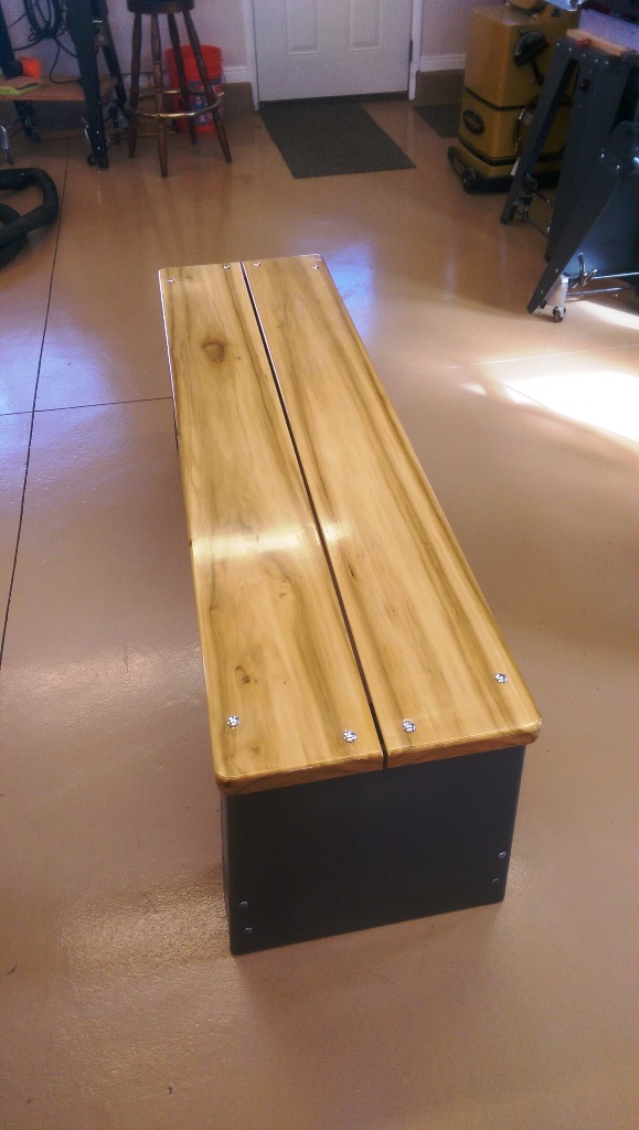

I'm not sure which base plate I have but visually it looks like the one pictured.
I also noticed that the legs have holes that match the base plate so they need to match or totally un-match to work right.
Can I assume using the base plate mounting hole are square so when I mount the base plate I can square to one side of the bench using those hole positions to square?

Not sure what you are talking about. The only hole that matches is the the hole in the center of the end plate. That is the bolt in the center with the larger washer. The other 4 bolts connect the legs to the planks.
