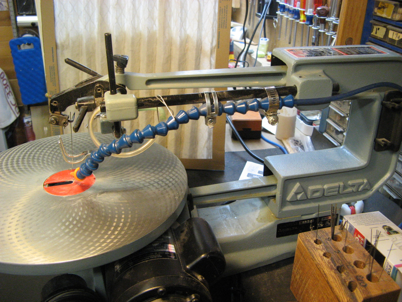

I understand that this doesn't directly answer the question, but thought it might help. My Delta scroll saw blower was awful. In talking to those who scroll regularly - many use aquarium pumps for blowers to clear dust from the pattern. Here's a pic of mine. You can't see the pump because it behind the box fan (collecting dust). The pump was garage sale find.
