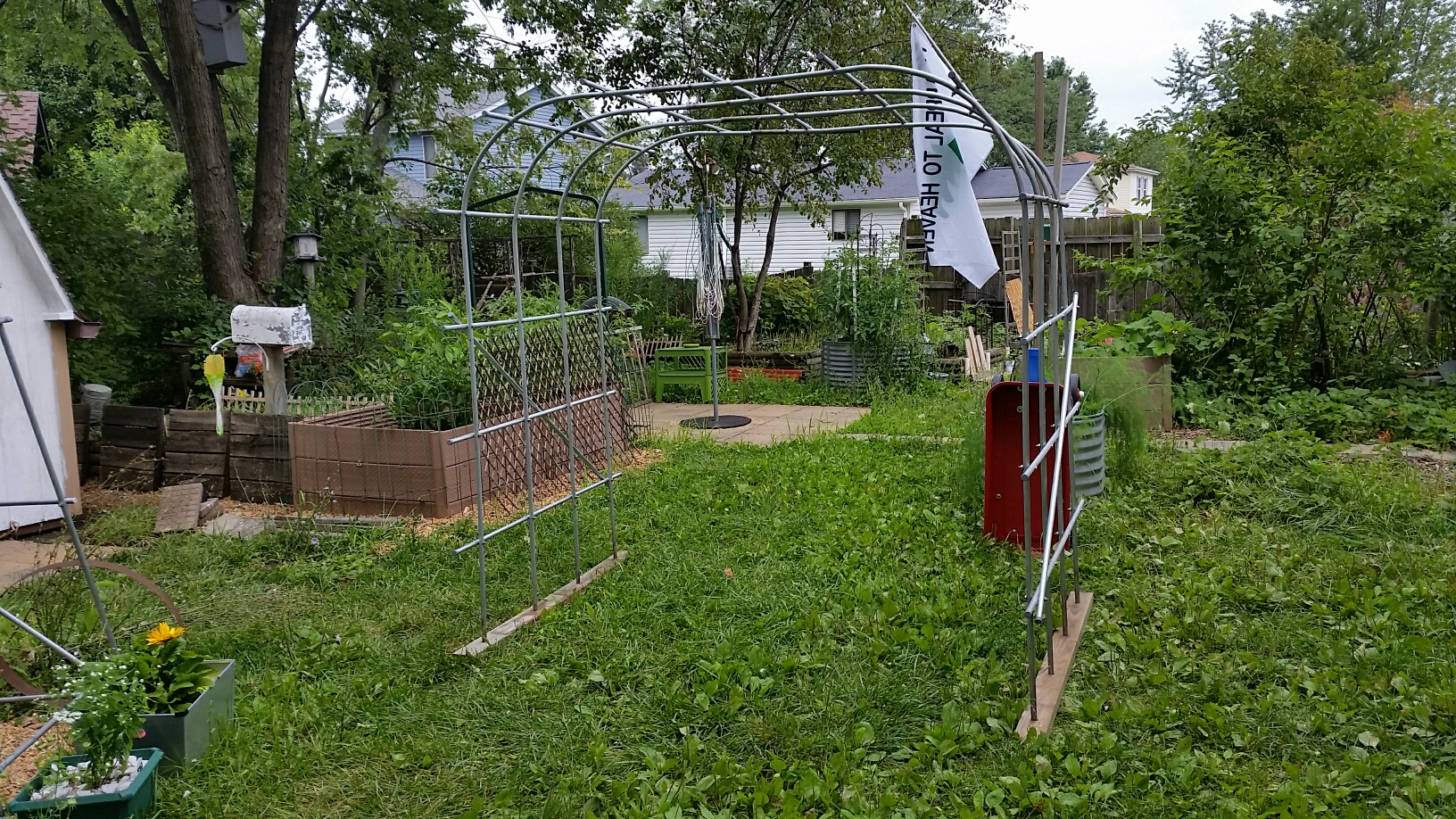

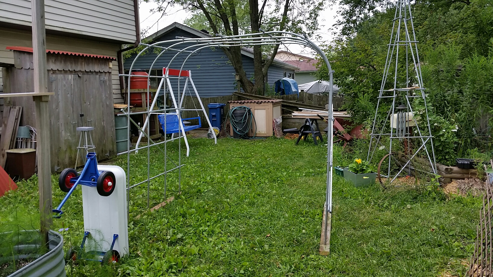

This years conduit project is a trellis. Sixteen and a half lengths of conduits with two shorter lengths left over.
I don't know why but I like making conduit projects. And this one was fun and I hope useful. I went with stainless steel hardware for this project, just for a change of pace over the last couple of projects.
There was a few none through holes in wood and a bunch of hole is the conduit, some done on the shopsmith and others with a drill guide and drill. The shopsmith holes were easy, not so much for the other holes.
Anyway it is just about done. I need to go back and tighten all the fasteners and do a little caulking of joints to eliminate some of the major water collections issues. Doesn't have to be water tight just don't want the tubes of water rusting away the tubes before their time.
Here are a couple of pictures. It is standing in the middle of the yard while I finish it up. Next spring it will have to be in position and have the bird net added for the vines to get started growing on. This should have been ready for this past spring but back issues prevented it.

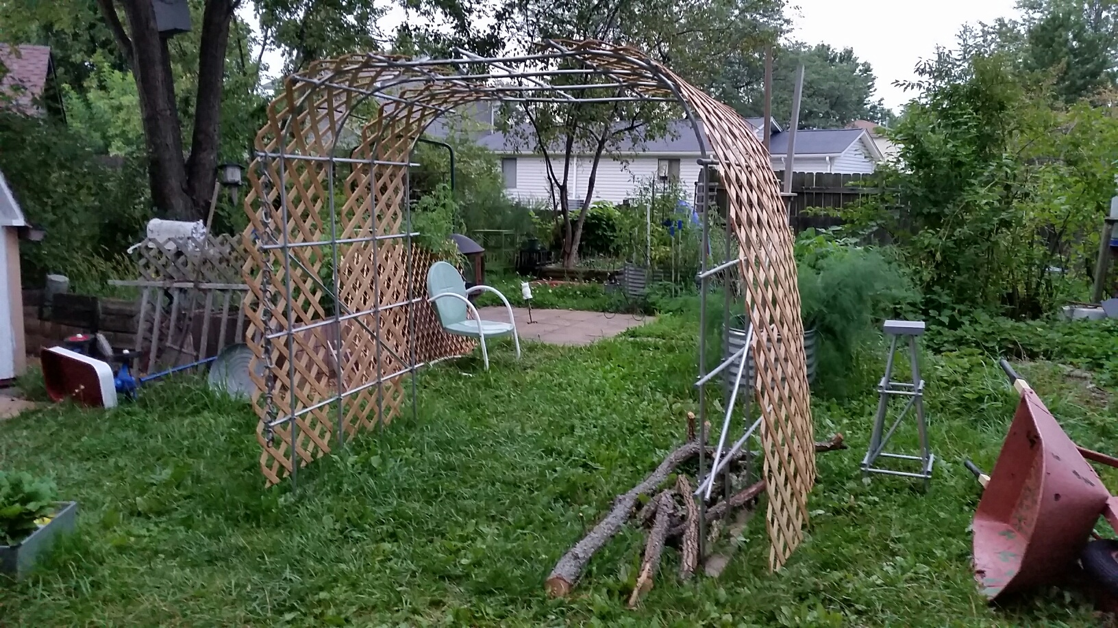

I've added some cedar lattes to the mix. The ones on the left have been on a few days and are conforming nicely. I just added the two on the right, if we get some rain tonight, which we might they will start the process of bending to fit as well.
Have to decide if I want to add more to the top or not. Vines don't really need it but it sort of looks unfinished to me the way it is. Have to think on it for a while yet, but the 11% off at Menard's ends this week so I better make up my mind.

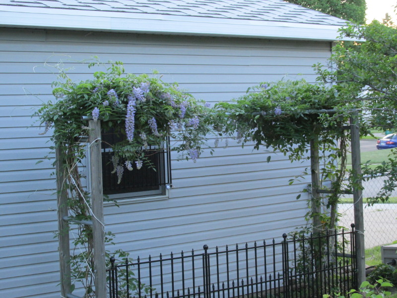

Nice. What kind of vines do you plan to grow on the trellis? A few years ago I made a heavy duty trellis for my wisteria vines. The wisteria gets quite heavy by the end of the growing season, so I wanted a trellis that would hold a lot of weight.
I started with landscape timbers set into the ground at the corners and tied them together on top with top rail for chain link fence. The timbers are also bolted together with threaded ready rod through chain link pipes for stability.
