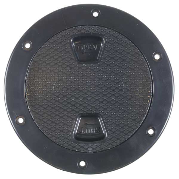

Bill Mayo and I last discussed an idea I had run by him for installing a 4 inch screw-in plastic deck plate on the back of "A" headstocks and affixing the Inspection cover to the screw-in lid somewhat like the one I attached below which I could buy for less than $15.
Sadly Bill's health degradation accelerated and I did not embrace the project until he had a time to get better if he could.
Maybe it is something you might consider for yours and let us know how it works out. You would use a large metal hole saw at a slow speed to make that opening, the appropriate size for the deck plate you select.
It certainly would add more than $15 of value to the headstock in my mind.
Bill had abandoned modifying "A" headstocks and simply sold them for scrap metal as he had a copious supply of "B" or "C" headstocks he had aquired or could acquire on eBay etc. He chuckled when I shared it with him and said "I wonder why I never thought of that?"
