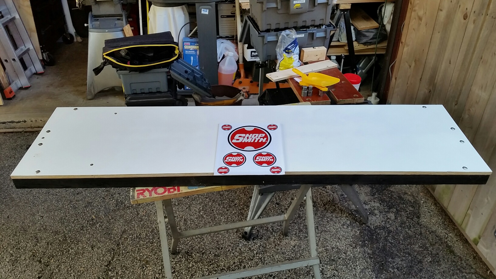

Then I recall seeing a 10E? with a bench and the shopsmith logo on the bench. I'd like to see that again but I don't recall who posted it. So if this rings any bells let me know. I think I might do something like this using a current a shopsmith decal which I have purchased from them.

Skip has used a decal(or similar) on his. I have seen pix of others.

These are the stickers I have:
The large one centered or there abouts......... not sure where I really want it but perhaps better seen if it is forward more and right adjusted??
