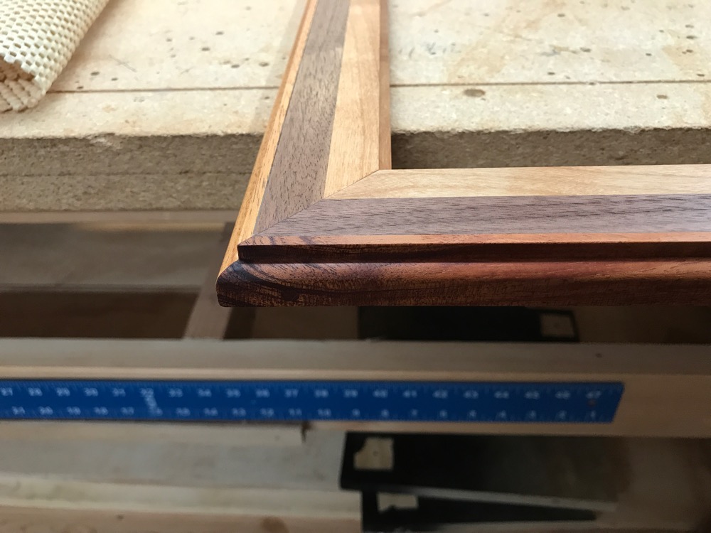

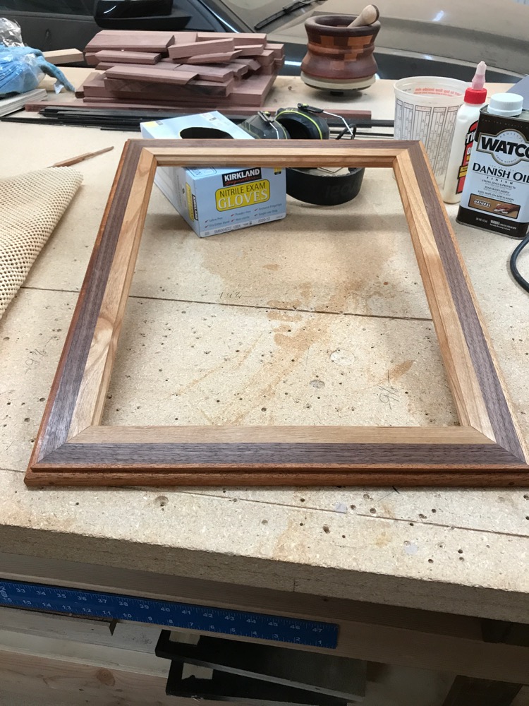

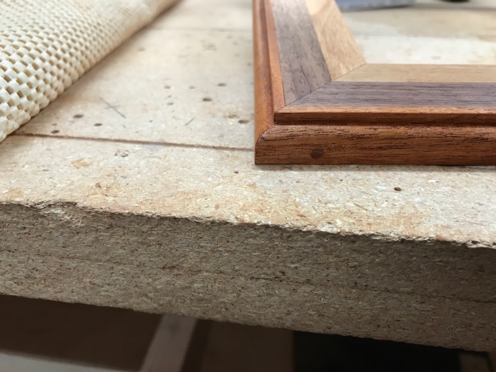

Finished the picture frame. Here are some pics of the doweling.
- IMG_5104.JPG (251.77 KiB) Viewed 9970 times
- IMG_5105.JPG (146.36 KiB) Viewed 9970 times
- IMG_5106.JPG (193.05 KiB) Viewed 9970 times
Re: Picture frame mode
Very nice. Hardly can detect the dowel. Assume it is from the same type of wood as the frame?

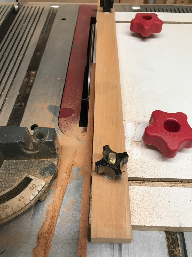

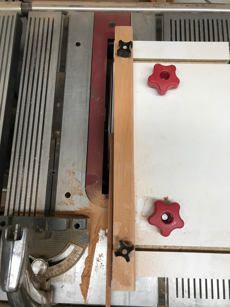

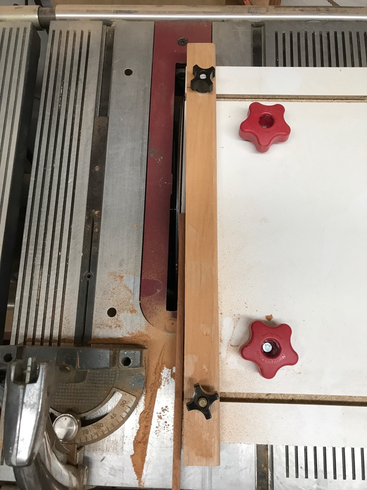

The jig is just a taper guide so as you twist and feed the square stock through it rounds it to the size you need. It works much better with the conical disc but I am usually to lazy to change discs. The flat disc works fine. You just spin the stock as you feed it through.
