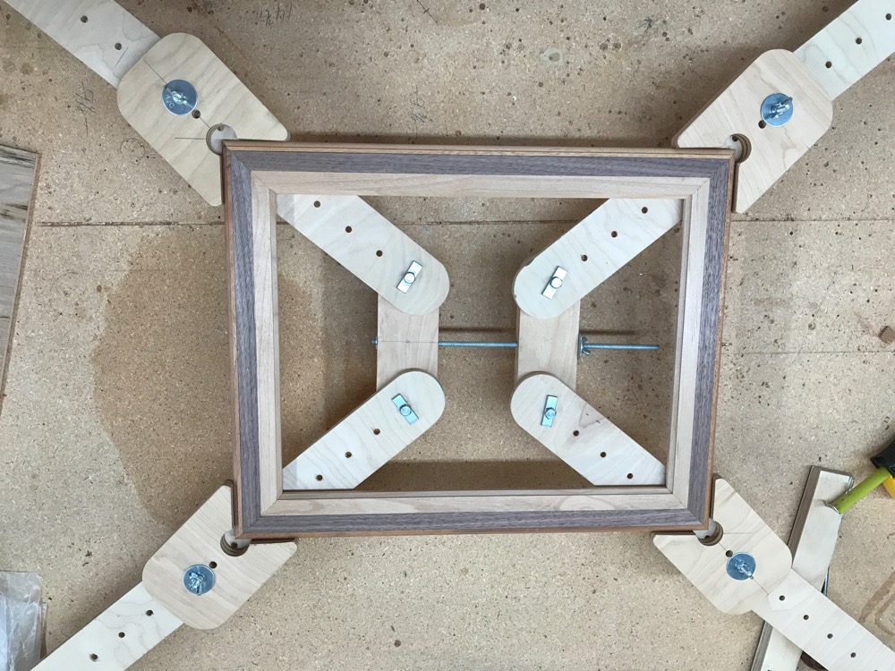

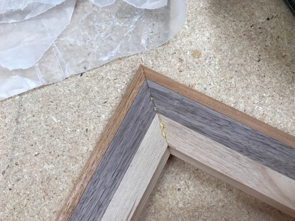

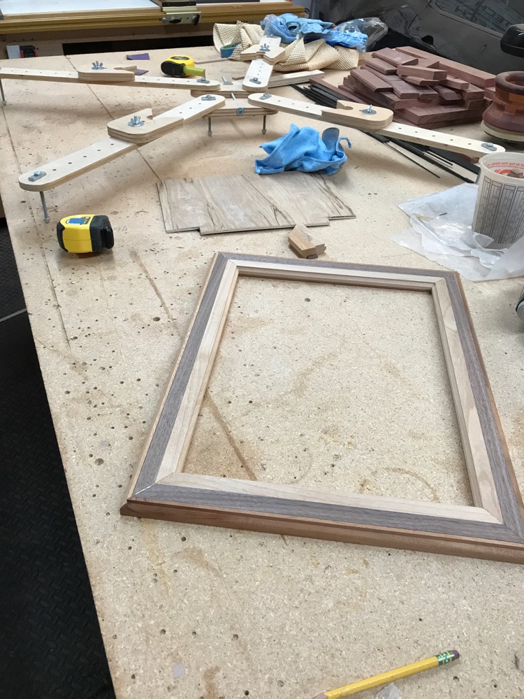

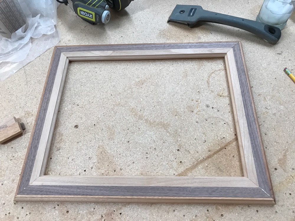

Had to crank out a picture frame while glue was drying on the final assembly on the table. Alder, mahogany and black walnut.

Interesting jig ,,,, cant wait to see the finish on it ,did you use biscuits ?

No I couldn't use wafers because they were too narrow. At the moment they are just glued. Tomorrow after the glue dies I will drill them out for dowels top and bottom.

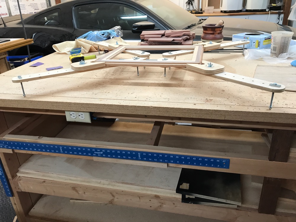

Cool frame, and i am very curious about that clamping jig (and the segmented vessel to the right!). Any chance you can post a pic of the jig at work?

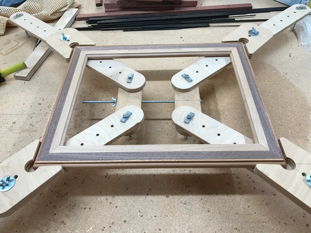

I put the frame back in the jig to take the pictures. It's a fairly easy jig to build and it works very well. It's made of 1/2" ply and the corner blocks are 3/4 ply. The corner blocks have two holes that are half the distance of the holes on the cross members for a little better fine adjustment. I will frequently put the frame together on the bench with pinch dogs and then set the frame in the jig for clamping just to speed up the process. Greatly simplifies making picture frames which is a good use of the scraps left over from other projects. Between frames and segmented bowls one can use up just about every little scrap.

In the pictures I left out the wax paper that is there while actually gluing between the frame and the jig.

Re: Picture frame mode
Is it correct to assume the rectangular pieces under the long bolt heads that serve as 'feet' perform the function of a washer and that there is another on the under side with a nut(or two)?
