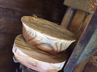

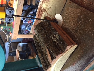

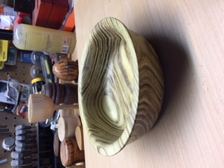

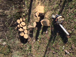

Thought I'd add one of my projects... Black locust fell down in my back yard early this year and I finally chainsawed it up the other day. This was the first time I'd ever started with a log before. Having a hand in every aspect of the product was very cool and rewarding! I can't wait for more...

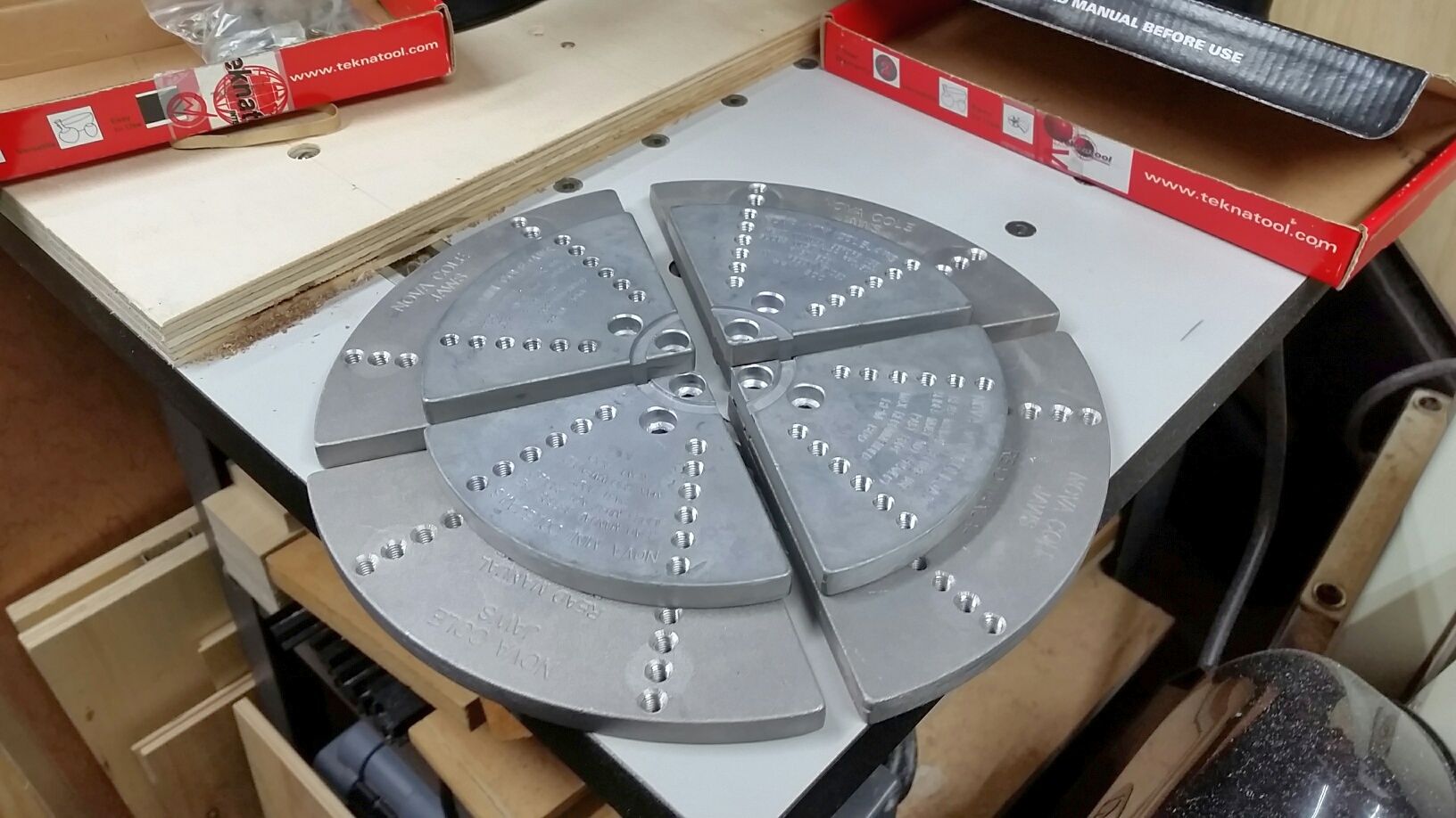

brian wrote:I think I'm going to snag a G3. Does anyone have the Cole jaws? If so which size did you get? I'm looking at the 10" but their is a 12" one also...
I went with both sizes. I got the smaller one first, it has a maximum rpm of 800 which fit with the mark 5 speed range of slow (700 rpm). The larger one has a maximum rpm of 600 which works with the speed reducer, powerpro or 10's that can go that low.
I don't recall the dimensions they grip but it seemed more reasonable to have both and cover the full range they have rather then find out that at the last stage I didn't have the jaws to finish with. I added the larger size when I got the powerpro.
BTW the larger set has the same lower range as the smaller if I remember right, it just adds the larger sizes.
Here is a photo of them layed out with the smaller set on top for reference:

Thanks for the pic. So would you go for the larger first?
