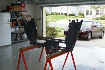

You do not have to lay on the floor if you do this.
[ATTACH]23305[/ATTACH]
Bill V
SS upside down.jpg (67.34 KiB) Viewed 6933 times
