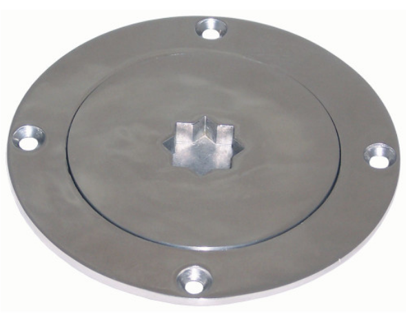

I have mentioned this before but I don't have an early headstock that I am willing to modify at this time.
I have attached a photo of a stainless steel inspection port for marine application that might be a real easy solution. There are a host of types of ports in metal or plastic and prices across the board.
Were I to use this one, recognizing the area it would mount is not 100% flat, I would mount it with auto masking tape on the back side, then fill the gaps with JB Weld to fashion what would appear to have been a cast stand-off for it, then touch up the paint accordingly.
It would be simple, and solve the problem. One could still affix the logo plate if desired and have a finished inspection port.
This 316 stainless steel highly polished inspection port includes a deck ring and cap. The cap is supplied with an o ring to ensure a watertight seal.

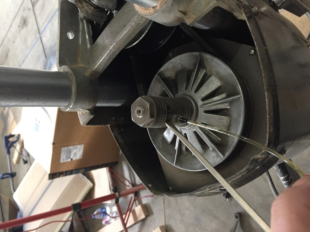

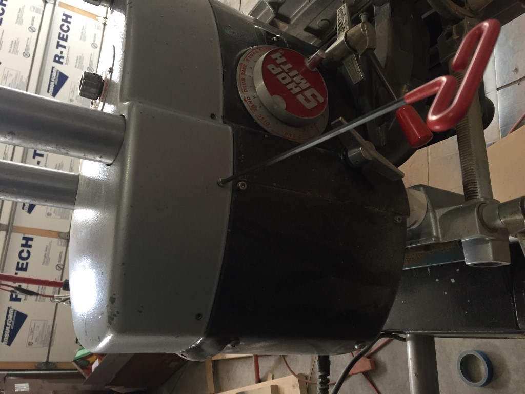

I did say I would post photos. Sorry it's taken so long. (5 years! Really?)
I have an A head stock and I don't have an inspection hole. I really don't want to drill or cut on my headstock.
Here is what I do.
Set in drill press mode
Unscrew belt cover,

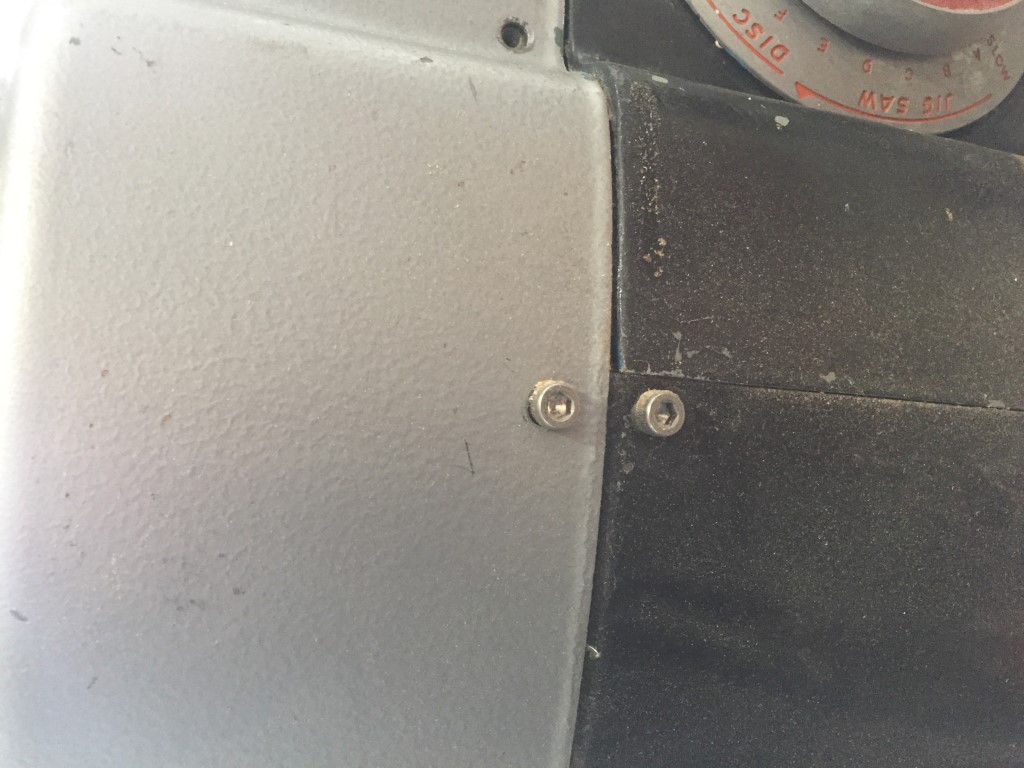

NOTE: I upgraded the screws on mine to 5/32 allen head socket cap screws.
The original threads were stripping out and I had to do something. So I replaced with the socket screws and used some JB weld to fasten corresponding nuts to the inside of the headstock.
now I can use my magic tool for removing the screws. slide up the way tubes, and clamp out of the way. Inspect everything while I'm in there and vac sawdust/wipe clean or whatever,
I can easily lube the motor spindle,

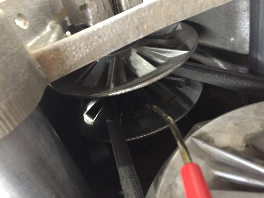

I insert a screw driver into the spring and spread it apart in several locations.
I lube the idler spindle using 3 in 1 oil with the handy extendable flexible spout. The oil just has to get on to the shaft it does not have to go in some magic hole.
I put the tip of the oiler between the sheaves and shoot some oil onto the shaft. Spin it a bit and put some more on a different part of the shaft.
I then manually run the speed up and down to work the oil onto the shafts to make sure every thing is lubed add then a few extra drops and let it sit overnight.
The next day, run the motor and run the speed up and down a couple time to make sure everything is happy, replace the cover and back to work.
Just the way I do it for a quick lube.

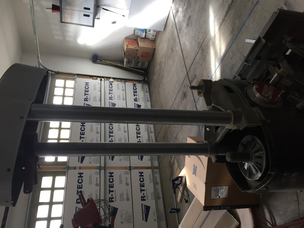

I do sometimes drop the motor. if more thorough cleaning is required. In which case I reverse the table on the carriage put some cardboard down loosen the screws and fold the motor pan down onto the table.

Re: Greenie Lubrication
When oiling the floating sheave, the oil Needs to get between the motor shaft and the sheave, not on the outside of the sheave Hub.
