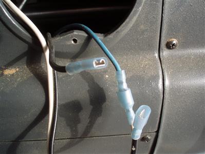

I don't know what to call them so I'll just post a picture. Anything that will handle the appropriate wire gauge should work. I made the wires on mine long enough that I can rest the motor pan on the way tubes and still have the motor connected to the switch with the Mark V in drill press position.
If you do this, you must be very careful when stowing the extra wire for normal operation. You really don't want that wire to get wound around a powered shaft or a sheave.
[ATTACH]18961[/ATTACH]
These are just two pairs of spade lugs for 14 ga wire.
The blue and the black wire go to the motor. The other two wires go to the switch. These are all hot wires. There are no neutrals shown in this photo. The neutral (white) wire (not shown here) from the motor is tied directly to the neutral (white) wire (also not shown here) in the power cord. I am stating this because it would be logical for any reader to ASSUME that the white wire in the photo was an ac neutral wire.
