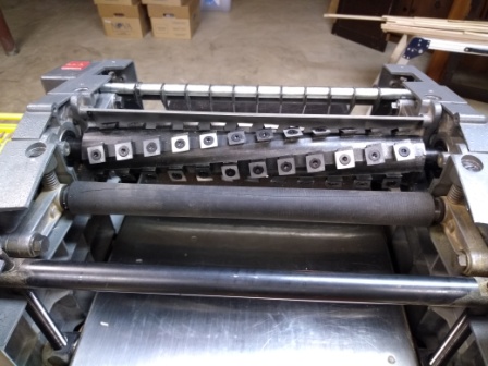

I recently installed a Shelix cutterhead on my planer, and it works great. The cut is very smooth, and it is significantly quieter.
Installation was fairly easy. After removing the top and side covers,the original cutterhead can be pulled out by removing the bearing support (on the side without the feed motor). Then was then able to insert the new cutterhead and reattach the bearing support. I ordered the cutterhead with new bearings, and did not have to pull the old ones.
No more sharpening and resetting the knives!
Cutterhead installed1.jpg (61.51 KiB) Viewed 4766 times
