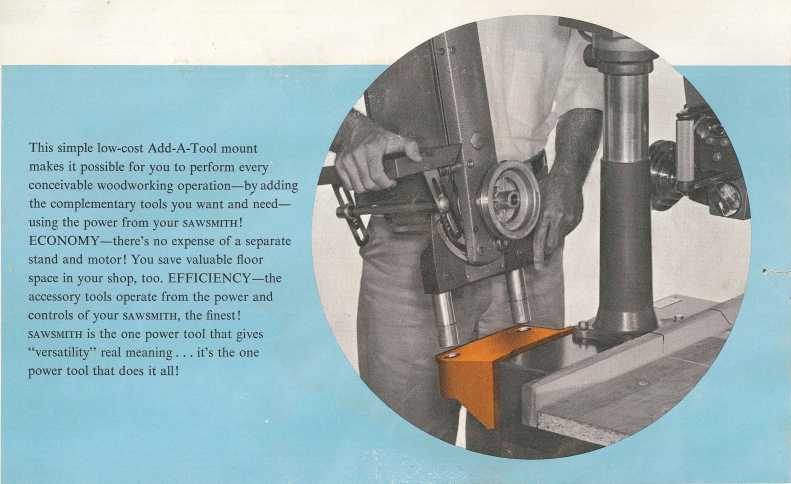

Here is a photo of that tool mount bracket for those not familiar with it.
Everett
