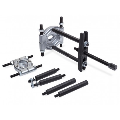

It is time for a bearing puller I would say. Consider after you finally get into the quill assembly to replace the bearings, you will likely need it for them, and on the other end of the quill assembly on the drive sleeve assembly.
If you have hammered on the spindle and bent it even slightly in your process of trying to free up the part, it may be more expensive to repair than to replace with a used part from eBay.
IF you go there, just make sure you buy the one for the type drive you have Gilmer (toothed) or Poly-V style as the number of teeth on the back side of the spindle are different spline tooth count.
Bearing Puller.jpg (22.08 KiB) Viewed 8383 times

How is a bearing puller going to work? The silver part goes around the back of the part to be removed and the screw shaft in the middle goes on the point of the part to be removed. It's pulling on itself. That is like standing in a bucket and trying to lift the bucket by the handle.
Am I missing something here?
Posts: 4199
Re: Lathe Center stuck on Morse Taper shaft
The bearing puller halves (the silver parts in the picture from Everett) are tapered and clamping them together could "pry" the part off. He would not need to use the other puller parts (shown in black).

WildHorseHans wrote:How is a bearing puller going to work? The silver part goes around the back of the part to be removed and the screw shaft in the middle goes on the point of the part to be removed. It's pulling on itself. That is like standing in a bucket and trying to lift the bucket by the handle.
Yes the bearing separator as you tighten the bolts on it applies axial force due to the wedge. Based on the gap between parts being separated, one may have to cut the side out of 5/8 washer or notch a piece of flat steel to slip behind the separator to get the wedge lip in the right place to apply pressure to do the separating, but showing the whole tool was to illustrate that the tool set is available to pull off the bearings once the other part is off.
Now that he has it de-rusted I wonder if a 50/50 Mix of Acetone and Automatic Transmission Fluid bath might provide the penetration he needs to free it without the separator, but he will need that anyway to pull off (or press off) the bearings in the quill.
