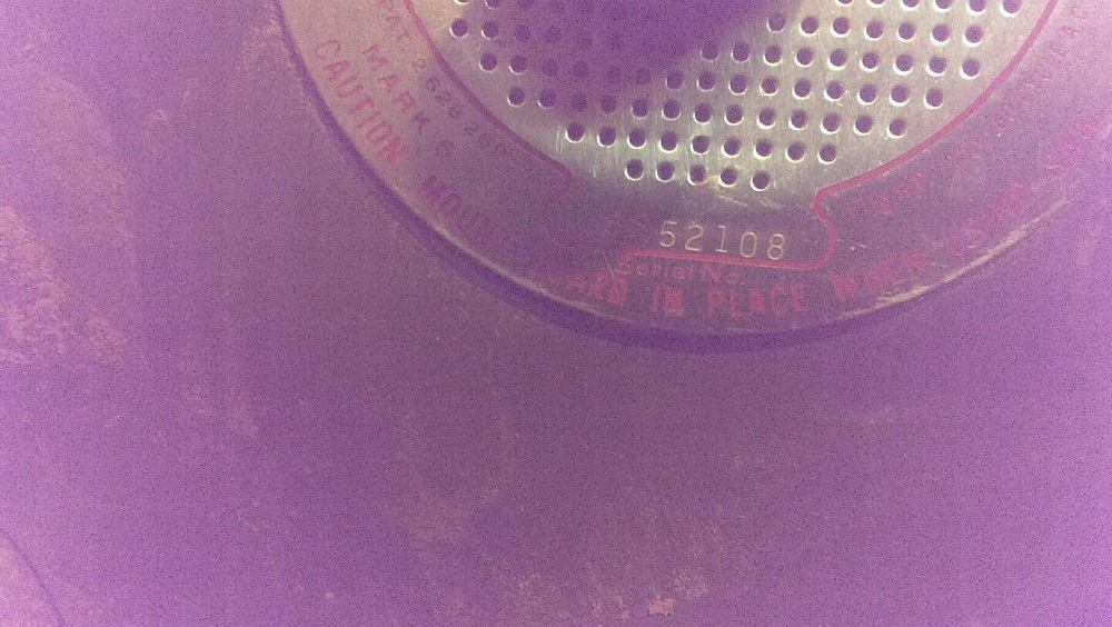

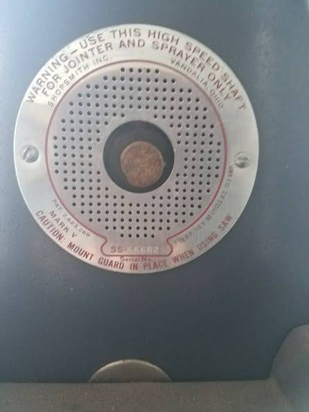

Thanks Everett,
I agree November 15, 1947 must be the correct delivery date for those first 250 10E to Montgomery Ward stores.
As for the Mark 5 to Mark V on the Serial Number/Vent Plates the highest S/N I have seen (in pictures) with Mark 5 is SS 52108 from January 1980 and the lowest with Mark V SS 55582 from March 1980 so the change must have been made sometime between late January and early March 1980. When Shopsmith had the production by month in serial numbers listed it did not mention when the change took place.

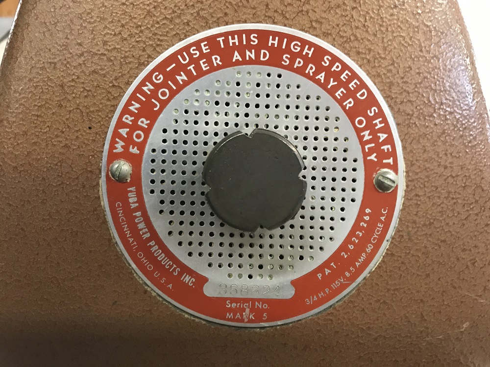

Below is a Yuba Goldie Serial Number/Vent Plate from the one I restored.
That would be October 1960 according to the list.

Thanks for the Yuba vent plate. You restored Yuba Goldie Mark 5 368624 which was a 1960 machine with 3/4 HP motor.
I will go back to the original post where the others are and insert it with a notation to make it more fluid visually.

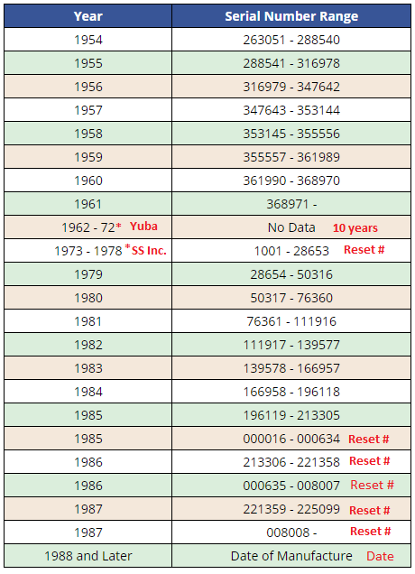

You also stated: When Shopsmith had the production by month in serial numbers listed it did not mention when the change took place. Haven’t found a clue yet, but looking….
Their site at http://www.shopsmith.com/ownersite/toolhistory.htm "Shopsmith Mark V/Mark 7 Tool History" states: 1964 -- Was Temporarily Out of Production - The Magna America Corporation relocated and the Mark V went out of production.
I believe that Mark V is a typographical error reference and it should read Mark 5, since the first Mark V rolled of the assembly line March 20, 1973, a full nine (9) years later.
Shopsmith Inc. Significant Events registry states when the first Mark V rolled off the assembly line: March 20, 1973 and goes on to state 11 days later they had sold (not that they had manufactured) 1,940 Mark V units following its introduction.
Could I get a copy of the vent plates for the two you referenced in quote Mark 5 is SS 52108 from January 1980 and the lowest with Mark V SS 55582 from March 1980?
What change are you referring to in the statement: made sometime between late January and early March 1980.

I put together some notes within the SS Serial Number Chart they list on website.

Here I am referring to the chart of Serial Numbers by Month of Manufacture which previously was available on the Shopsmith website. MickyD and I both have versions where we filled in the blanks except 1961 to 1977. The Change from Mark 5 to Mark V I am referring to is when it changed on the Shopsmith Headstock's Serial Number/Vent Plate. Mark V had been used prior to that time in advertising making the use of Mark 5 and Mark V pretty much the same. Below are MickyD's and my versions.You also stated: When Shopsmith had the production by month in serial numbers listed it did not mention when the change took place. Haven’t found a clue yet, but looking….
This is the time frame I have narrowed it down to when the Serial Number/Vent Plate on the headstock changed from Mark 5 to Mark V. Below are the two Serial Number/Vent plates.What change are you referring to in the statement: made sometime between late January and early March 1980.
I believe the SS prefix for the Serial Numbers was Shopsmith Inc. way of making their serial numbers different than previous ones used. Remember SS Inc. restarted the serial numbers at SS1001 when they resumed production of the Mark 5 in 1973. The SS prefix continued until date coding replaced the serial numbers in December 1987.There is some speculation on the SS prefix use as some have suggested they brought it back to designate factory refurbished machines from another time period. I don't know enough yet to distinguish that. Haven't found anything yet but there is a lot missing in that 10 year void in serial numbers.

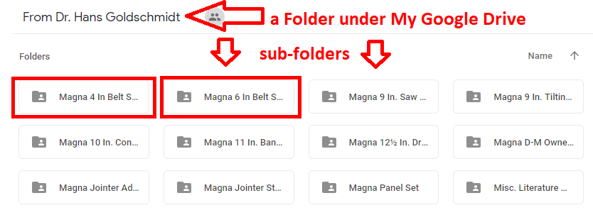

New Content from Hans: in Shopsmith Large Format Drawings, Illustrations and More
Files under Link at My Google Drive (see highlighted folders below)
http://www.shopsmith.com/ss_forum/viewt ... 90#p185690
There's one product new to me ...
Everett
UPDATE - Added Magna Diaphragm Type Air Compressor Model D-M and Model K-M Sprayer Owner's Guides - exceptionally clean scan from pristine originals
