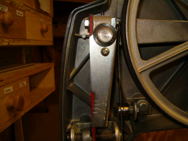

Read my instruction manual re: adjusting the scale on the bandsaw. Here's what I found. (not verbatim, but in my words)
1) Loosen the tension completely
2) Loosen the screw (mine is a round head #2 phillips) at the top of the stamped, metal scale.
3) Line up the red spring with the left edge of the metal scale
4) Tighten the screw
5) Install a 1/4" blade and tighten tension to 1/4"
6) Spin the wheels by hand several revolutions to make sure the blade is tracking.
Here's a Photo of what mine looks like with no tension:
[ATTACH]2269[/ATTACH]
- HPIM1867.jpg (119.91 KiB) Viewed 11929 times

Did you find the instructions to adjust the tension indicator? It's fairly easy to do. Also the tracking problem may be caused by the tilt on the upper wheel being incorrect. See the link to the Ask Smitty in the July/August 2004 Hands On. Caution, the regular page is the correct amount of tilt 1/8". If you download the PDF it has the wrong measurement, it has 2-2&1/2", this could damage your band-saw.
http://www.shopsmithhandson.com/archive ... smitty.htm
Good luck.
Good luck.
Jim in Tucson
