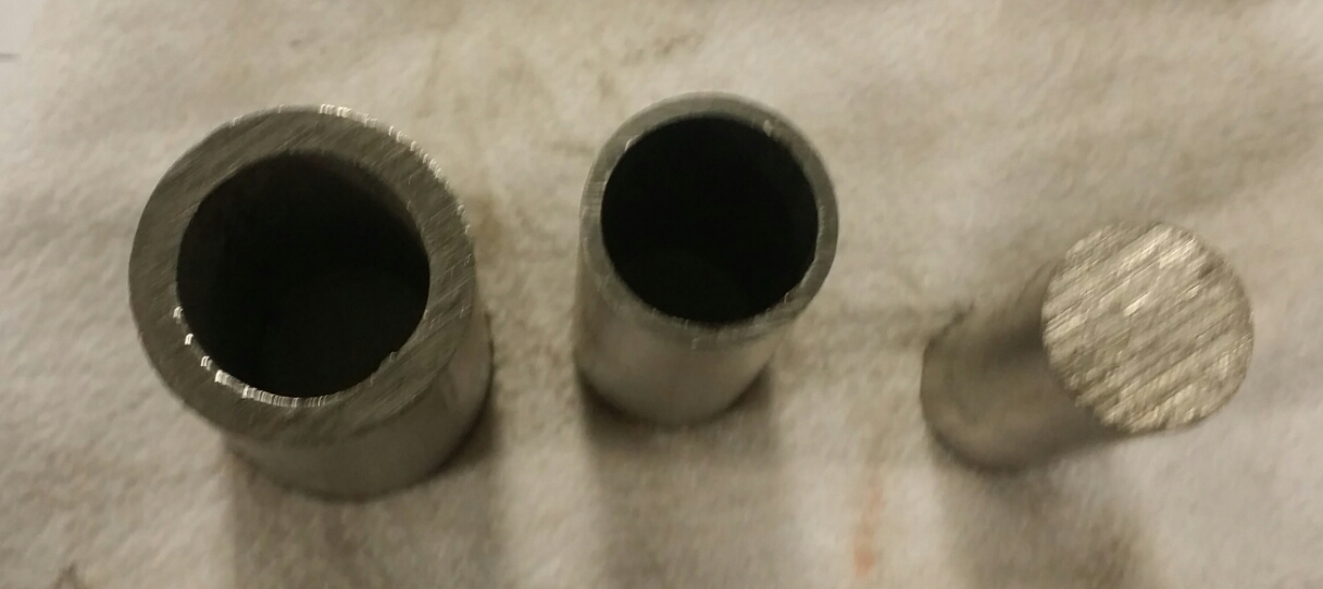

The parts needed
The parts needed
2018-07-07 20.24.39.jpg (518.32 KiB) Viewed 5796 times
Why? Because I am cheap... uuhhh, frugal maybe? Yeah, let's go with that...
1"o.d. 3/4 i.d. , 3/4 o.d. 5/8 i.d., 5/8 rod... All items are 304L SS...

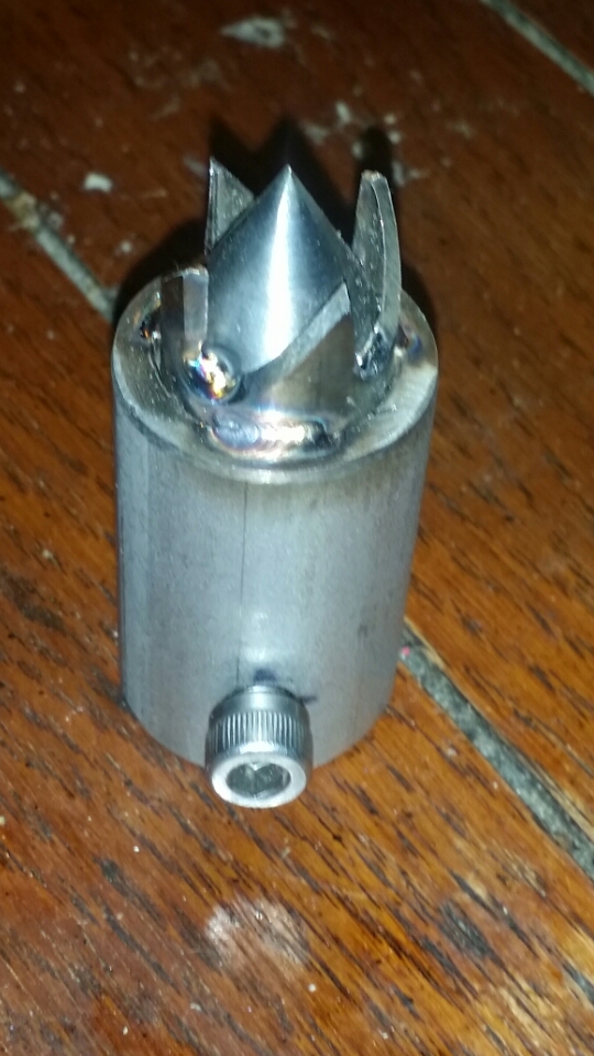

Cut them all on the bandsaw to length, then I cut slots/edges of the soon to be spur. Next, I went over to the belt sander and began the shaping up of the spur.
Next, I grabbed the solid rod and began shaping it on the belt sander also. Dipping it frequently in water.
Then I welded it together. Finally, I drilled and tapped the hole. All in all about a 30 minute DIY.

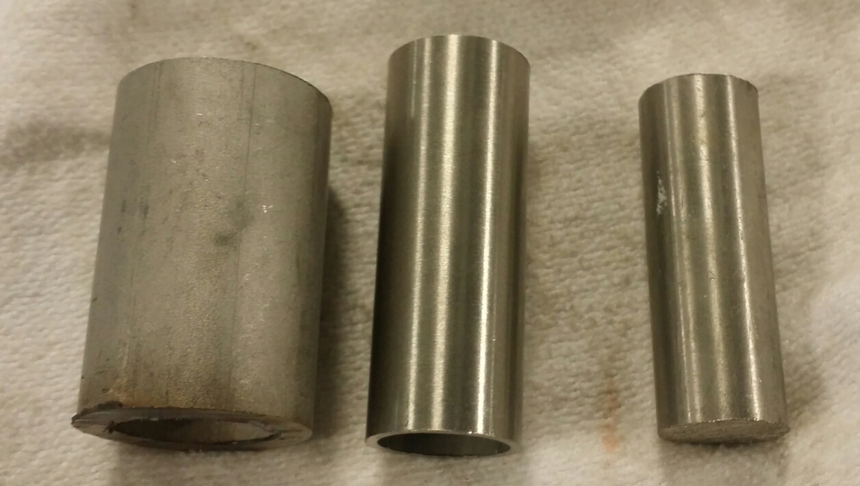

Different view
Different view
2018-07-07 20.25.05.jpg (347.33 KiB) Viewed 5796 times

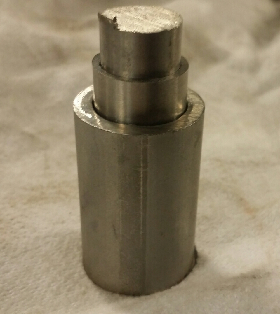

Everything stacked together
2018-07-07 20.33.08.jpg (519.48 KiB) Viewed 5796 times

Cleaned it up some and drilled and tapped the hole...
2018-07-07 20.46.39.jpg (347.58 KiB) Viewed 5796 times
