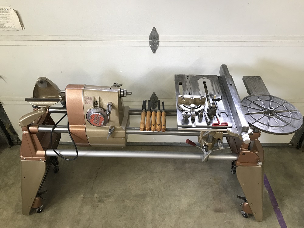

I have restored two Greenie Mark 5's (1956 & 1957) and a Goldie Mark 5 (Oct. 1960), none of which has a second slot.
I was just looking at the pictures of the Goldie I restored and it DOES have the extra slot. I checked the pictures of the Greenies I have restored and was correct that they do not have the extra slot. The 83 Mark V I restored does not either. I guess at my age it is better to know than try to remember.
IMG_0273 r.jpg (229.86 KiB) Viewed 23698 times

NICE job on the Goldie!!!!!!
