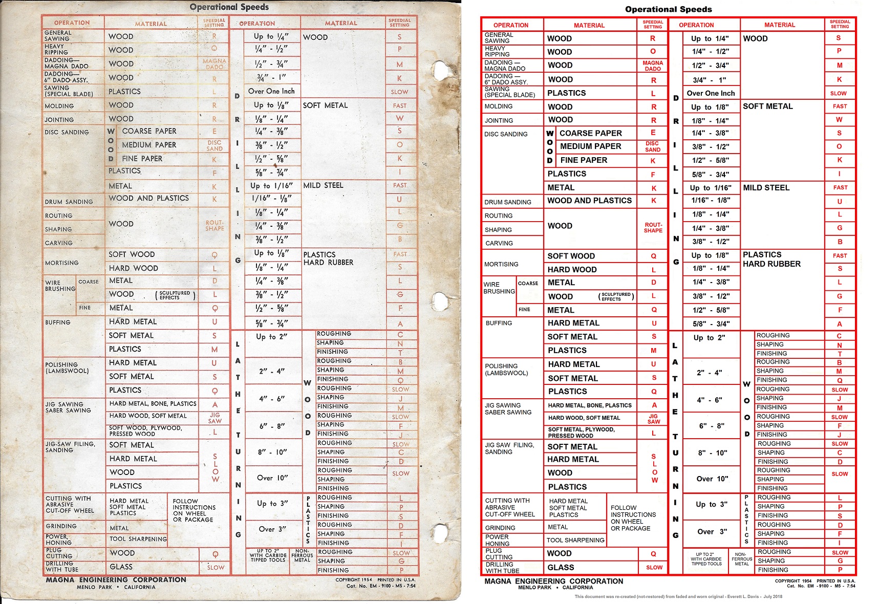

As many are aware I have been restoring early Shopsmith Manuals and other documents for some time.
Recently after restoring the original 1954 Shopsmith Mark 5 manual provided by Russ Chapman, Wiley Wells provided me a scan of version 2 of the 1954 manual. Wiley later provided me a copy of the missing back page Russ noted was missing, with the Operational Speeds Chart, present on his version 1.
The missing page was severely faded and worn. After attempting to do minimal restoration on the page, I determined that the result would not be up to my standards and still be hard to read for folks.
As I contemplate the restorations of subsequent Mark 5 manuals, and consider restoration of the same page (essentially) in each of them, I decided to simply do a full on re-creation of the chart, and just maintain the litho information on each version of that page, which identifies the entire Mark 5 manual version.
I tried to select a representative font and size to the original 1954 typeface used originally. One thing you will notice is the quotation / inch marks are vertical now opposed to slanted as in original typeface.
Posted below is a side by side comparison, and I have also attached a PDF of the chart which is now in 11 x 17 so be sure to instruct your printer to print it on the paper size you have if you print it.
I have proof-read it until my eyes blur. If you see an error, let me know and I will correct it in the image and the PDF, then after we are fairly sure it's right, I will add it to the end of the restored 2nd version manual.
Everett
Missing Back Page - Recreated opposed to Restored small.jpg (914.66 KiB) Viewed 7549 times

I can't imagine how long it took you to recreate that back page but it looks great. I am going to print the page you created and hang it next to my old greenie. Thanks for all your work.

Due to the quality of the back page from this manual I agree you go with the re-creation in this case. Original charts are still available on the 1st and 3rd edition manuals. The next two manuals I have, the 4th and 5th or 6th, (10:55 & 10:56) have the same chart also. The following one I have copyright 1957 4:57 has a different version of the chart. I printed a copy of your re-creation and will compare it later to my originals. I don't expect to find any problems knowing your attention to detail.

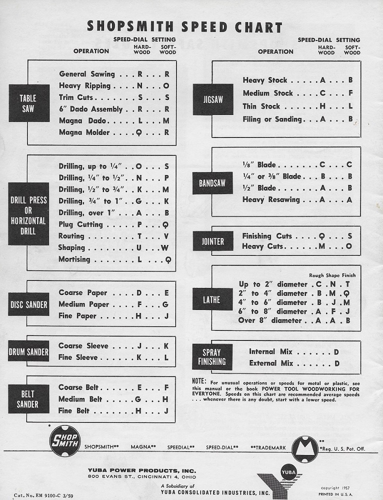

I compared the re-created version to the 1st and 3rd Edition Manuals, plus two following editions. It is so close to the 3rd edition that if a clean copy was next to it they would look so close to being the same it would be hard to tell the difference. Great Job :) I did find the letter "Q" in the originals harder to tell they were a "Q" rather than an "O" on a short stick. Your "Q's" are much better. Of interest the lines dividing WIRE BRUSHING from COARSE and FINE do not exist on the 1st Edition's Chart. Glad you added it and that it is on the subsequent editions.
It is to bad they changed the chart on later editions of the Manual since it only covers working with wood as per the later version below. Less having to look for speeds inside the manual for the early chart.
Speed Chart copyright 1957 3-59.jpg (313.23 KiB) Viewed 7303 times
Chart as shown on the back cover of the 4:57 edition and the 3/59 edition shown above. Both copyright 1957.

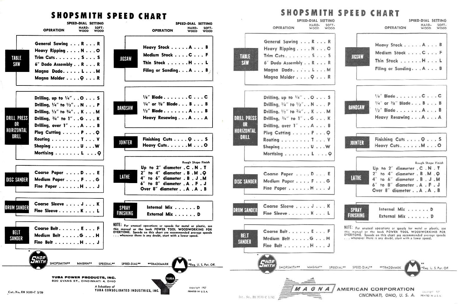

Essentially the same as my Goldie(1/62) version except Magna American replaces the Yuba stuff at the bottom.

Thanks Russ and James,
James I think your email system from Yahoo scaled back the resolution on yours. I sent you a private email to your other email account.
Here are both Russ and yours with the same retouching applied to both. I am not through with either.
I prefer 300 DIP color scans on most stuff, 600 DPI on just the illustrated parts views.
Thanks to you both for helping me acquire scanned images to work from.
Everett
Speed Chart copyright 1957 - 59 and 62 Yuba and Magna American.jpg (462.25 KiB) Viewed 7279 times
