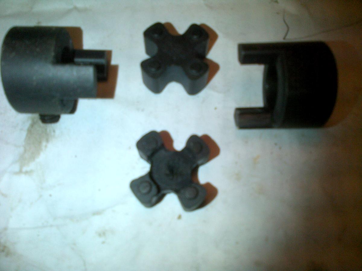

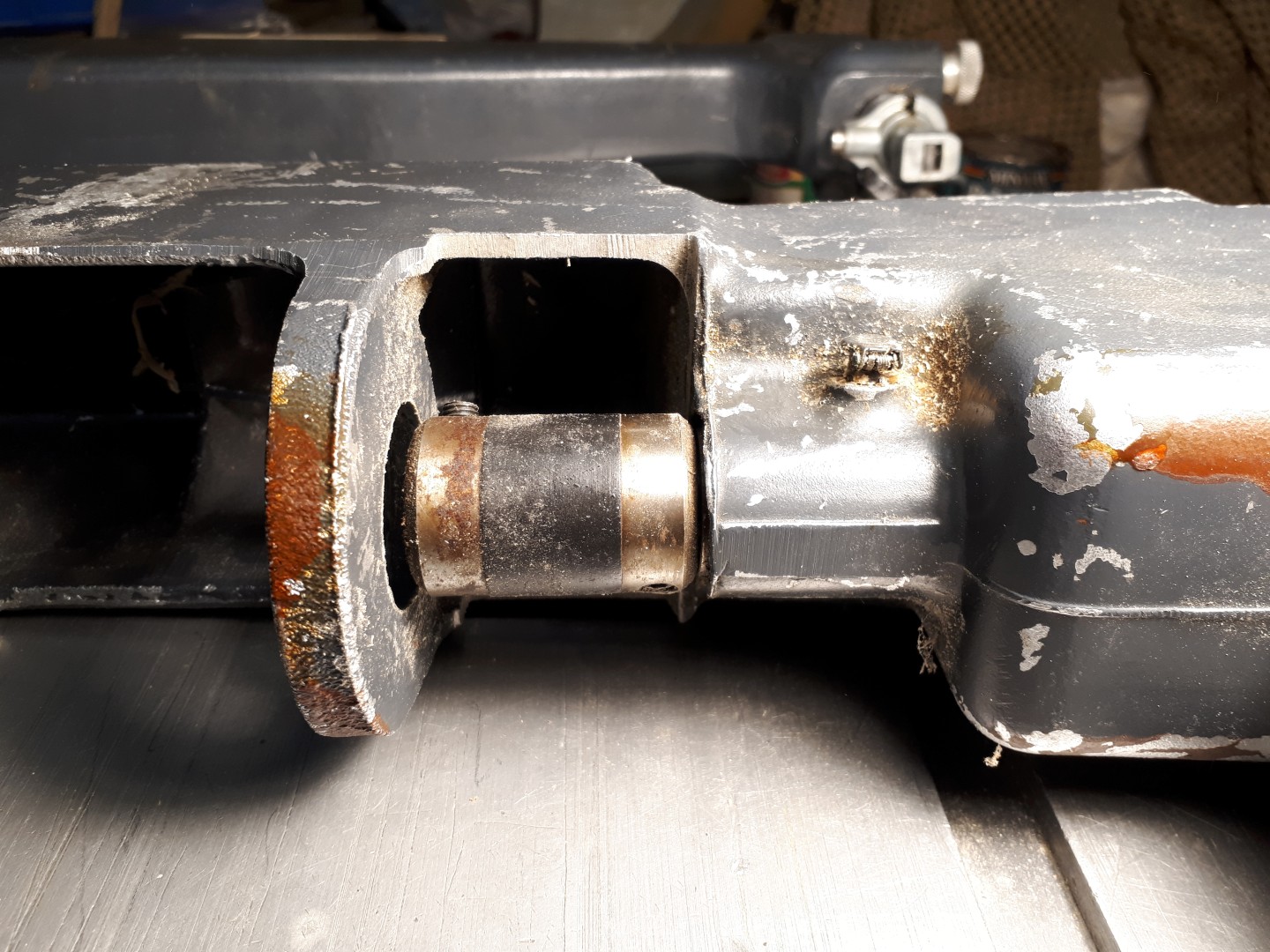

The original coupler looks like this.

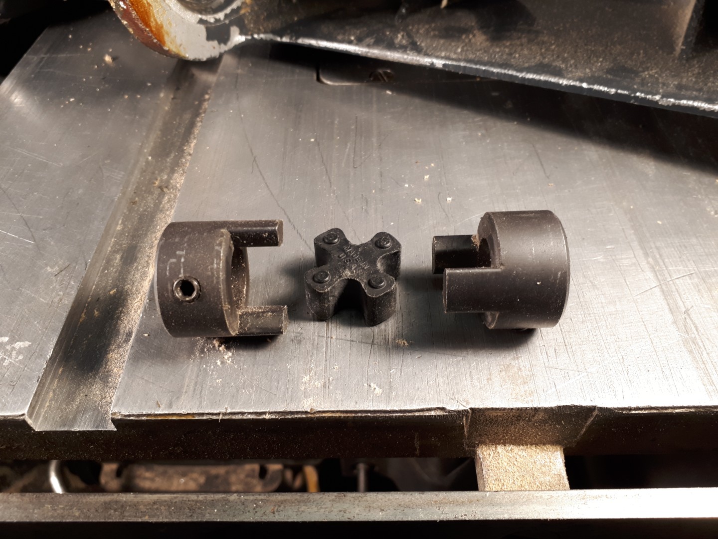

I have used the L50 Lovejoy coupler. Because of the way the A34 mounts on the 10ER, bolt on the left side and the quill advanced into the ring on the right side, the spider is too thick and one side of it's center will need to be cut away. I used a 5/8 Forstner to remove some of the rubber.
not a great picture but shows the lower spider cut away
I have not tried it, but I have read that you can use the larger L070 Lovejoy coupler, and you can get a spider with a hole in the center for that size.
