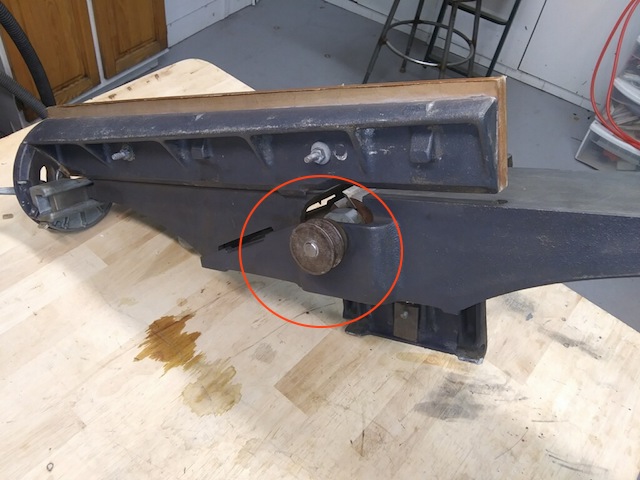

Does anyone know what size belt is used for the E4 jointer or replacement part number is? I uploaded this picture with circle for reference. Thanks in advance.

The belt is a 4L 320 or 32" belt. The pulley on the jointer is 1-3/4" and the motor is 5". The Jointer Mounting Kit Instructions are in the PDF below. Sorry the only 4E Jointer Manual I have is a not-so-good photo copy.
A Model 620 manual would also work for this Jointer. The early 620 is the same except for the Base (outfeed Table) which has the tube mounting holes and the two tubes for SPT mounting on the Mark 5. If anyone has a good original 4E Jointer Manual it would be nice to get a PDF copy of it available here.
