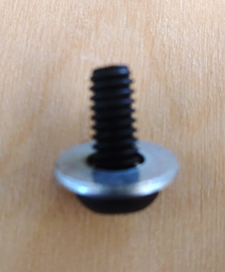

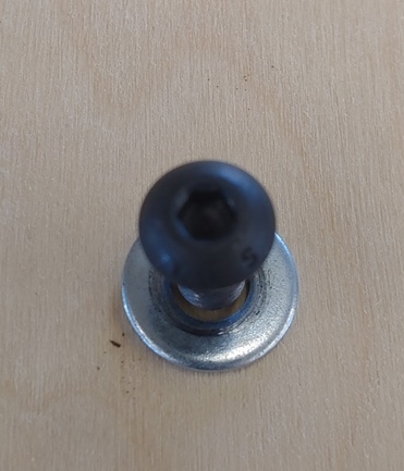

The new Belt Covers have the holes already in them. The Belt Cover is part # 50423801 same as the previous number without the guard holes. The website still shows the old cover without the guard holes. The Mark 7 Manual shows the cover with the guard holes. I upgraded my 520 to a Mark 7 but still have not added the shaft guard and have not decided for sure if I will. I have not see a new cover to see how the screws are secured but I will use blind nuts in the cover to attach the guard if I do add it. I hope this is helpful as a way to install it.
Re: Auxiliary spindle shaft guard
I don't think there are blind nuts on the new Power Pro belt cover. I bought a full up head stock in Dec 2012 and was deliversd in Jan 2013.chapmanruss wrote:The new Belt Covers have the holes already in them. The Belt Cover is part # 50423801 same as the previous number without the guard holes. The website still shows the old cover without the guard holes. The Mark 7 Manual shows the cover with the guard holes. I upgraded my 520 to a Mark 7 but still have not added the shaft guard and have not decided for sure if I will. I have not see a new cover to see how the screws are secured but I will use blind nuts in the cover to attach the guard if I do add it. I hope this is helpful as a way to install it.
I just went out and took the pictures of the screw. The belt cover is very robust and steel not aluminum. I don't see a problem with the screws. The guard is not an item subject to stress and if you take it off and on all the time maybe you should just leave it off. After all we have lived without it for close to 70 years.
Sorry, the first picture is out of focus.
