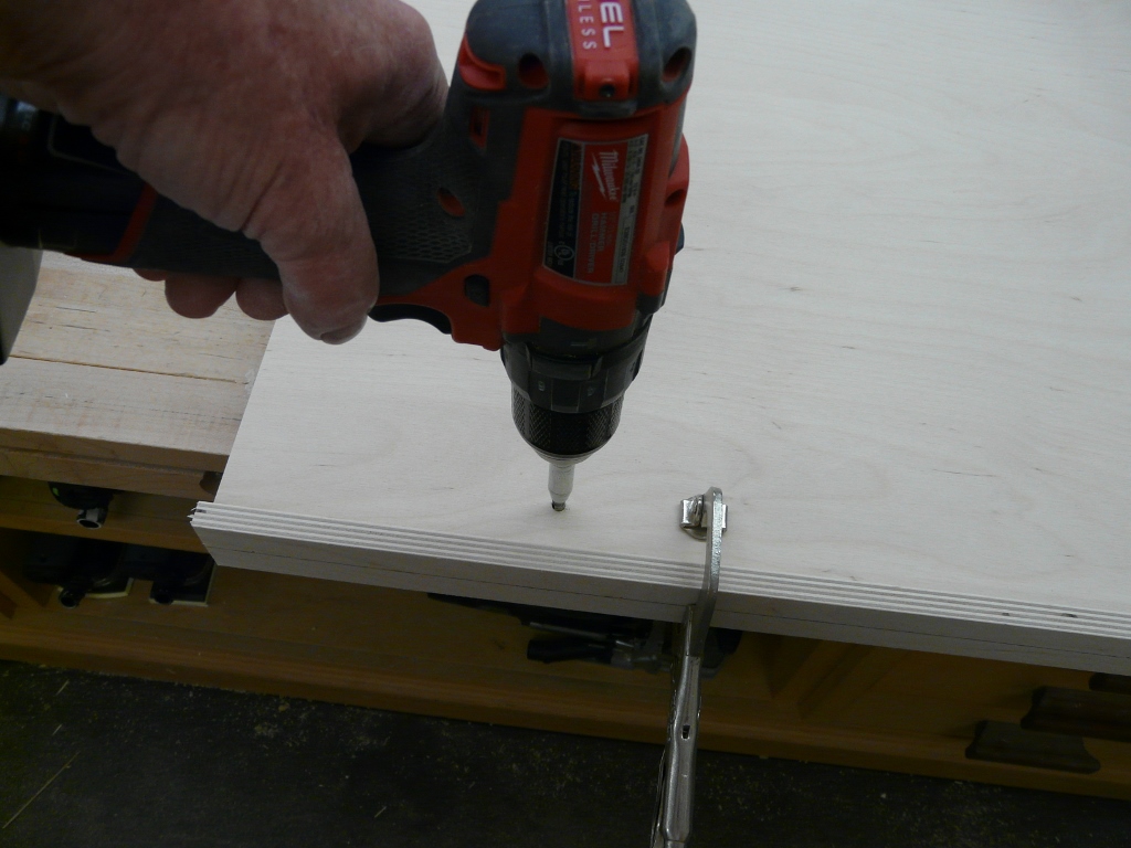

Drawer runner drilling jig.
Remember this you'll need it later. ;)

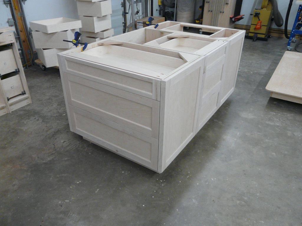

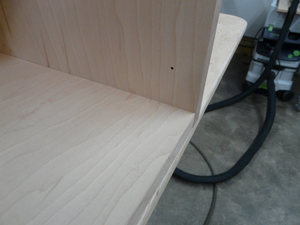

See I told you. Pre drilling as many things as you can before assembly makes things go a lot faster.
Time to set the drawers and doors to finish the island.

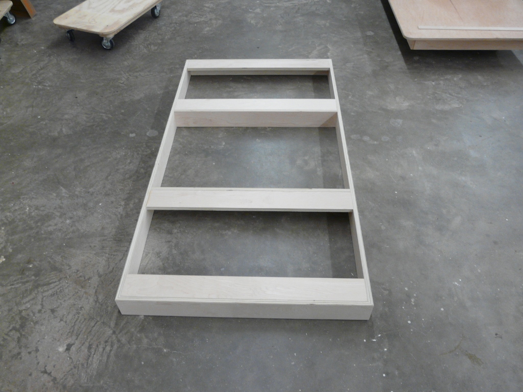

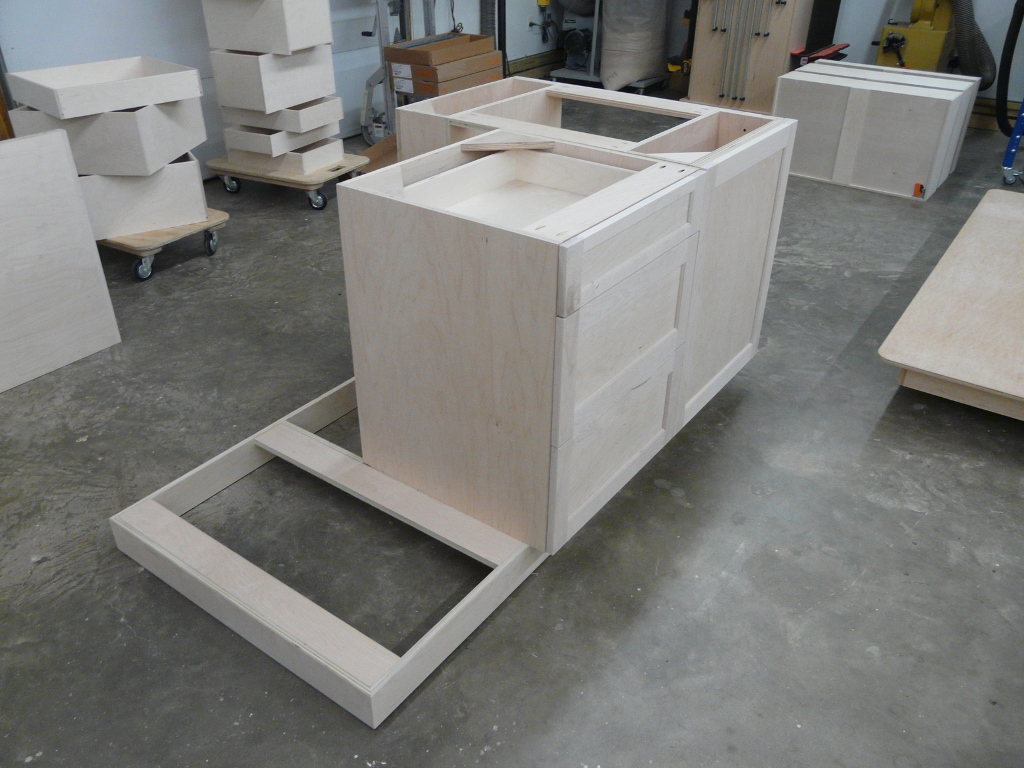

This is a base I built while you wern't looking.

This consist of 3 cabinets, two panel ends and a back panel along with the base.

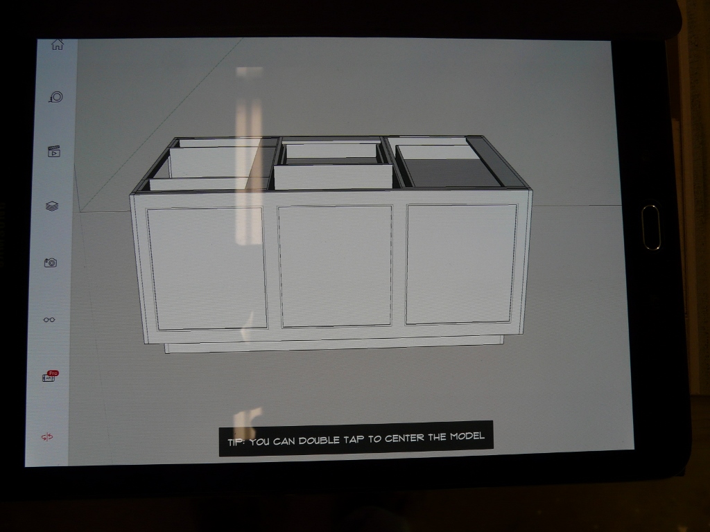

Looks almost as good as my Sketchup model.
If you use Sketchup and haven't tried Sketchup Viewer it is hand to have on a tablet or phone for shop reference.

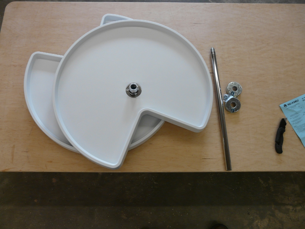

It seems like Rev a Shelf changes these about every year or so so my old template no longer works with the new hardware.
No problem I'll just glue the new template to a board and save it until the next change.
Next step is to drill 1/4" holes in the template on the Mark 7 to accommodate a Vix bit.
And finally cut the notch in the template to align with the front of the cabinet.

Now we can drill for the Lazy Susan hardware.
The lower hinges have to be offset to clear the bottom tray.
