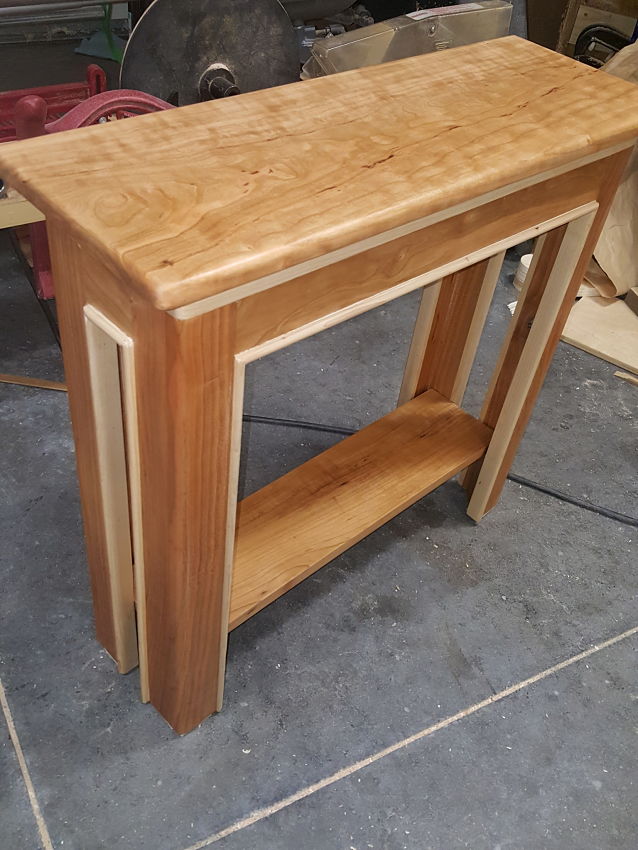

My daughter has moved into her own small apartment and I have been tasked with making tables for the living area. I need to make a TV stand and coffee table. The TV stand will only be about 10" x36" while the coffee table will be about 20" x 40". She chose a design from an old Woodsmith magazine made from cherry with maple accents. I have made an end table as a prototype. I am not sure if I like the width of the beading strip and the reveal frame. I am thinking of cutting them down to about half their width.

thunderbirdbat wrote:My daughter has moved into her own small apartment and I have been tasked with making tables for the living area. I need to make a TV stand and coffee table. The TV stand will only be about 10" x36" while the coffee table will be about 20" x 40". She chose a design from an old Woodsmith magazine made from cherry with maple accents. I have made an end table as a prototype. I am not sure if I like the width of the beading strip and the reveal frame. I am thinking of cutting them down to about half their width.
Really nice Brenda. I agree with you on the above. They need to be a bit narrower.

The maple accents give the table a unique look.

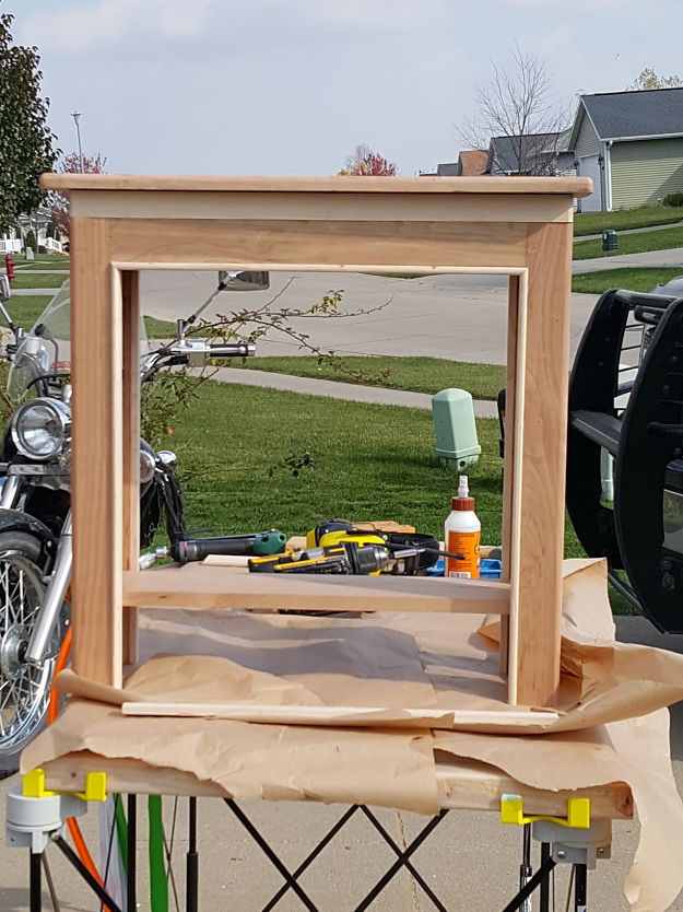

I think the bike needs to more proud in the picture. What is it?

OK I know. The workmanship on the table is perfect but I do agree alittle smaller on the bead would fit better.

kd6vpe wrote:I think the bike needs to more proud in the picture. What is it?
My husband's V-Star. My KTM is not visible in the picture.

Not sure if the 3/8" bull nose beading was to match the round over on legs and top but I think 1/4" or smaller would be better. I also think the maple reveal should only be about 5/8" or 3/4" instead of 1 1/4". The cherry legs and apron are only 2" wide so I believe that is why the maple parts appear too large.

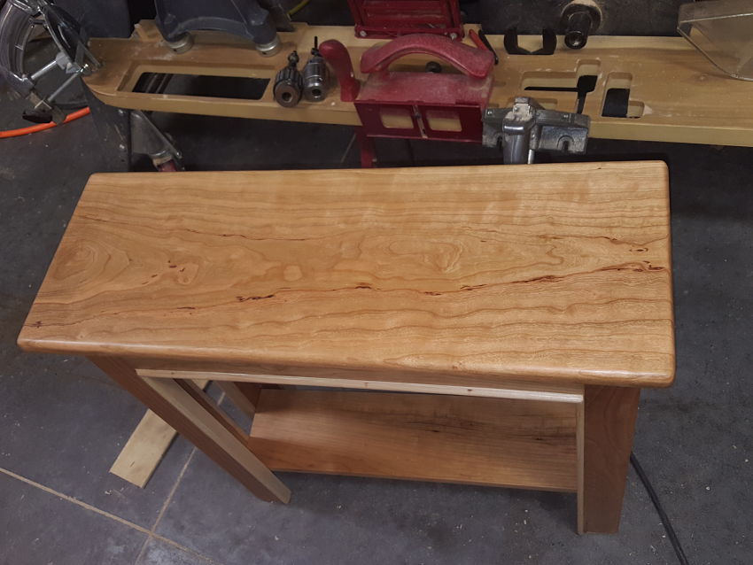

I finished the end table with a coat of shellac sanding sealer and then a few coats of poly on it. I like the look of the grain on the table top.

I love that cherry top, Brenda! Where did you find a board that wide? About 10”, I think you said?

BuckeyeDennis wrote:I love that cherry top, Brenda! Where did you find a board that wide? About 10”, I think you said?
I found several that wide at my local sawmill/lumber yard. The boards were also about 9 feet long. I had a couple that had interesting grain patterns that I set aside for the tops. The finished width is 9 in. for the end table and I have a couple boards that are S2S 11" or wider for the coffee table top and shelf that I want to glue up for a wider panel. The local sawmill/lumber yard does not advertise much. Local signs and a Facebook site but most customers are word of mouth. https://www.facebook.com/langhofflogandlumber/
