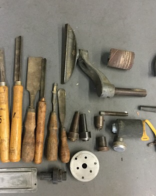

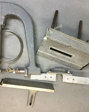

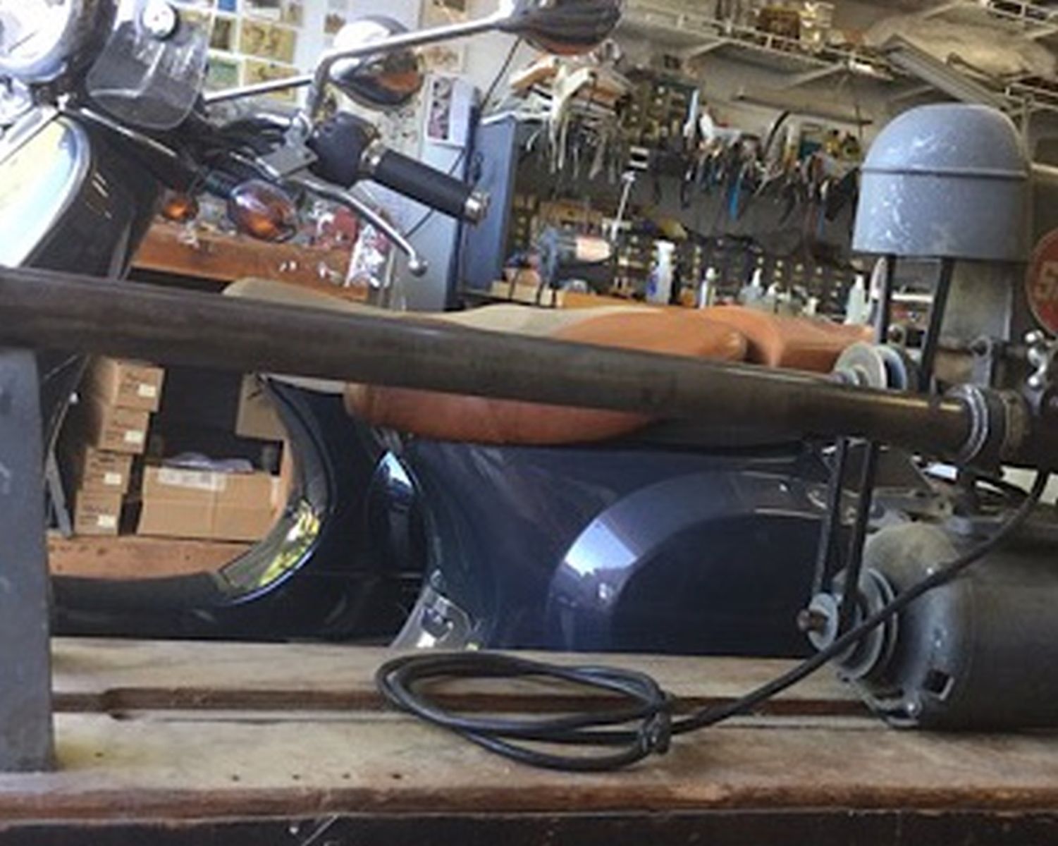

I’m having some trouble getting my pictures small enough to upload without cropping
but i will try again.
- 8C5B9DF8-261E-499E-8AD3-53A74245CB06.jpeg (54.49 KiB) Viewed 8147 times
- C86DA226-8DC7-49FA-9B17-DC670C6115A5.jpeg (38.33 KiB) Viewed 8147 times
- 5455D113-0F82-46D0-9A6E-B4C21E4922AF.jpeg (40.42 KiB) Viewed 8147 times
