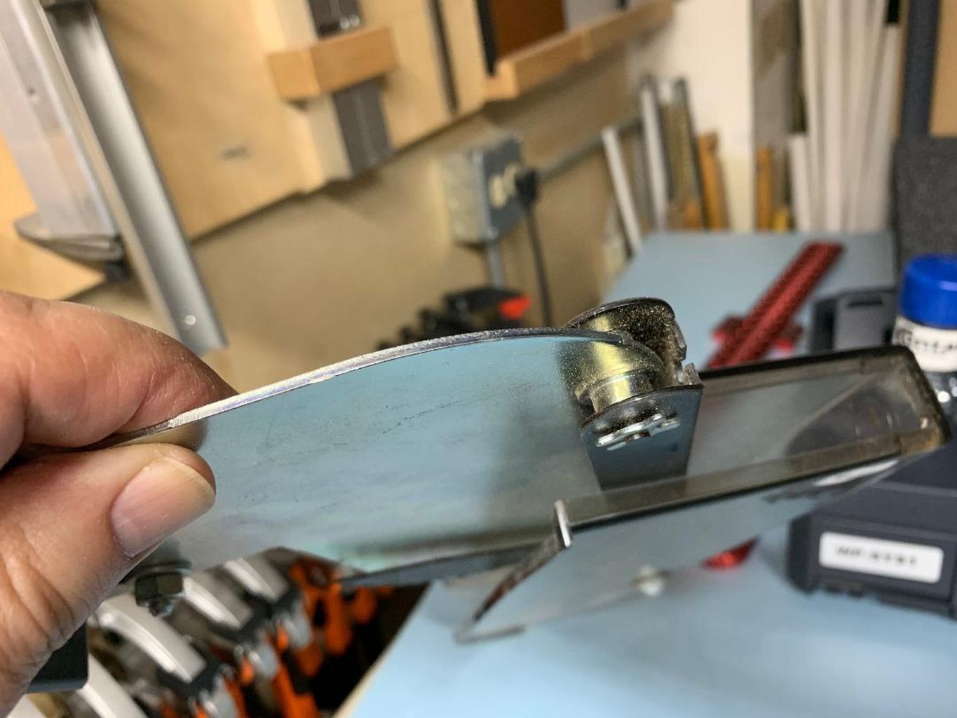

Upper Saw Guard Play.
I had a lot of excess play in the clear plastic upper blade guard. I nulled out 80% by installing extra washers and shims at the rear pivot pin. Where plastic meets metal. Be sure that when using shims and such to put equal numbers on both sides of the pin. The small clips went on nice and tight. That was a huge help. It sits equal over my blade. When evaluating the mount I discovered the knob was missing. It had a bolt of unknown origin twisted into it. After I cleaned that up I installed a knob I had. It went tight quick. Riving knife is spot on. Way Better, much safer.

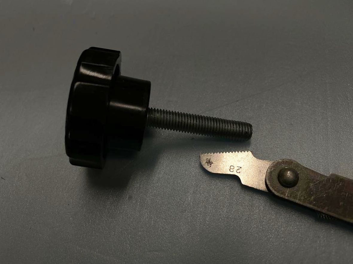

Can anyone confirm the threads on that knob? I used a 1/4 20 thread knob. It went in weird tight?

Try 1/4 - 28??? :)
Re: Upper Blade Guard / Miter Gauge Issues// FIXED
Glad you have thing working again. How ever the knob is 1/4-28 so you might well have damaged the threads.......
Here are a couple of more pictures that might help to identify what might have been different then stock, ie modified for some reason??

Thanks for the heads up on 1/4 28. That was the trick! I cleaned up my threads and the new knob went right in. Clean and tight. Thank You for that.....
