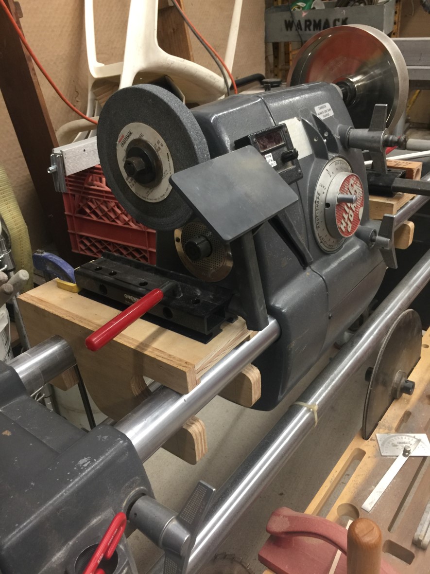

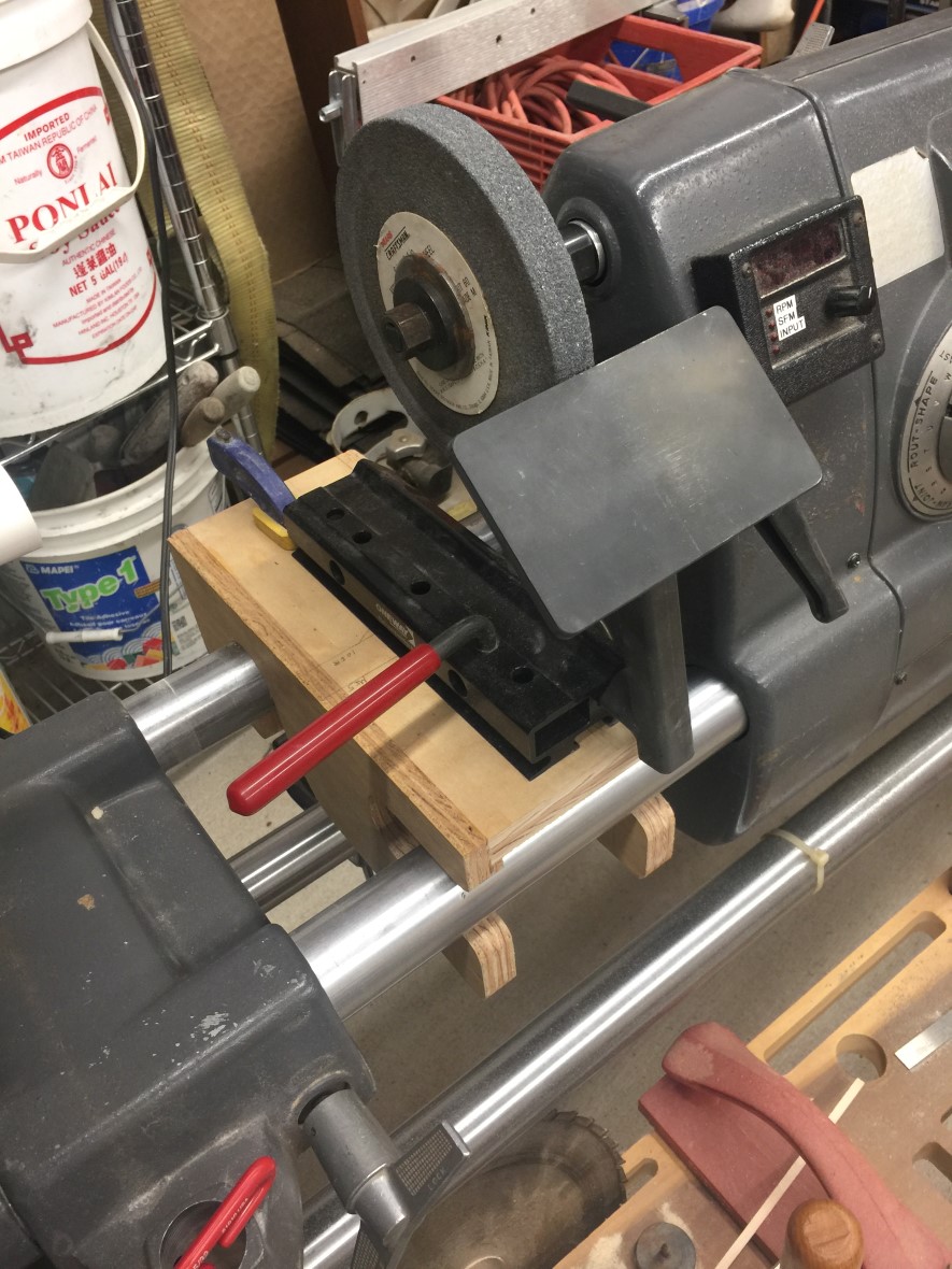

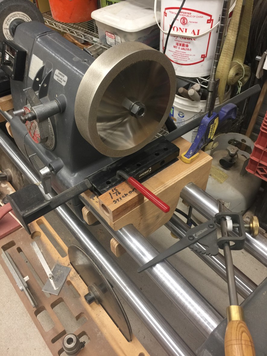

Got a Wolverine sharpening jig set up on my MarkV and got a CBN wheel. I will get a regular 8" wheel for rough grinding on the left side. I still need to come up with something to protect the waytubes. I clamp the wood bases so they don't slide and everything is solid. The left hand jig is notched deeper and will work on my 10ER also. I am still learning to use the Wolverine vary grind set up and I'm very happy with my infinitely variable speed grinder :D Thank you Shopsmith!

Deeper notch works on the 10ER
IMG_0290 (Custom).JPG (236.07 KiB) Viewed 19760 times

Which of the mandrels are you using for the CBN wheel

tenbears wrote:Which of the mandrels are you using for the CBN wheel
The mandrel is the 505506 5/8" Molder/Dado Arbor
