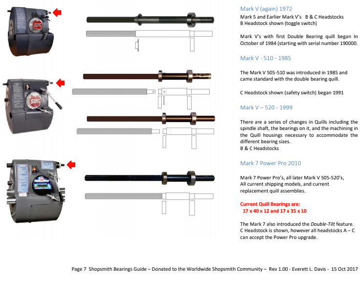

There are three sources of modified quills we all know of. Bill Mayo put out 4 different variations, which included modification to the quill housing to allow a bearing to be inserted from the spline end, Hog Winslow has a series of modified quills, and of course Skip Campbell offers them. You can even see a video of his modifications on his site.
Jacob Anderson has a series of bearings he sells, but to my knowledge he has not altered the quill assemblies. Others have.
There are variations in the spindles as some are two piece pinned, some two piece interference fit, and one piece.
It is the reason I say examine what you have and measure. It is discussed in some detail in the Shopsmith Bearings Guide I wrote in 2017. If one bought their unit from the Mothership, then Shopsmith can generally provide you the bearings based on the serial number.

Very true. I was not thinking modified but they do exist.everettdavis wrote:John,
Everett

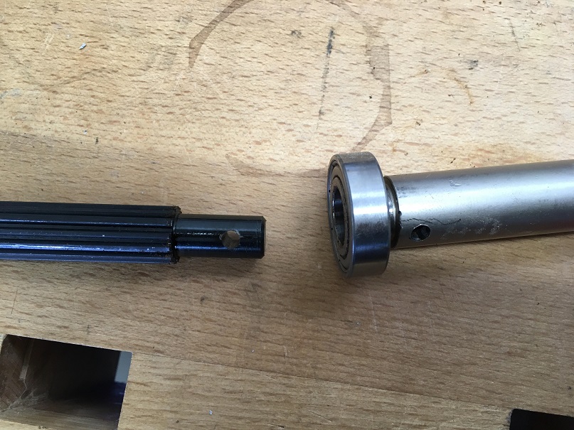

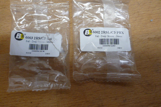

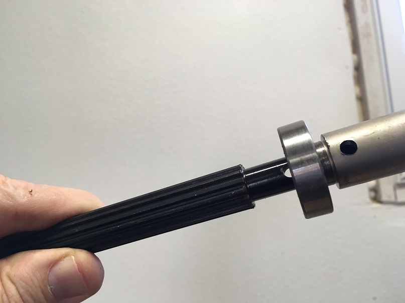

My quill was a two piece unit as show in the chart above. As mine is an 1986 model it's the second one down. It's held together with a roll pin that must be driven out to remove the inner bearing. Once the roll pin is removed and the shaft is separated into two pieces the inner bearing can be removed. It cannot be driven off the shaft over the splines, the shaft must be separated. I took the bearings and short shaft to my LBS (Local Bearing Stockist) and they had exactly what I needed, just under $20 for both bearings.
6002 and 6003 size, I went with fully sealed:
- P1050340.JPG (141 KiB) Viewed 17685 times
- quill 1.jpg (201.53 KiB) Viewed 17685 times
- quill 2.jpg (76.87 KiB) Viewed 17685 times
