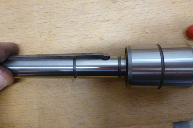

Re: Need help changing the belts on my Greenie
The bent end of the key sets in the hole at the end of the keyway:
- P1050343.JPG (137.5 KiB) Viewed 15206 times

Wow thank you for the picture, someone apparently put that key way in rotated 90 degrees. The keyway was sticking out to the side instead of down into the shaft. It was extremely difficult to get the sheeves apart. I'll take it back out and bend the end down into the shaft like the picture.
