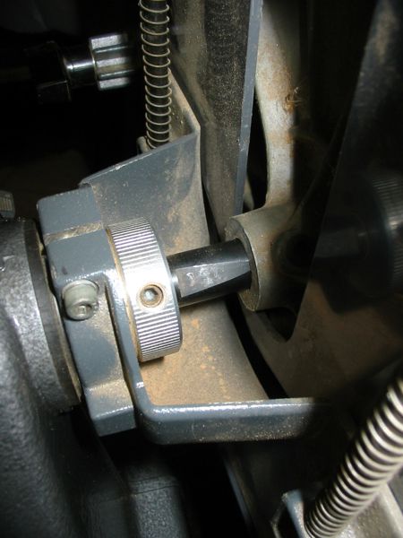

At this point in time I don't have a 500 length hub on any of my local disk sanders. I do have an old hub from the ones I had to replace but I'd rather not have to exchange them just for pictures.
If someone with a 505/510/520 and associated bottom guard, and, one of the sanding disks with the short hub could take some pictures for us that would be great. I'd like to see the sanding disk out far enough from the plastic that it could be used that way, then a shot of how close the hub come to fitting.
I'd like to see it in pictures rather then words but if you can't take a picture a verbose story will do.

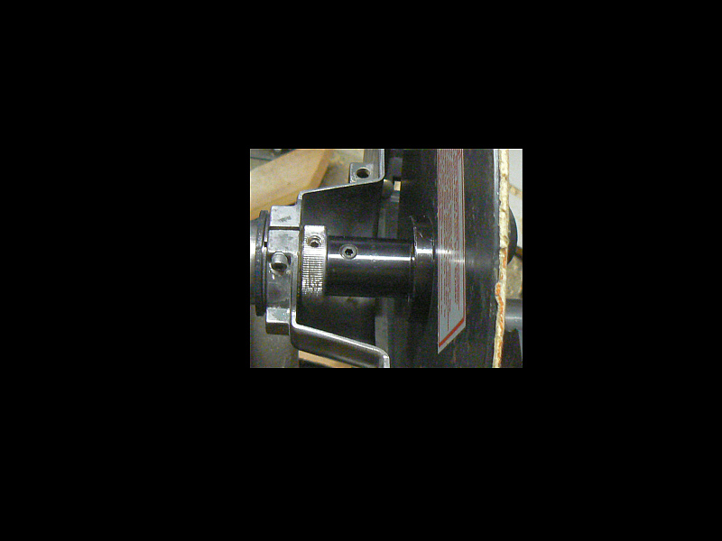

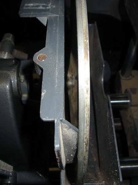

Here are a few shots of the aluminum disc and a short hub for the steel sanding disc (leftover from a conversion to 520).reible wrote:At this point in time I don't have a 500 length hub on any of my local disk sanders. I do have an old hub from the ones I had to replace but I'd rather not have to exchange them just for pictures.
Dust collection without the guard is not dust collection......
First the aluminum disc, outboard view......it is positioned up against the lower guard.
[ATTACH]24521[/ATTACH]
As viewed from the headstock side, note the gap.
[ATTACH]24520[/ATTACH]

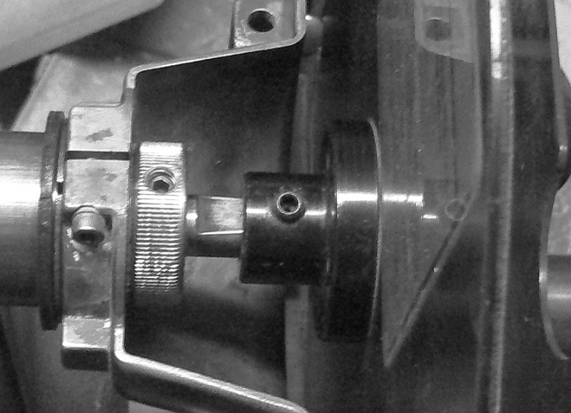

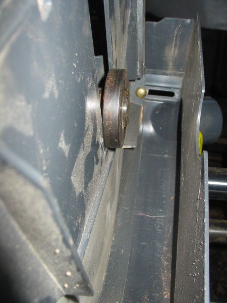

This a a 500 steel hub for the steel sanding disc....again it is positioned up against the guard.
[ATTACH]24523[/ATTACH]
The hub viewed from the headstock side.......another fail!
[ATTACH]24522[/ATTACH]
As noted in post #4 of this thread, the shorter hubs and saw arbors will not work with the new 505/510/520/7 saw guard systems.

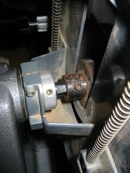

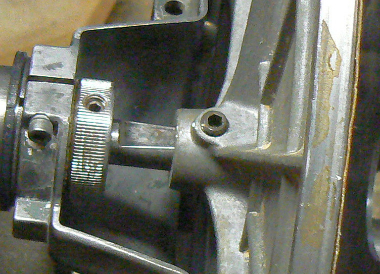

Sanding disk arbor length with dust shield.
No surprises me thinks. DC 'guard' was a blade guard in a previous 'life'.
First the 'normal' long arbor.
[ATTACH]24524[/ATTACH]Did something wrong in Irfanview to create this???
Yes the short arbor will not work.
[ATTACH]24525[/ATTACH]
Nor will the older aluminum ones.
[ATTACH]24526[/ATTACH]
I think we can come to the conclusion that the guard is the reason for the longer arbors, and that the positioning sleeve on the way tubes was sized to accommodate both the longer arbors and the headstock/carriage spacing and the new blade slot location relative to them both.
With no 'guard' for dust collection, any of them will work off the left side of the table.
Using the saw blade off the side of the table is definitely NOT recommended!:eek::eek::eek::eek::eek:;)
P.S. Rob posted as I was creating this and I did not notice until I posted this. Anyway more is gooder!:rolleyes: And I did promise . . . .

I sure hope this thread (which I somehow missed) resulted in a clear understanding for everyone. It confused me but that does not matter because I do not have any short hubs.
Relying only on the many terrific photos that were posted, I conclude that use of the short hub should be limited to the 500. Stated differently, the short hub should not be used with a 505/510/520.
The short hubs cannot be used with the dc guard.
They can be used with any model SS same as before the dc guard was made available.
