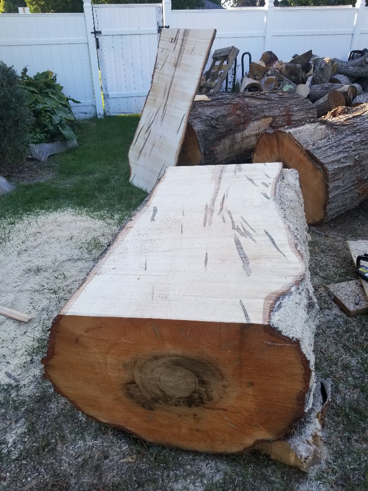

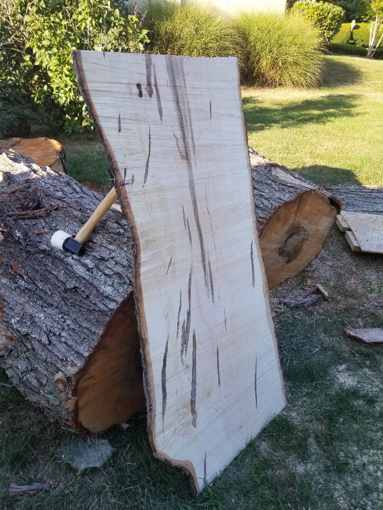

Much better day today!

Nice!!!

Wow! That is gorgeous!

Wow! Great looking board and judging from that one it looks like you are going to get a bunch of nice boards from those big logs. Will be interested in seeing pictures of how you stack and sticker for drying.
