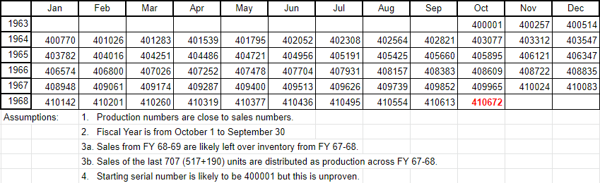

Re: The Missing Mark 5 Serial Numbers
Here is my guess for the Mark VII serial number history. Comments Please
- Mark VII Serials v1.1.png (29.03 KiB) Viewed 19397 times
