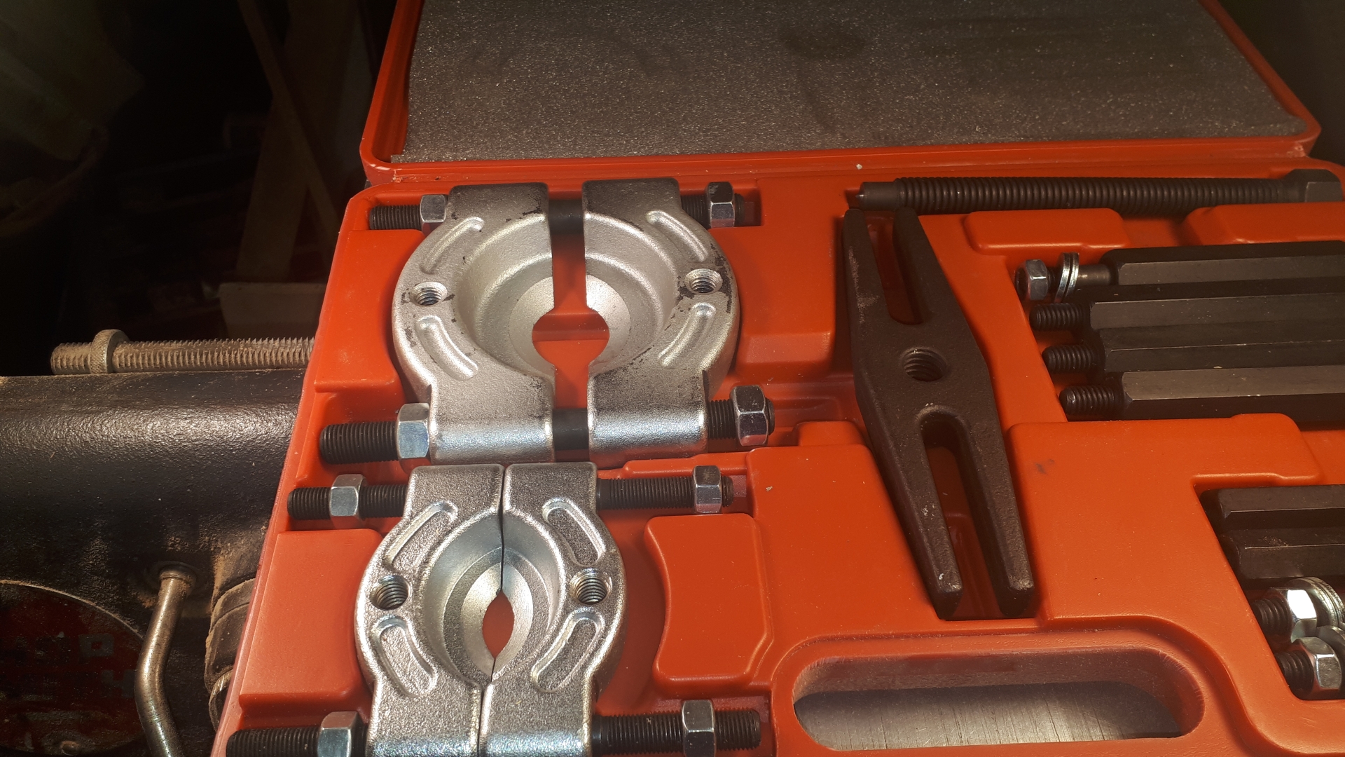

benmcn wrote: After soaking it for a day I used a technique described by everettdavis. I took the base of my HF puller, attached it at the separation point for the drive center and the drive sleeve and then slowly tightened all of the bolts. It acted like a spreader and the drive center finally broke free.
Back a few pages when Ben suggested using the base from the HF puller. I believe he was referring to the bearing splitter part. (left side of picture)
bearing puller.jpg (1.4 MiB) Viewed 8538 times
Seat the sharp edge between the arbor and the spindle knob, or between the spindle knob and the quill. Then tighten the nuts to wedge the arbor loose. Also once it is seated you can attach the puller and push against the splined end of the quill. :)

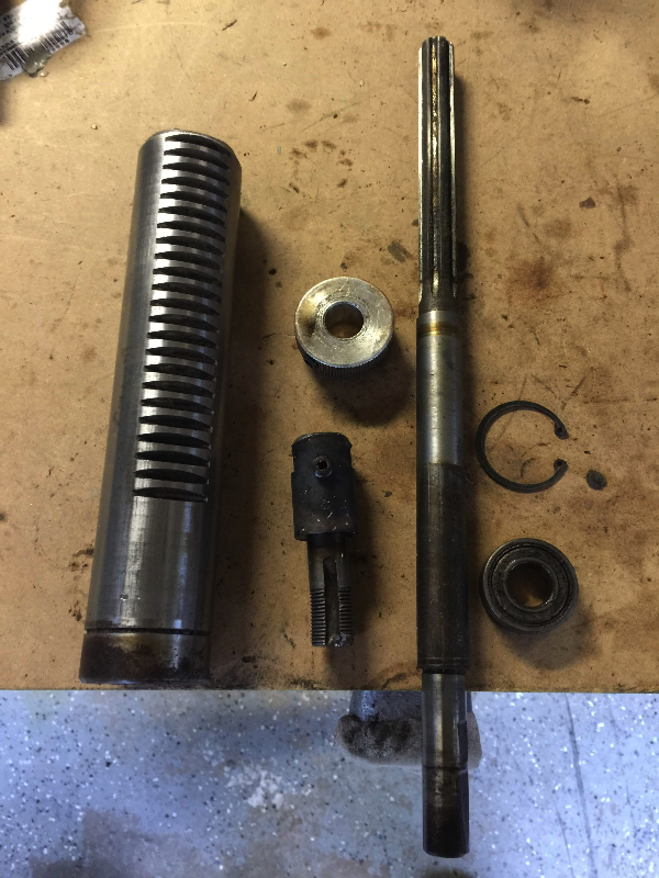

Hi guys,
I wanted to give you an update on my situation. I have a friend that I know through my local AACA chapter, who is the shop foreman at my local Ford dealership. So I showed it to him and he said, "Sure, I can get that off. Bring it by tomorrow and we'll use our 25 Ton press." ;-)
So I took it over and even with about 10 TONS of force on it, it didn't budge, so we torched it and tried again. No dice. Finally, after breaking for some lunch and trying again we were about to give up, but as we took it off the press, we noticed that it had moved. But instead of moving off the shaft, it was rotating and the end of the shaft was rotating with it, but the other end of the shaft was NOT turning.
OK, well, we thought that we'd broken the shaft. But no! This is where ignorance and lack of familiarity cast a glaring light on my efforts. It turns out that the adapter INCLUDES an extension of the shaft that has the threads on it. I thought that the adapter was separate from the visual part of the shaft. So all that pressure we were using was really only compressing a single piece of metal instead of pushing it off of the shaft itself. No wonder all that pressure wasn't having an effect! It was, of course, at this point that I planted the palm of my hand into my forehead. All I needed to do was PUSH the adapter off instead of trying to pull it off and it probably would have come off much more easily. <sigh/>
Anyway, it's off. Thank you to all of you for your help! Now, on to the next part of the challenge. Hopefully, by the time this is all over I'll have a clue. ;-)
