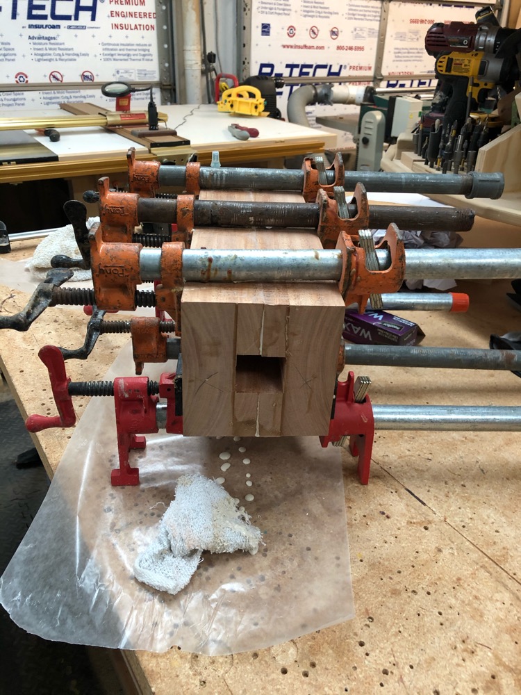

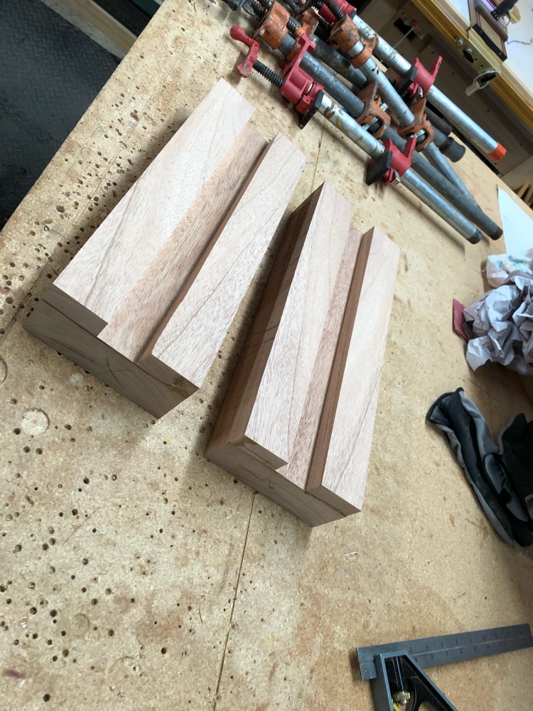

Holding your liquor
The next project is a redo on the liquor cabinet. It will be a combination of mahogany and alder. Part of it will be three large turnings out of mahogany in a tulip style to hold the platters which will be mounted on a vertical turnstile. The basic dimensions of the turnings are 15” diameter and 16” high. I am laminating them out of 8/4 African mahogany. The platters that will sit on top them will be alder. Today I started gluing up the first of the turnings.

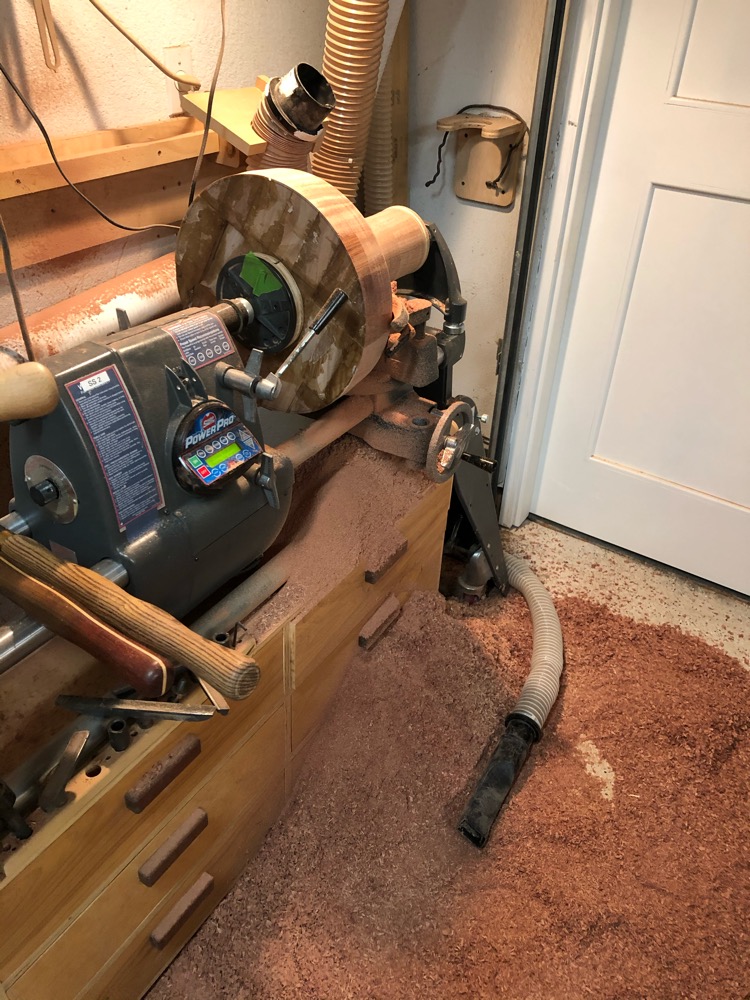

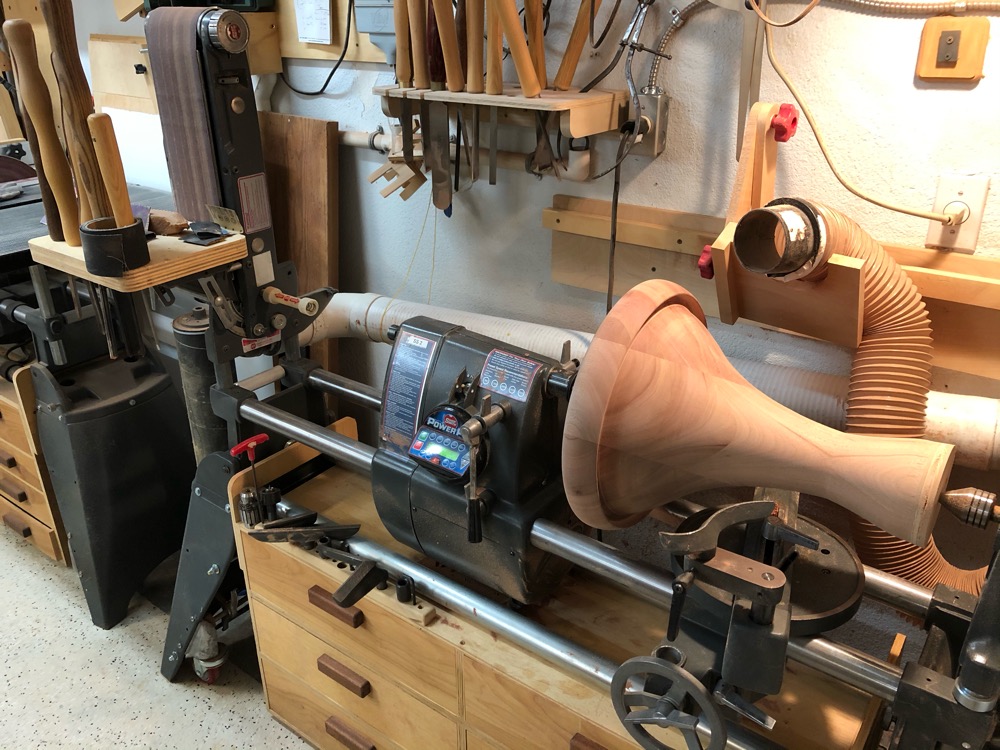

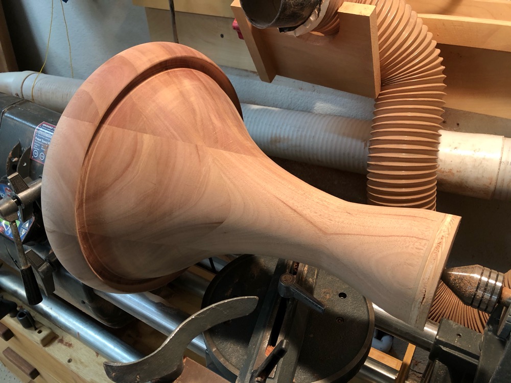

masonsailor2
- Posts: 1564
- Location: Las Vegas NV
Re: Holding your liquor
After a lot of carving with the bandsaw and sawzall I got the blank mounted on the SS. The PP did not like the slow speed and 50lbs of wood but it got the job done. Once I was able to get the speed up to about 650 rpm the motor stopped making that annoying noise. It is roughed out and now I can do the final shaping. I have two more of these to make but hopefully I will be able to speed up the process.

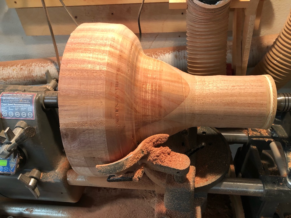

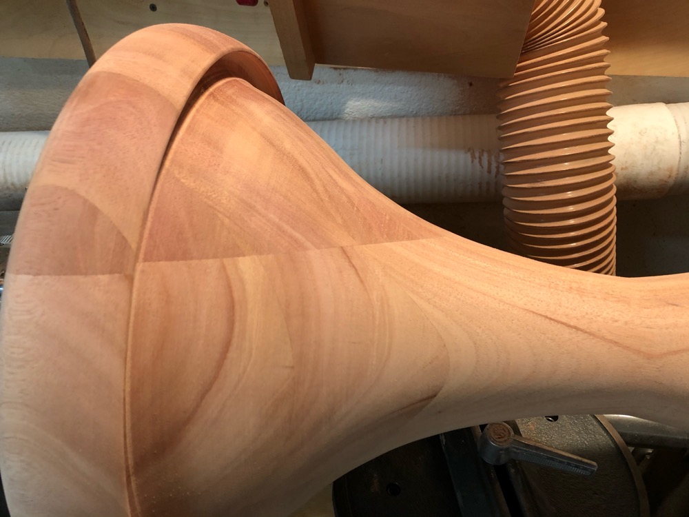

Except for final sanding first one is done.

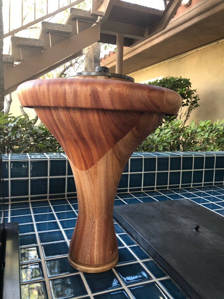

The first tier turning is done. We tried to use the different colored mahoganies to get the overlapping petal effect and i think it worked pretty well. Now for the other two tiers.
