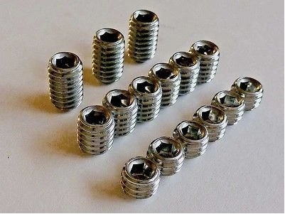

Was using my gear with the jointer in place and doing table saw operation and had both the set screws on the saw blade and on the jointer drive hub come loose. The jointer suddenly bogged down while making a cut and I found the saw blade arbor set screw loose. I did find nylok set screws on line but I will have to buy 100 pcs at $40 plus for a few screws. Does anyone have a source for these type of screws?

I just use blue loctite.

Blue loctite will work but on the sawblade arbors and the drill chuck the screw is continually removed and replaced. Don't know of blue loctite would survive continual loosening and tightening. I once made a locking set screw by drilling a hole through the screw body and forcing a piece of weed whacker string through the hole and cutting it flush. It seemed to work but I lost it when I sold an extra sanding disc to a friend. Guess I will have to make some more. This seems to be a bye product of the Power Pro speed regulation.

Loctite seems to hold up for me. None have failed to hold, yet. If a set screw ever does becomes loose, I'll just coat it again.

Time to upgrade to the stainless steel ones from rt bolts:
https://rtbolts.myshopify.com/collectio ... ools-other
