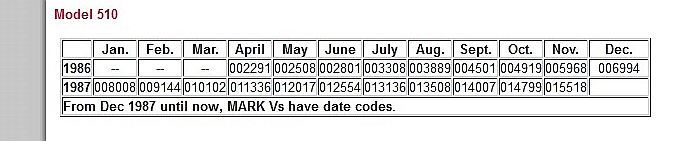

Hey. I know this is a seriously old thread. Hopefully someone is still on here.... It seems I have the same kind of machine here. Model Number 555510 with serial 03188. So maybe this was made 03/18/1988? It has the textured paint and double quill bearings and the emerson 1 1/8 110 motor. I picked this thing up off craigslist for 400$ and I am rebuilding it. This is my first shopsmith. I have ordered all new bearings and belts and some other odds and ends parts. It came with what I think is the very basic table set up, and a band saw. I needed the to get the drill press chuck and the saw arbors. I was told this was a 1982 or 84 model but the numbers just don't match up and neither do the internals once I did the complete tear down. Any thoughts on what type I have here would be cool. I think I got a pretty good deal. It ran fine just seriously loud, thats why I decided to tear it down and tune it up. The motor by itself almost makes no noise.
Re: year and model of mark v
June/July 1986. No it is not a date code.
510 sn.jpg (62.57 KiB) Viewed 3303 times
These do be noisey due to the Reeves drive sheave slop.
'basic table' Could it be a 510 headstock on a '500'?
