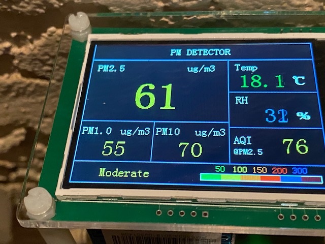

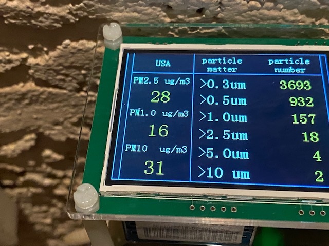

Yeah, this Amazon counter is definitely a great value. I haven't had it long, but if it holds up, it is worth every penny IMHO. Once you have one, I think you will be very happy that you did. There are some woodworking tasks that I thought were "cleaner" than they are and vice-versa. My ceiling mounted air cleaner is noisy on high speed, so I am checking in periodically on the Dylos counter in the shop and I adjust the air cleaner speed up/down to try to keep the air breathable while I work. Since I have had it and use this technique, I seldom have the particle counts get high enough to cause me allergy problems. Before this, I would sometimes have to leave the shop and go in because of sinus problems. Yes, I can detect high particle counts unfortunately, but I prefer to catch it on the Dylos before it gets out of hand. I only break out the PAPR for high particle count activities like sanding, but given my CT26 performance, I may have to rethink that...
Ed,
Did you set the counter for particle count display or PM2.5 display? The PM2.5 and AQI page isn't that useful, unless you are monitoring indoor air quality in the home and want more of a stoplight chart (red, yellow, green) for what your air quality is. I find the actual particle counts a lot more interesting and they update/change quicker. You will see more movement in the particle counts, particularly since this Amazon counter has an instantaneous readout without averaging. Yes, it will fluctuate if dust is kicked up, e.g. walking around and doing other tasks. I can't say my shop is perfect, but I do get good results in my shop running my ceiling mounted JDS air cleaner. It does a really good job of scrubbing the air. Sometimes I open the garage doors and blow out the garage with my mini leaf blower. The particle counts get really high doing this but drop fast with the air cleaner running. In between, I vacuum and clean up the best that I can around the shop. Invariably there will be some residual fine dust always on the walls, on the floor and ceiling, on workbenches, tools, etc. for any shop. However, using the JDS air cleaner on a regular basis, I don't see a big uptick in particle counts when I walk by the Dylos counter. If on the other hand, I don't run the JDS enough, I can quickly see the particle counts rise just by walking by it. That is why when I did the Festool measurements that I posted earlier, I ensured that the shop was scrubbed pretty good, then with the JDS turned off, heat turned off, etc., that the counts really didn't move by me walking by it. I also ran the Festool CT26 for several minutes with nothing at the hose input, just to make sure the blower exhaust wasn't kicking up any dust that was getting to the Dylos counter (it wasn't, so I had good confidence my measurement was capturing fine dust escaping from the CT26 and not just shop dust getting kicked up).

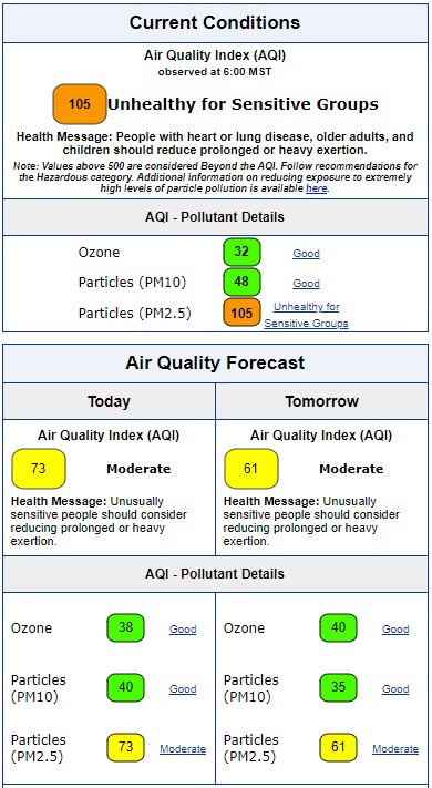

This is why I can't work in my driveway. At times, the particulates are far greater outside of the shop than inside of it in Phoenix area. Too many people burn fires in their fireplaces here on no burn days. This combined with construction site dust & smog and sparse rainfall create high particulate counts in this area. We get a lot of weather inversions, so instead of the smoke & other particulates going up in the air and blowing away, it instead falls to ground level and stays there. Air quality in my shop and house are significantly better than outside, but it takes a lot of diligence with air cleaners. Walking outside smells like walking into a chimney here this morning...AQI of 76 outside my house this morning. :(
Particle Counts Outside:
AQI Outside:
Phoenix AQI Forecast for Today:

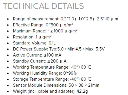

Just wanted to give some updates on the Amazon laser particle counter that Ed mentioned. I have been running it side by side to my Dylos counter for comparison. The Dylos counter readout gives particle counts from the 0.5um and 2.5um sensors that are running averaged (10s buffer) and the counts equate to the amount of dust particles measured in 1/100 of a cubic foot. So, multiply by 100 if you want to normalize it to how many particles in a cubic foot of air. The sensor module inside the Amazon counter is model # PMS5003 and is manufactured by Plantower (http://www.plantower.com/en/content/?109.html). Being a Chinese company, the particle counts are in a different volume since they are metric over there. From the specs, it is counting for 0.1L volume, or about 1/3 what the Dylos is counting in. This combined with the fact that the Dylos averages and this one doesn't, means I am comparing apples to oranges unfortunately :( ...though in theory multiplying the Amazon counter measurement by a factor of ~3 may normalize it to the Dylos reading. Still the averaging makes it hard to compare these two...unless I sample it with a computer - which can be done because of the following:
A local source for the laser counter module by itself (no MCU or LCD display) is from Adafruit (https://www.adafruit.com/product/3686). I might pick one of these up and do some programming with it using an Arduino. It would be nice to build some custom versions of these that I can network (and datalog) in the house/shop. A really nice feature of this laser particle counter module is that it detects 0.3um, 0.5um, 1.0um, 2.5um, 5.0um and 10um. :) Not sure if these are individual detectors in it, or if it is somehow interpolating. Still, having this data is really nice, e.g. at times my Dylos shows relatively low particle counts for the 0.5um and 2.5um sensors it has for my shop, but the Amazon counter shows high counts for 0.3um alone. What does this mean? Well, with enough air & dust kicked up in the shop and with air cleaners running, it is possible to have relatively clean air in the shop at 0.5um and above, but in reality the difficult to trap (in a filter) particles around 0.3um are saturating the air. Bottomline, the air, at times, isn't as clean as I thought even though the readings on the Dylos hinted they were. Really can't beat the price on this Amazon counter module, but I value it more for the additional particle detection ranges which give me more insight over my Dylos' readings.
One peculiarity that I noticed with the Amazon particle counter is that it tracks the readings on the Dylos pretty good most of the time, but then after running for a long time, I started getting particle counts 10-20x more on it (compared to the Dylos). Unplugging and plugging it back in usually fixes it. What I think is happening is that the Amazon counter may not be designed for running in a high dust environment like a woodworking shop. The laser particle module is small and has a small fan on it. This is important as the fan is what keeps a steady stream of air to be sampled from the environment passing across its detectors. The Dylos counter is much bigger and correspondingly has a much bigger fan. I suspect the dust settles in and saturates the detector after a while. Perhaps the fan goes in a short boost mode when first powered on to clean the detectors, so this is why unplugging it fixes it (just an educated guess though). Long term, I think it would make sense to build a small enclosure to mount it in and put a computer case fan on the side for ventilation. I think it needs a little more airflow to keep the measurements consistent so that it doesn't glitch like this. Anyone that purchased this off of Amazon may want to consider this, if they see the glitch as well.
Specs for the PMS5003:
Manual for the PMS5003:
https://cdn-shop.adafruit.com/product-f ... l_v2-3.pdf
