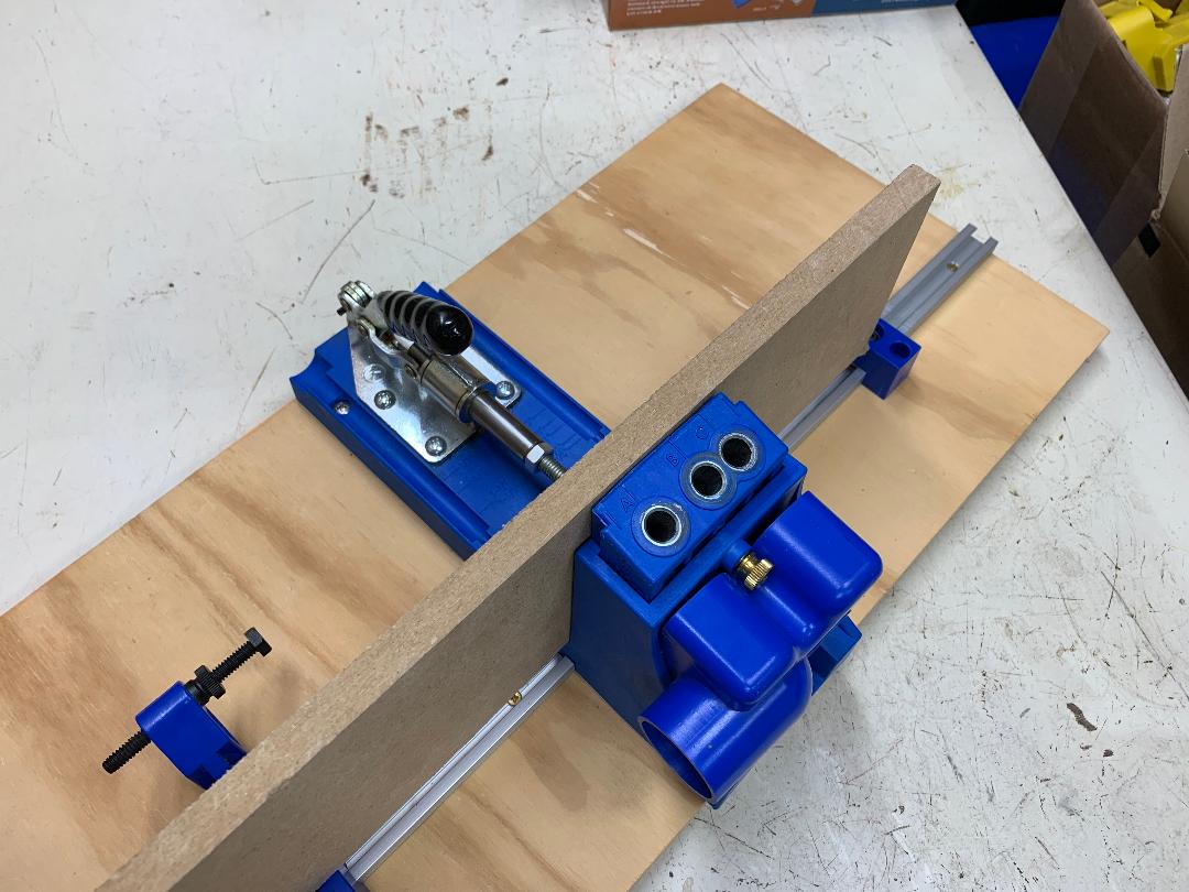

Clamping is one thing that you have to get right to get the system to work for you. There is first the clamping of the jig to drill the holes. I the jig I have been showing here there is a clamp arm that you engage to hold the material against the drilling portion of the jig.
You can not hold these jigs in place with your hands, you have to clamp them to the work piece or all bets are off. You can clamp the material vertically or horizontally as shown here:
There are other clamping methods used with some of the other kreg jigs so what ever one came with your jig is the one that will most likely be the one to use.
You can often batch drilled a bunch of parts before assembly, some of these might require different settings resulting in different length screws. If this is the case they it is a good idea to use some way of marking the different lengths needed as sometime just pocket hole placement is not enough of a cue.

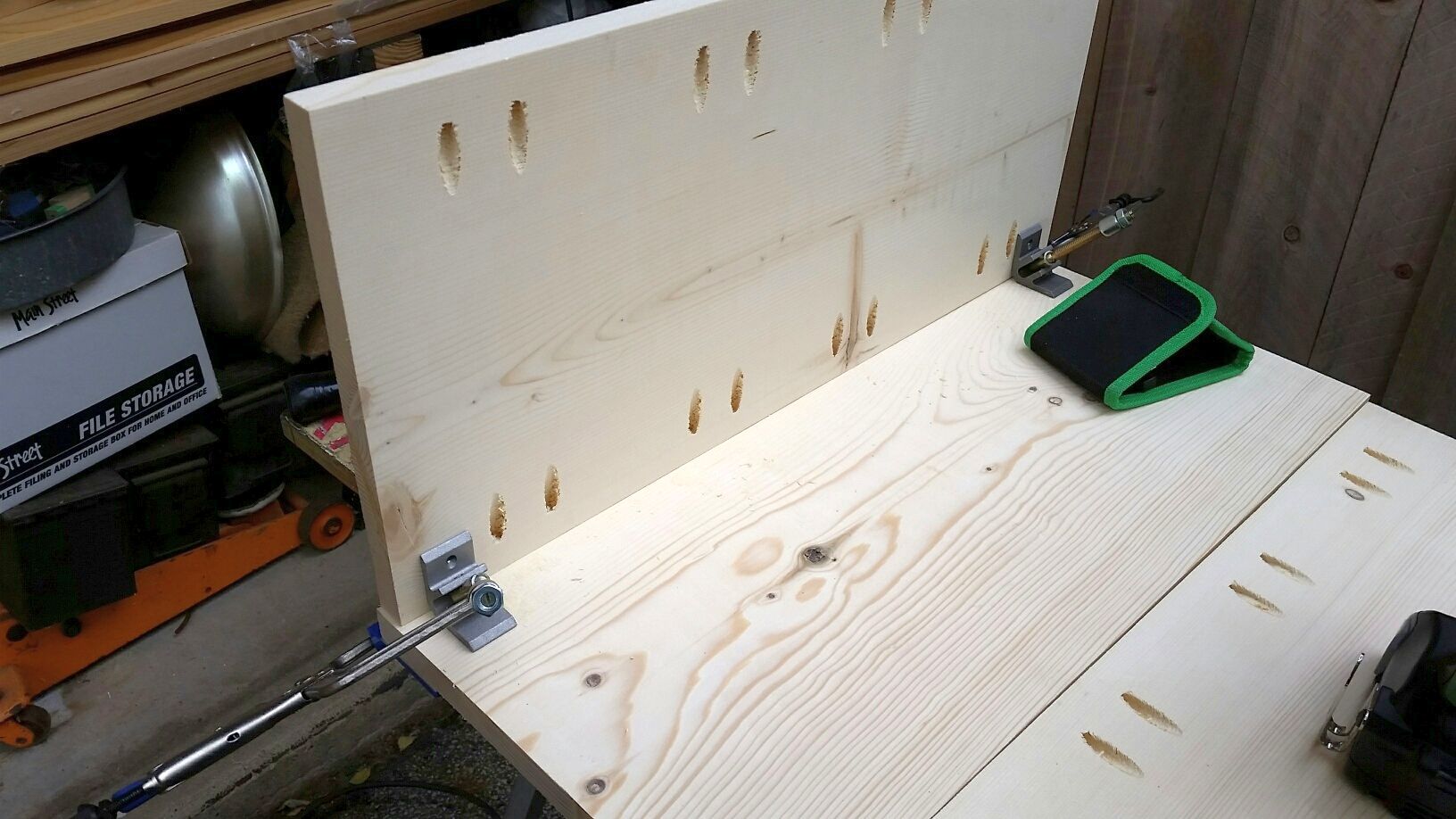

Sticking with the face joint we have been looking at then the one the most basic ways to clamp the stock (to drive the screw in) is done as shown here:
The front surface is located at the bottom and should be held flat by the clamp.
The clamp can be just between the parts or clamped to a flat surface. This type of clamp is called a "face clamp". They come in several lengths of engagement and most of the clamping systems provide at least one.
The problem is that if you are not careful the two parts can separate and move and before you know it the joint is not were it was. This is where clamping tables come into their own. By holding the parts not only flat to one another they can keep the parts from moving in any direction. I have a simple sheet of plywood that I attached some oak pieces to at a right angle that helps with getting the two parts right on for those sorts of joints. I also have the Rocker clamping table with many clamping options. If you are hoping to get good joints you will more then likely need to build a helper jig or buy one.

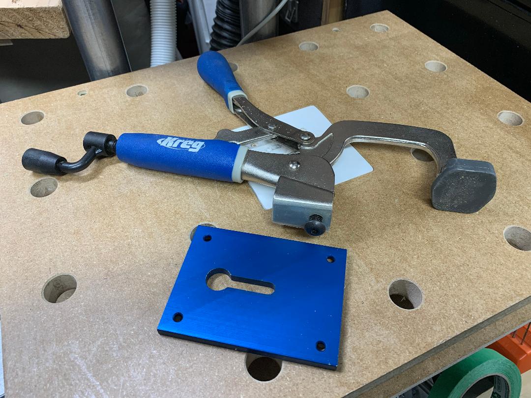

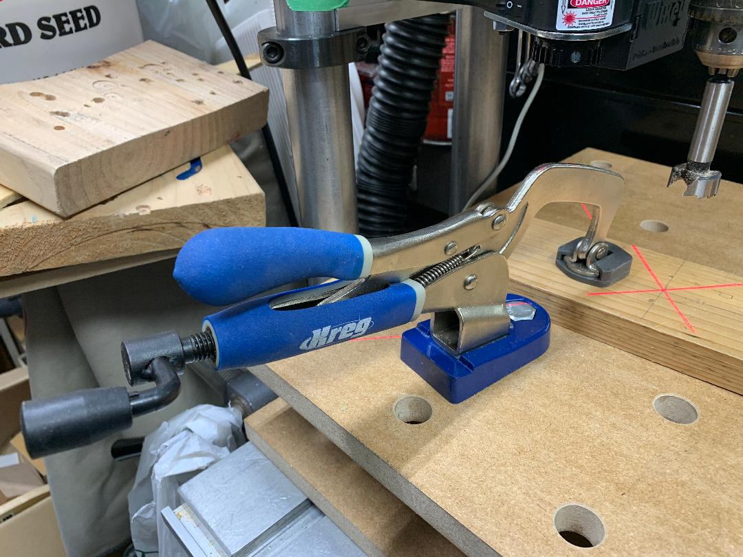

We have been discussion these flat joints and there are several other jigs they make for doing this. One of them is referred to as a bench clamp. This clamp is handy for much more then the clamping needed for these joints. Here is the clamp and the mount. The mount works in 20mm holes like on this drill press table and also 3/4" holes.
Here it is in action:
You can also get a plate to install in a work bench top, I have one on the kreg clamp board I made BTW.
Some of these clamps are worth while even if you don't go into pocket holes.

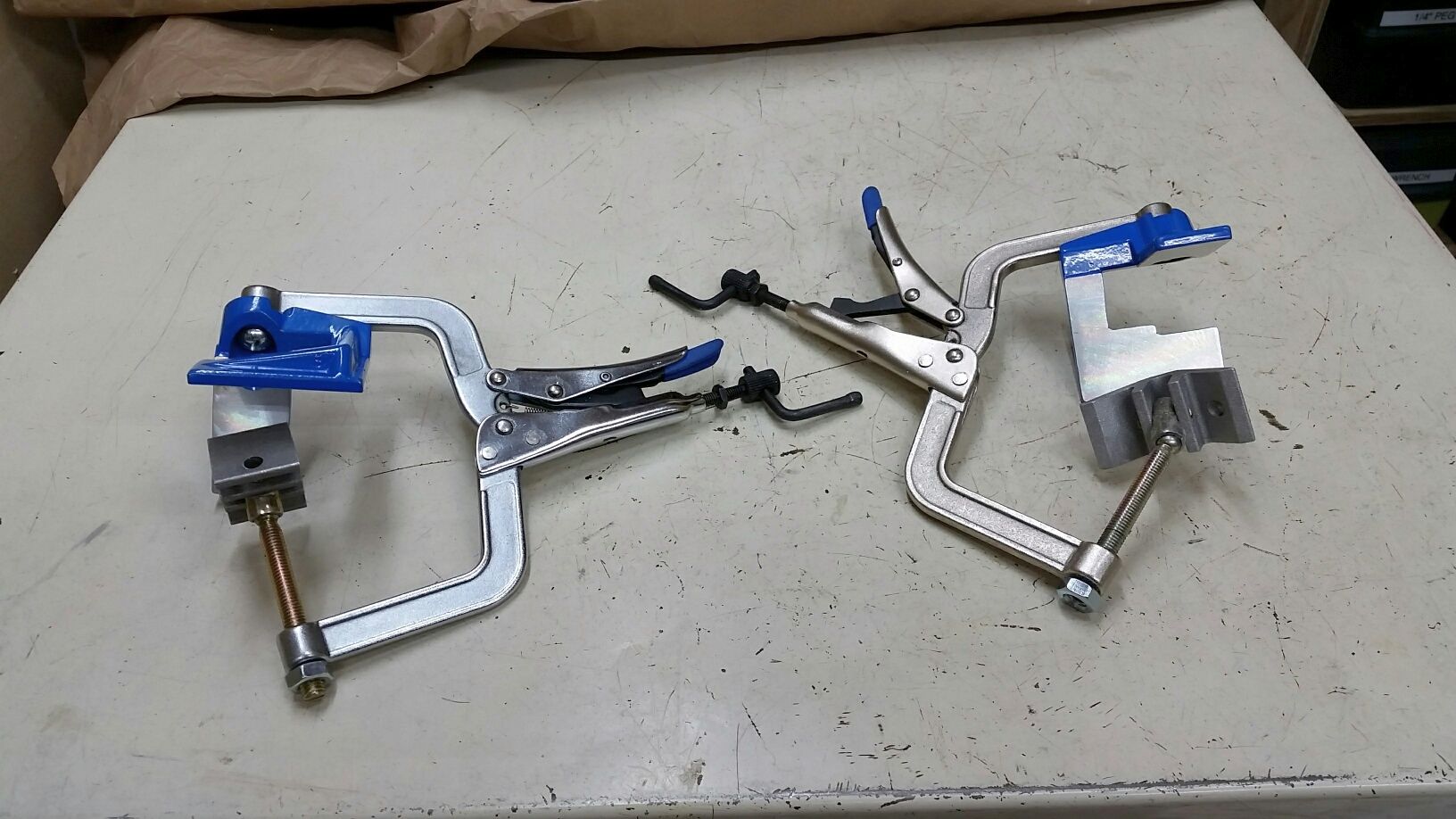

We haven't gotten into some of the other joints but to give you an idea of some of the clamps I have take a look at this collection:
We will look at a few more of them later on.

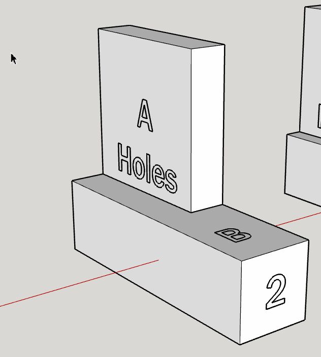

Re: Is there more interest in Kreg pocket hole stuff?
In this sort of joint it should be pretty obvious that the pockets have to go in the part labeled A. The same width rules apply to these joints, refer to previous posts for that information.

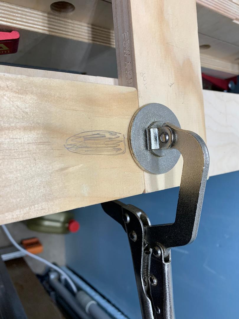

While the joint is pretty clearly different it is also very different to clamp. While you might get by just clamping the one part I can tell you that it unlikely you will be happy with the results. Both pieces need to be held where you want them so when the screw goes in there is no movement of either piece.
Back in 2017 I needed to build another squirrel house. I used pocket screw and you can see one of the set of clamps I used to hold the parts in place. They are called 90 degree corner clamps:
Here they are in use:
The one of the other clamps I pictured works a bit differently and I have not found a picture of mine showing them in use so I will send you to amazon to see how they work:
https://www.amazon.com/KHCRA-Automaxx-R ... 548&sr=8-2
There are no doubt other clamping solutions from many competitors so if this has peaked your interest you might want to see what else is out there.

General thoughts are that pocket holes are used in material between 1/2" and 1-1/2". The jigs and clamps are functional in this range. Could you go to larger materials well yes and no. If you know what you are doing then have at it, if you don't then either learn or stick with the recommendations. I will later show a few things that are possible but again you should make sure you know what your are doing before trying them.
Looking first at face joint, you can combine any of the 1/2" to 1-1/2" A parts to any of the 1/2" to 1-1/2" B parts. You will need to shim parts so that you can clamp them flat for assembly but that is about it. In general again, the B part is expected to be at least 1-1/2" wide and anything wider is fine.
When you start mix and matching the edge joints you will have restrictions as to how you can do these. If the B part gets too thin then the screw will likely go though it. As an example if the A part is 1-1/2" then The B part can not be 1/2" - 3/4", you need a minimum of 7/8". This information is in tables and on the screw selector wheel.
Here is an example where things get a bit confusing for a table to explain so that thing called common sense comes into play. In this next example lets think of this being an apron being attached to a upright. In the first image the pocket holes are on the side labeled. There is no chance of the screw come though the B part so one could even use a longer screw, you do see that right?
Now if for some reason, say appearance the pockets will not work as shown. Then possibly we would want to put the pockets on the other side. In this case it is still possible to do but if you go to far with the screw it coming out the side of B on the far side.
It is also possible that you want the A part some where in the middle of the B piece so in that case you are safe on having the pockets on either side or even both if it a utilitarian piece. And yes one could use longer screws.

I am learning, never knew the existence of the 90 degree corner clamps.
Ordering a set!

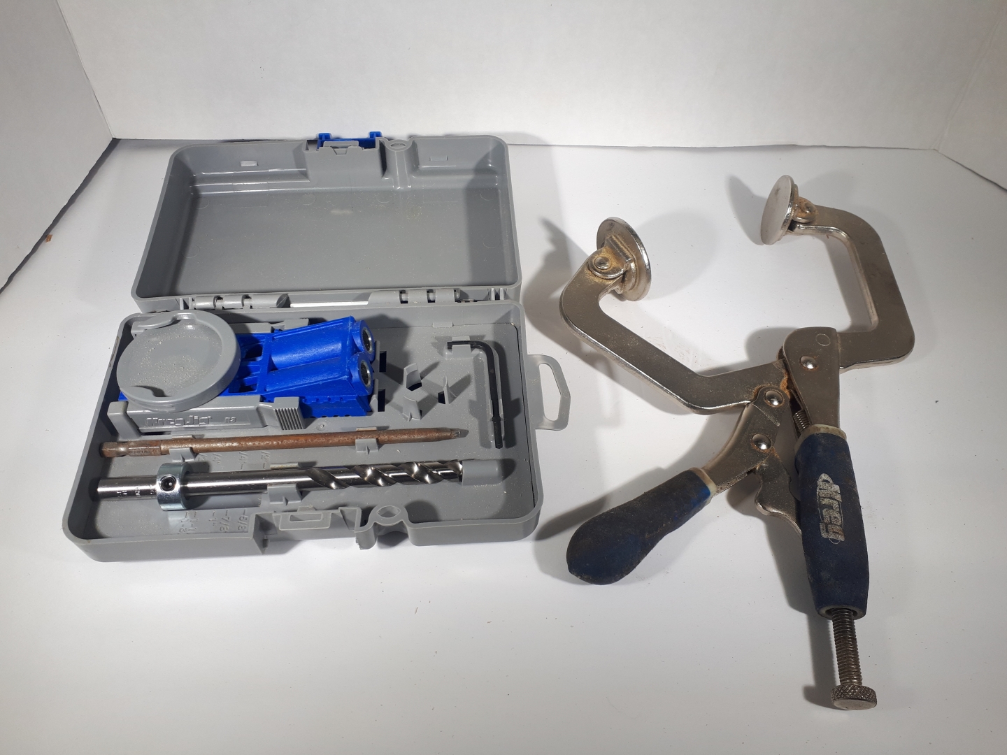

My tool budget is smaller than some, so this is my Kreg jig, an R3 plus a face clamp

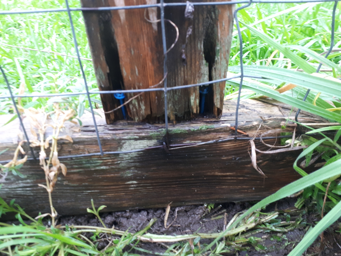

And a cautionary tale re screw placement.

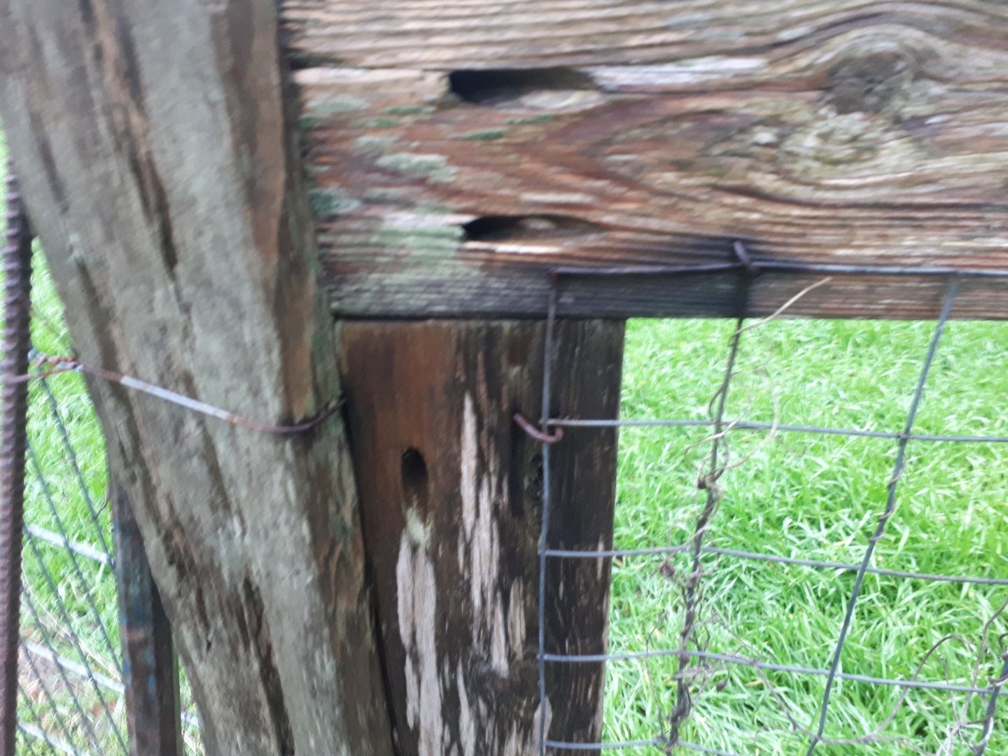

This is a quick and dirty section of fence that I made with pocket screws some years ago to fence in part of the yard for a dog run.
It is all still holding up well where the screws go sideways or up ... :cool:
but the bottom of the center brace, where the screws go down, has rotted through at the screw holes. :eek:
In hind sight, I should have bucked the rules and drilled that one from the bottom up into the end grain, so the water couldn't pool in the pocket holes. :o

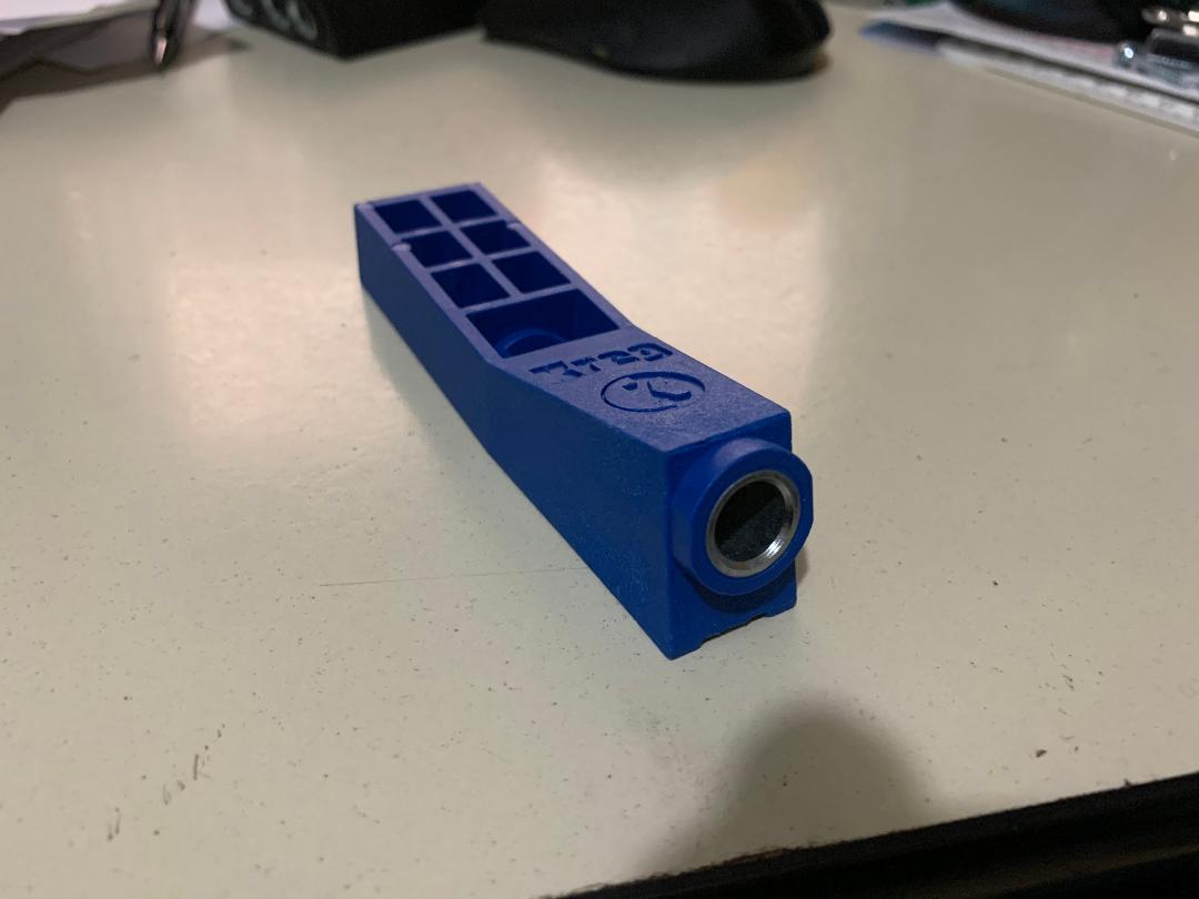

When space is at a premium and you want to use pocket screws then it time to look at the kreg micro jig. The pocket hole is about 25% smaller. Because of this you also need to use only the pan head screws.
I have not introduced the nomenclature kreg uses for these but just for being able to say you have heard of it we will take a short detour here. I don't expect you to remember it, I know I certainly don't.....
Say I have box of screws I can pretty much look at them and determine what I have. But if you happen to have to order some or send someone out to buy a box then I guess it is handy to have a label.
As an example if I have a box labeled SPS-F1-100 then the SPS is the head type, or in this case we know it is a pan head. Had it been SML we would have know it was the maxi-loc. The F tells us that it is fine threaded, had it been a C it would tell us that it was a course thread. The 1 is the length followed by the 100 that says how many were in the box.
You can look all this stuff up if and when you need it now that you know that is a thing.
Back to the micro jig, how they get the reduction of the pocket hole is to have a smaller bit which of course needs a smaller guide. The HD version used a 1/2" bit, the standard version is a 3/8" bit and the micro is a 5/16" bit. The pocket hole spacing is the same as the standard version with the same 3 holes jig. With the reduced pocket hole size you can work on stock down to just 1" wide. It is also use for mitered corners.
The jig and bit look pretty much like the other version:
The black color I guess is to help you know just which jig you have???

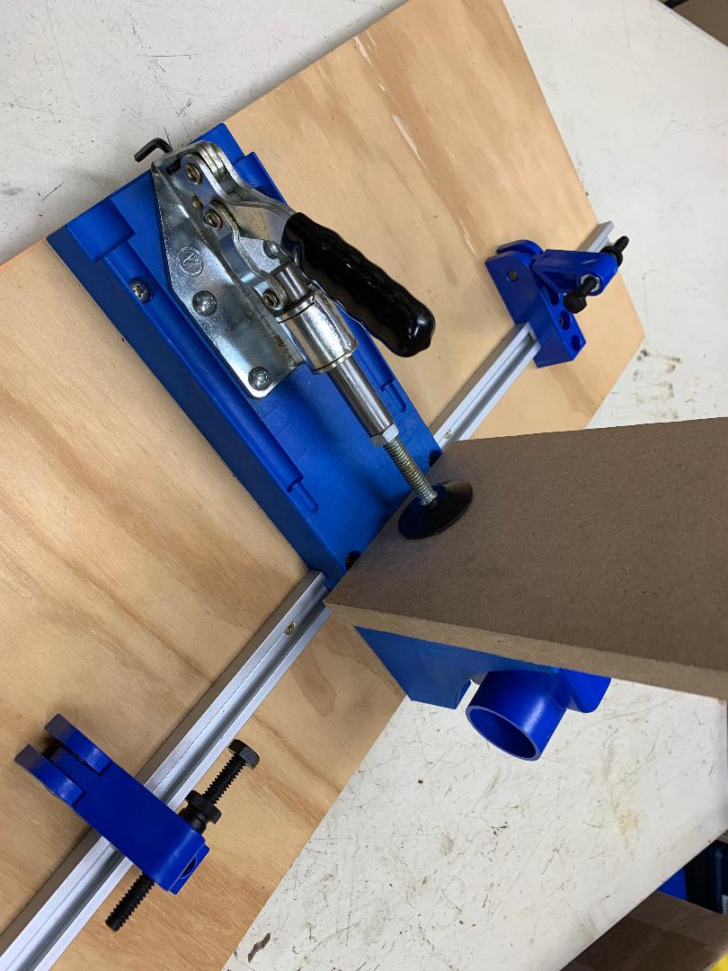

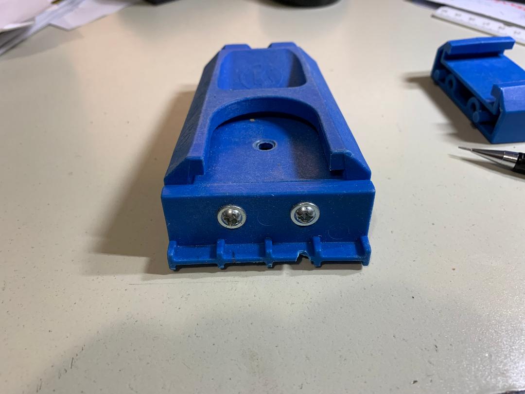

What the other jigs provided was a pretty clear cut way to work on any size stock be it inches or feet long. There are just going to be times when the L shaped jig is just not going to cut it.
This is where the Portable base comes into play. It is not much to look at:
Like the L jigs you set the material thickness then you can clamp the jig to the work piece and drill away.
The L jig and this portable jig will take the standard, HD and the micro drill guides.
